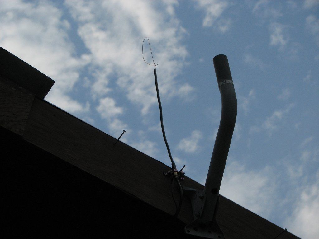

My neighbor pointed out an old wire on the side of the house I never noticed before, probably an old satellite from a long time ago I guess.
So I took a wire and cut one end off and stripped it bare then made a loop.
I put that on the connector up there. I had to climb a ladder. I don't like that. :(

Anyway, I thought I would put a picture of my little home made antenna just so you guys can have a good snicker at it. I'm sort of proud of it but it really is sooooo white trash looking. I do need to get a real one.
So for your entertainment, I present, my home made antenna. :D

Nice ghetto antenna ;) But if it works thats all that matters

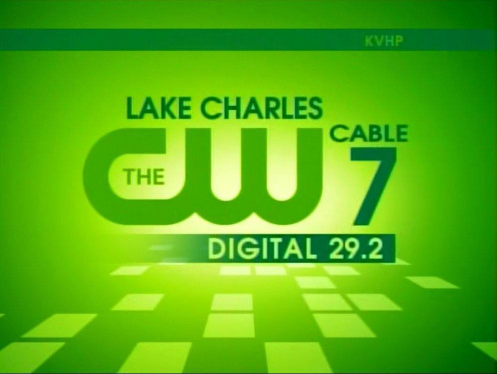

Well, right now on KVHP-HD is a gawd awful football game. :mad:
And on KVHP-SD there is a logo that says "The CW" and Married with Children is playing.
Maybe someone will know how to look up the tv listings in Lake Charles. :confused:

See what you can get on a nothing antenna?
Imagine what you could get on a real one! - :D

Oh they are saying that the KVHP-SD channel is "FOX 29"
Oh here we go, I just caught their ID thingie between shows.

I made and used one of these for 2-3 months before I got my CM 4228, it worked really well.....and was FREE! :)
[ame="http://www.youtube.com/watch?v=EWQhlmJTMzw"]YouTube - Coat Hanger HDTV Antenna![/ame]
Most of my locals were either hi-VHF and UHF so that helped, I don't think these do very well on the lo-VHF channels.
