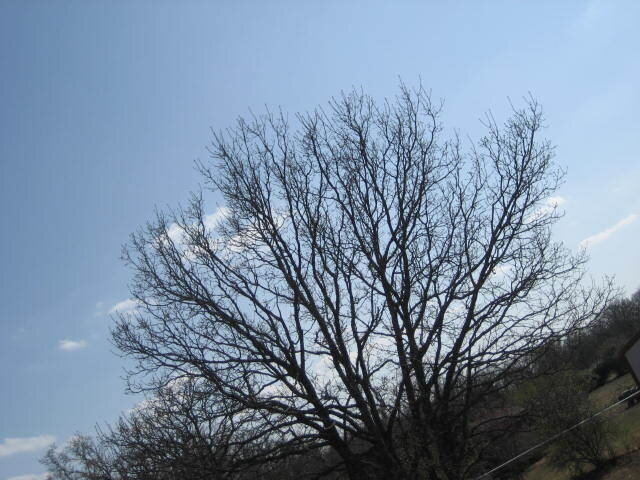

It appears that the dish is pretty secure though. It doesn't move up, down, or sideways. The only thing I can think, is that the installer pointed the dish right at this large tree. If I try to follow the path with my eyes, it looks like it goes right between 2 large branches, in kind of a "V" formation. The day that he installed it, there was no wind at all. Now today, it's windy as heck and those 2 branches are probably crossing the path of the signal making it impossible to lock on.

This is really just speculation though. The branches are about 60-70 feet away from the dish and just as high off the ground, but it looks like that's the path the signal takes.
The signal comes 22 degrees higher than where the dish is pointing at. Any chance you can take a picture with the camera in front of the dish? Just to see if the branches are blocking the signal.
Interesting...
I will have to try that. So basically just hold the camera directly in front of the LNB's? Then try to determine 22 degrees of slope?
Thanks!
This pic is with the camera rested flat against back of the arm (right against the DP Plus logo) with the LNB's.
I'm not really sure if this tells me anything though...or does it?

judging from that skew amount (you held the camera "level" with the LNB too, right?) you got's a tree in the way.
When I got Dish, the first year I got tons of signal outtages. The following year and now, I don't get the outtages except station outtage.
Being in OK your elevation is probably pretty high for the satellites. My 61.5 Dish looks like it points strait at a wall. That tree at 70 feet is probably not an issue at all.
The signal bounces off the dish like a mirror. It comes in from above, and is reflected down to the LNBs. It is much higher up than you think looking at the dish.
I would still be on the dish not being secure in high winds. The alignment may not be close enough and the slight wind motion knocks it out.
Pepper: Yes, the camera was level with the LNB. I really think it's the tree. Now that the wind is died down a lot, my signal is trying to come back in. Not sucessfully though.

And I'm tending to agree with the others that the tree may not be coming into play. I could be wrong. I'm not there and you are. If it WAS working and then a week later it's not.... I just ain't buyin the tree theory. If it was the tree it'd go out and come back intermittently in the wind. You seem to be indicating it went out and isn't coming back. Either that dish moved or you have a faulty connection somewhere would be my guess.
Oh... and that tree hasn't got a leaf on it... You could probably come real near shooting through the center of it from your distance and still get signal :) Although you'd go out when teh leaves came in.
