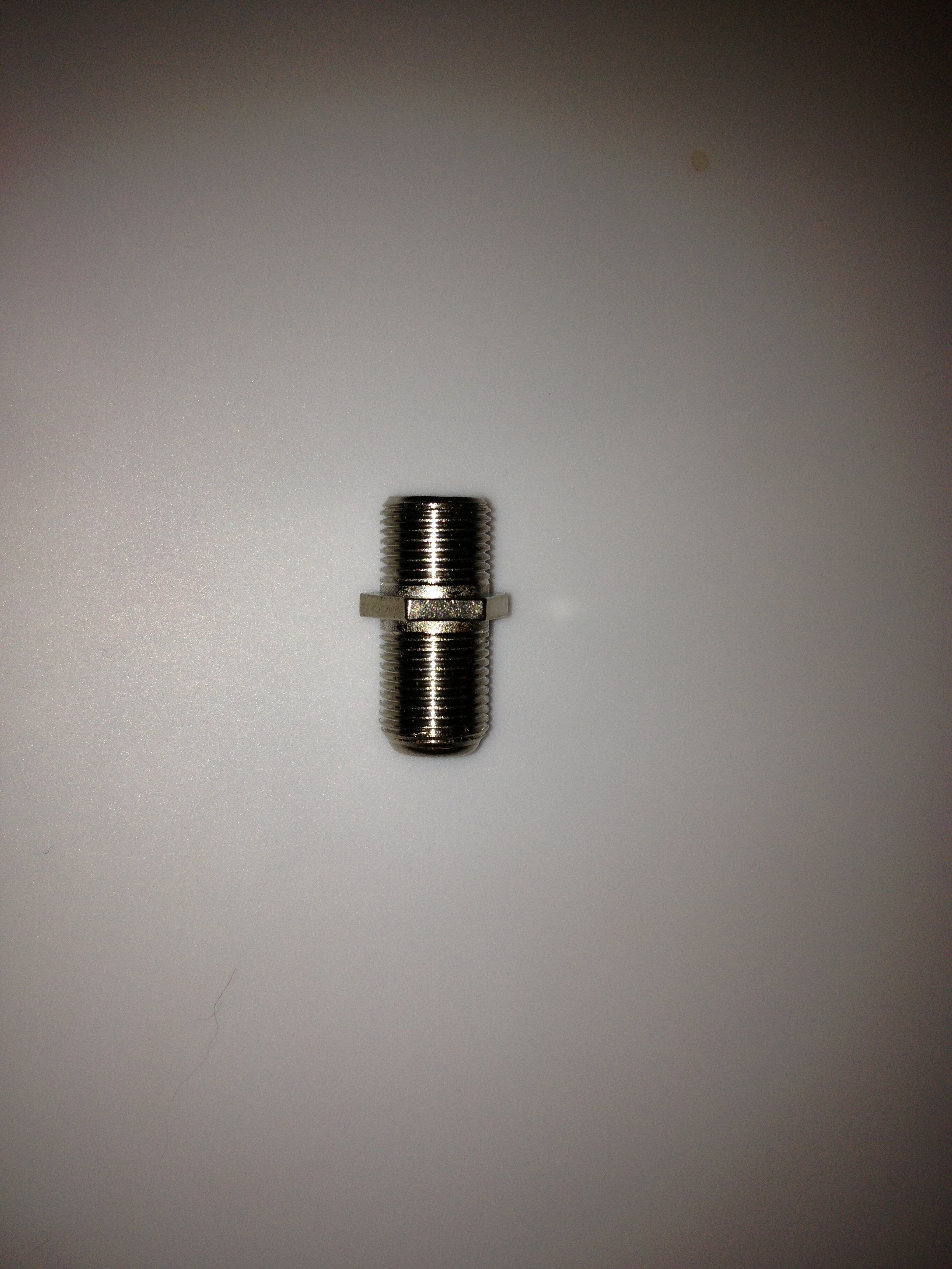

Anything that is inline should be considered suspect. If the problem repeats, place barrels in place of a diplexer.
Personally, I never use diplexers as the signal attenuation is unacceptable on either band.
What are barrels, are they other type of switches?, not familiar with that type of component name. Are barrels used with OTA antennas.
I do have a few of those, but can not see how this component is going to work in combining the signals from the satellite cable with the OTA cable and do what the diplexer does, am I missing something in here, is there a type of barrel that does combine the singnals, won't that be the same as using a regular splitter.

I think what satav was saying is remove all the stuff from the line everything (no diplexer nothing) and see what happens. :)
Also can you get rid of the diplexers and just put in a new home run for your OTA?
Thank You.
It's just to connect two cables together, bypassing your diplexers for now to see if your sat signal works. If it DOES, then you know positively that one or more of your diplexers are bad. Then you can decide what to do from there.
yes or it could even be bad coax or coax ends . placing barrels will help narrow down the problem area. If placing barrels doesn't resolve the problem you can move to the coax or coax ends.
