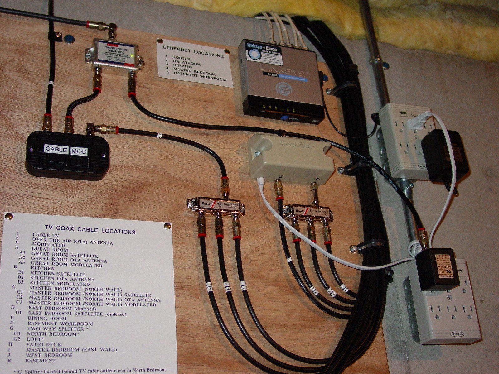

JEFFinINDY, when I have lost signal in th past and used the guide method to navigate to the OTA channels, sometimes it worked and sometimes it didn't. I think it depends if the DVR is getting ready or is doing a self check switch procedure. I am not sure why, but I don't want that to happen again. I now have my OTA split going to the TV and DVR OTA in ports with an A/B switch at the main TV . This way if signal loss happens and going to the guide does not work for OTA, I just punch the A/B switch and bring in the OTA antenna signal to the TV. If that fails I punch another A/B switch at my head in area and distribute very basic cable TV service to all TVs. I try not to ever loose TV signal, keeps the wife happy.
