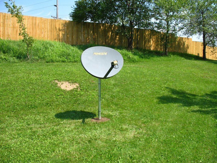

z4ccamaro
This dish is set low less that 5 deg.It's aimed at G10R and I have to keep my next door neighbours grass cut fot it to work.lol!!

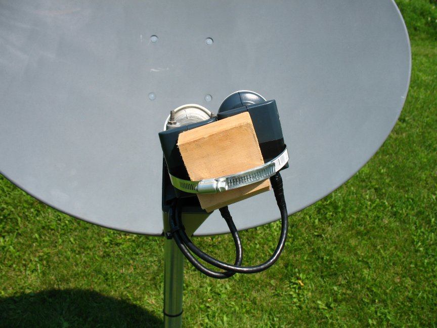

I have 1 more lnb..so, I was thinking of adding it to the other side of IA5 for IA6. 4 degrees, just like AMC 4. So, in theroy, I should be able to place it next to ia5. I had to use a piece of scrap wood to put behind the 2 lnbs, as the hose clamp needed some "meat" to dig into :-) I alos added a zip to to the "neck" area. I will take pics tomorrow, and see if anyone has a better way to do this.

Well, I have given up on attaching a 3rd lnb to my Primestar IA5 setup. I tried for IA6, but no luck. I did not try hard, as I need to mow the lawn, get groceries and go to the furniture store. So, I ddi set up my extra Primestar dish, threw an lnb and am aiming it. My meter is reading a solid signal about everywhere that I point it, so I am packing it up for today. I have it on the patio, so there might be a lot of stuff interfereing. I wil finish up my AMC4 lnb by grounding the dish, burying the cable and taking a pic to post so that I can get some ideas on the strapping on the lnbs.

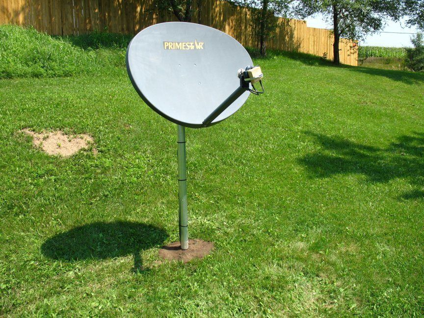

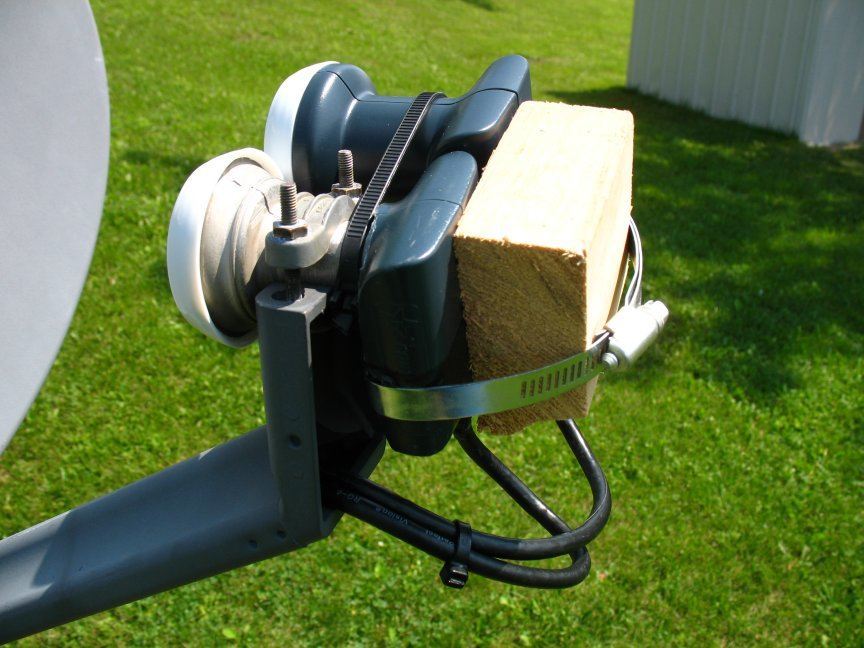

Well, I have finally finished my dish projects. I stillneed to ground the Fortec dish, but otherwise all is done. Here is what I did this past weekend. I added a 2nd lnb to my Primestar. I added AMC-4. It took - 10 seconds! No lie! I tried for 93w also, but no luck. So here is the final pics!

I forgot to add - if anyone has any ideas on how to better attach the lnbs, PLEASE let me know! I do not like the way the scrap wood looks :-) THANKS!
Thanks for the kind words! I am only duplicate your advice :-) Anyway, the hose clamp that is on their is a 4" hose clamp. It is fastened down all the way it will go - this one didn't seem to have much romm to clamp down. but, anyway, the clamp was making the lnbs shift, so by putting the wood in their it filled the gap. I will look for a different hose clamp, as I would rather not have the wood :-) Thanks again :-)
