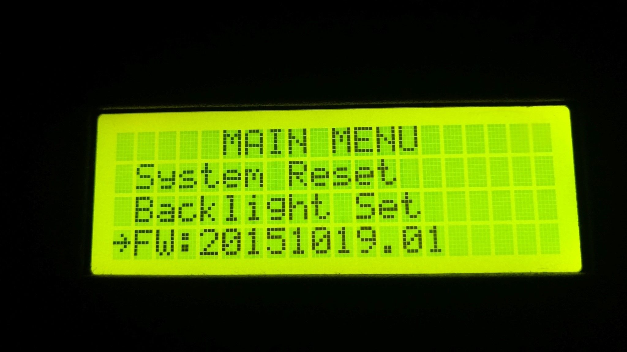

Hi,
Can anyone please tell me how to find out which firmware version is loaded onto my ASC-1?
Thx
From the Main Menu, scroll all the way to the bottom and it will have it read out on the display.

OK, got it sorted, many thanks for your help, the unit is running firmware version 20140903.01.
I can see where I was going wrong, the unit only keeps the main menu up for a short period of time after booting up and the remote control needs to be used to bring back up the main menu. I was trying button presses on the front of the unit to get back to the main menu.
Press the "-" minus key on the front panel a few times and you will see return to main menu. Hit OK and then you are back to the main menu and no remote needed. :)
