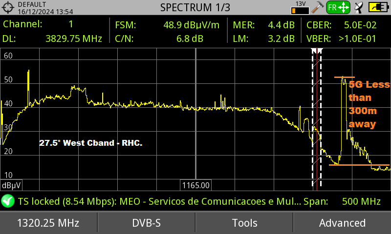

Reporting as a Hobbyist from the UK where 5G cells are popping up almost everywhere - my nearest 5G cell is about 285 yds away with one of it's Tx/Rx bays pointing straight towards me. Untill recently on my 2.2mtr PF Cband antenna, to combat destructive 5G interference i was using a Norsat 3200F-BPF-8 lnb backed on to an ALGA RED external filter to obtain reasonably good protection from the very close 5G cell tower 285yds away..... but alas, also a very expensive solution.
We have, at the moment in my area, two 5G frequencys in use, 3.761GHz to 3.795GHz and 3.407GHz to 3.459GHz - the most troublesome one is the one stopping at 3.795GHz at around 285 yds away from my Cband install.
In the last few months i decided to remove the very expensive Norsat / ALGA RED system and try the stand alone Titanium 5G C138 lnbf as a performance / value for money comparison test ..... - Long story short, i was very pleasantly surprised & pleased with the 5G C138 overall performance, especially the massive price difference. The screen grab from my Promax analyser is the dish looking at 27.5° West (for me in the UK) showing the Titanium C138 5G lnbf doing an absolute cracking job of locking and displaying the content for frequency 3830 RHC.
