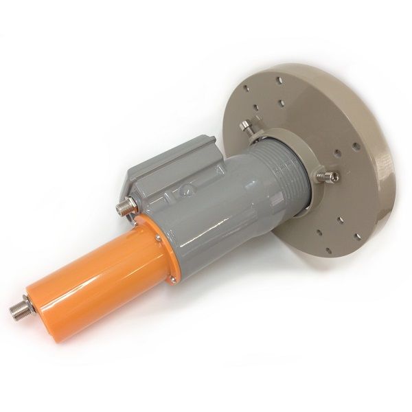

The model is the CK1S DRO
Had noticed that these C/KU combo LNBFs were out of stock from most vendors and the remaining stock on Ebay and Amazon was crazy overpriced (almost larceny)! Had a LCL order (partial container) of product on the way, so had the factory fill up the space. Costs about the same to ship air or product! LOL!!! :D
Didn't develop the unit. Nothing new or revolutionary. Just a quality OEM DRO LNBF that had been sold for several years under a defunct company's brand name. Will be posting up some installation guides and diagrams in the next few weeks.
Why does it have that orange colored area?
Yep, the orange area is where the Ku LNBF is housed. Why is it orange? They must have an overstock of that color of dye over there. :D

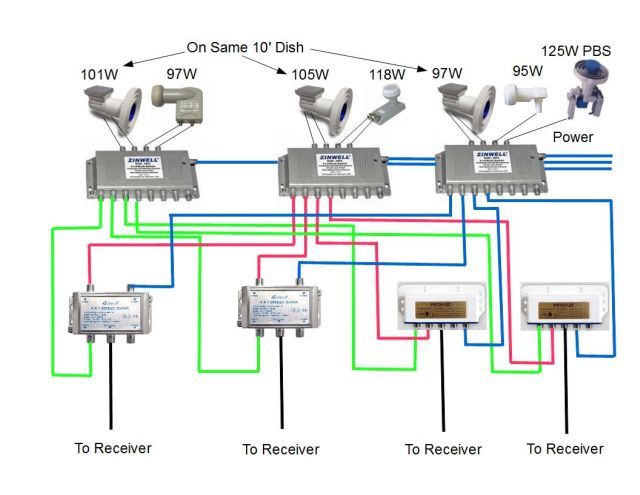

The way I have it set up, using single output lnb(f)s, all receivers can watch all channels on all V TPs on 125W and all H TPs on 95W. Works out good in my case since all the good PBS channels are V on 125W and the English CCTV channels are all H on 95W.
EDIT: OP has an actuator so this setup would be pretty useless for him. Only useful in my case for fixed dishes.
