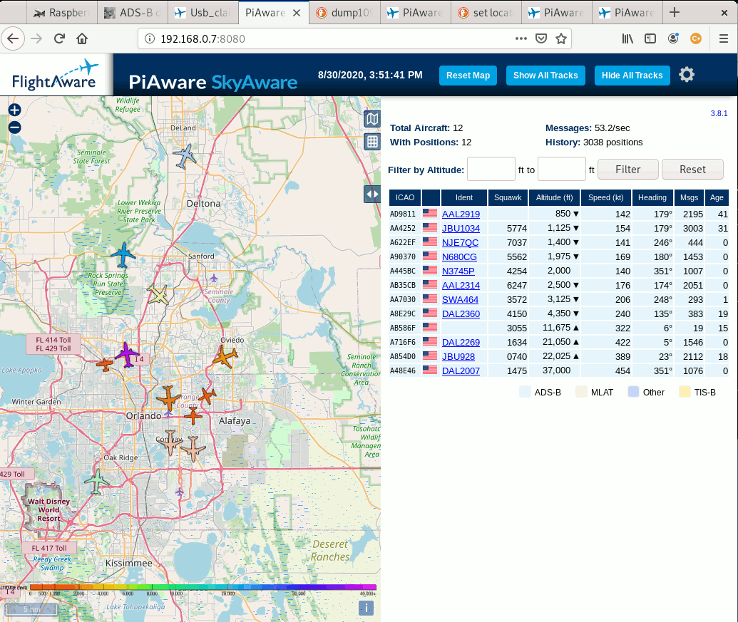

Turns out the software includes a web server that runs on the Raspberry Pi and can be accessed from the desktop by entering the ip for the Raspberry and use the default port of 8080

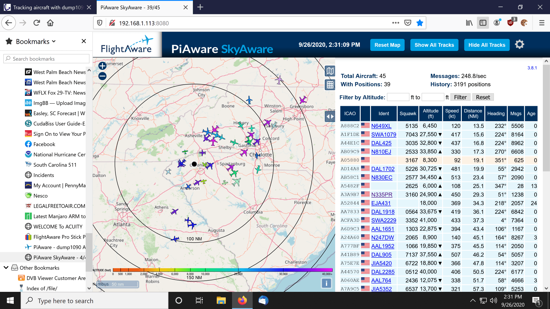

Here are some screen shots.

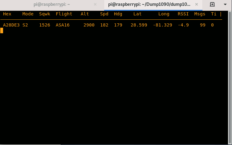

The black term shows an aircraft on short final (2900 feet up) I could hear it too :)

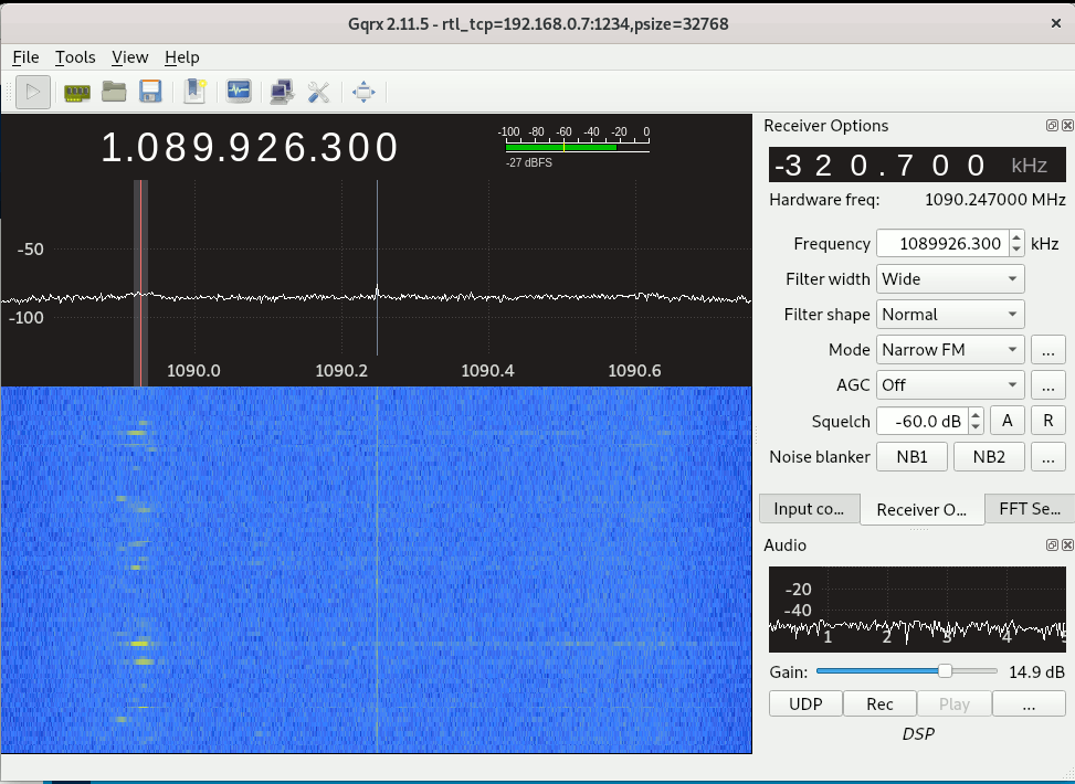

Below is what 1090 MHz looks like on GQRX.

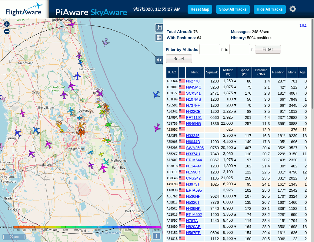

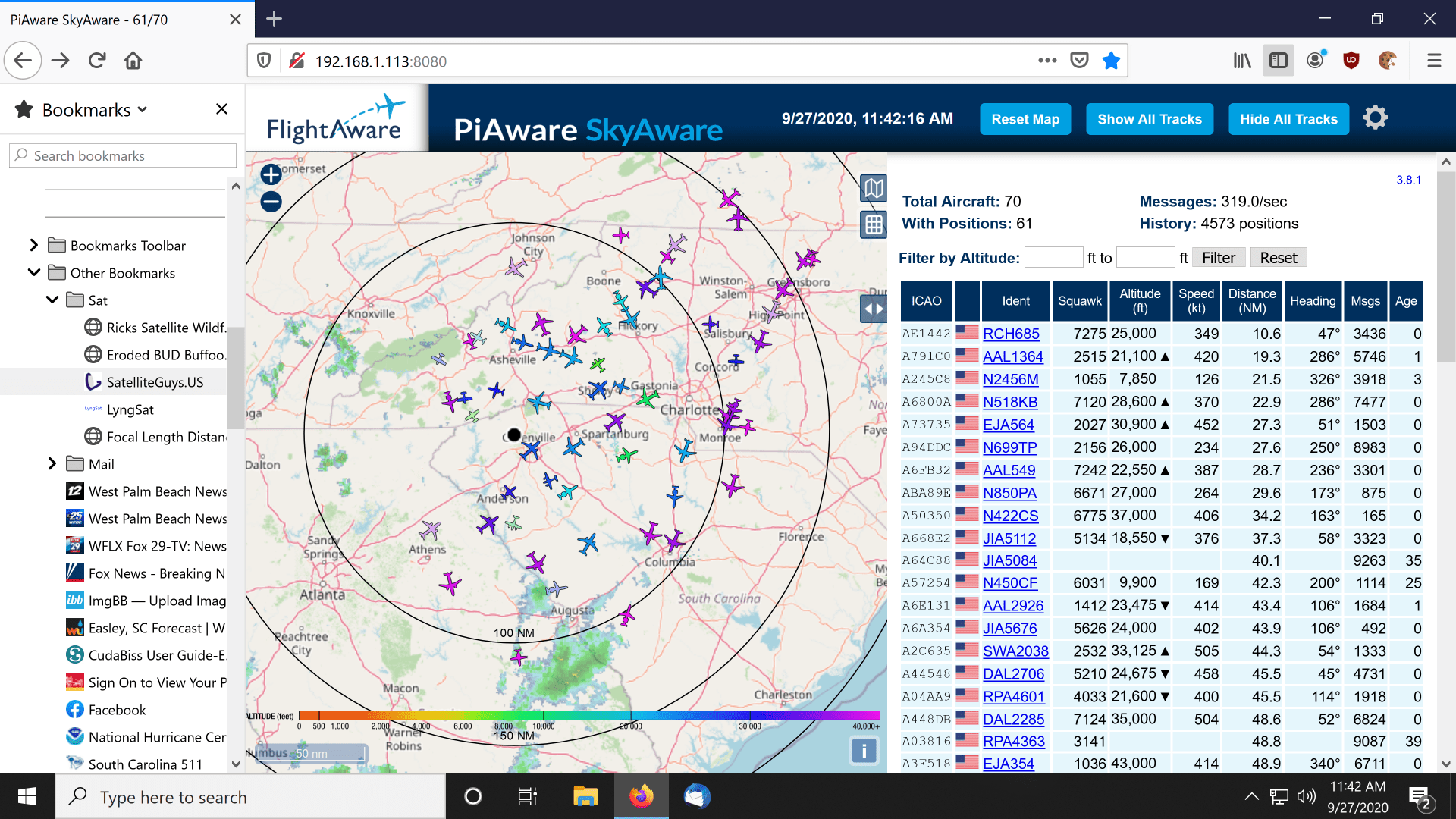

Delta Charlie, How come your PiAware is not showing distance of planes from you? Did you choose not to set location?
It does now, took a while for me to figure out how to set my location. The Flightaware control page has what looks like an edit link but only works if it is clicked on. Does nothing on rollover so I missed it.

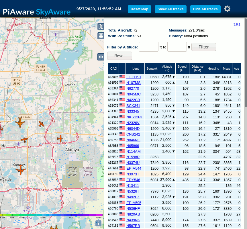

Check out the top one on the close up screenshot. Could hear it indoors :) Not loud as it is running low throttle and noise abatement but still making wind, flaps and landing gear deployment sounds.
