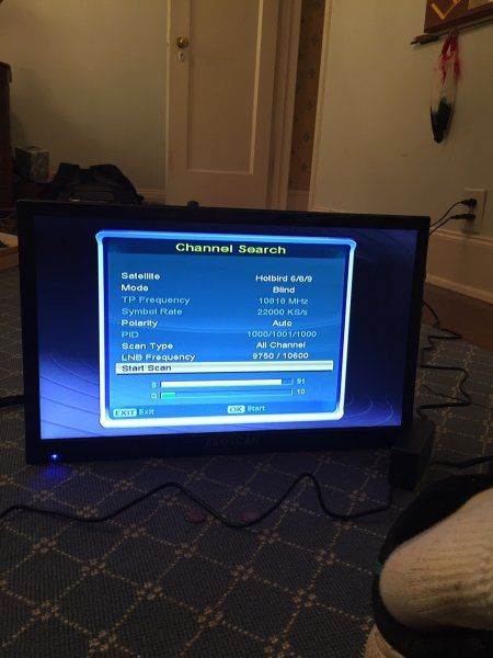

Hmmmm... The blind scan doesn't seem to be doing anything. I tried putting in a random satellite (Hotbird 6/8/9) and tried a blind scan hoping that if I was aimed at Galaxy 19 it would pick up the channels but nothing. I attached a picture of the options for the channel search so I'm not sure what to change.

Hmmmm... The blind scan doesn't seem to be doing anything. I tried putting in a random satellite (Hotbird 6/8/9) and tried a blind scan hoping that if I was aimed at Galaxy 19 it would pick up the channels but nothing. I attached a picture of the options for the channel search so I'm not sure what to change. View attachment 123070
Stratton you mentioned in PM you thought you had a Standard lnb..If thats the case change the LNB Frequency to 10750...You should really take a ride over to my house and I can show you how all this works..Enjoy meeting a local.
