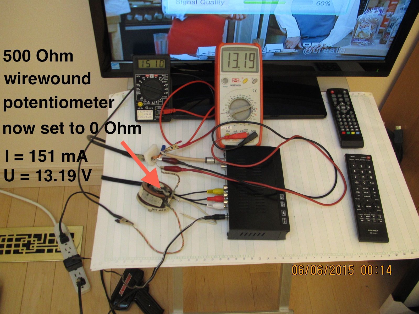

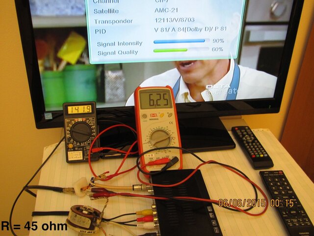

Trying LNBF tolerance for its supply voltage drop
polgyver
Creative Tinkerer
Sep 21, 2010
493
379
Toronto

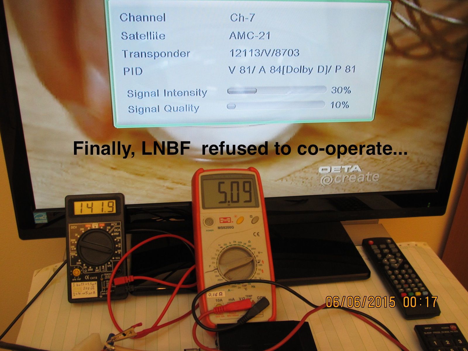

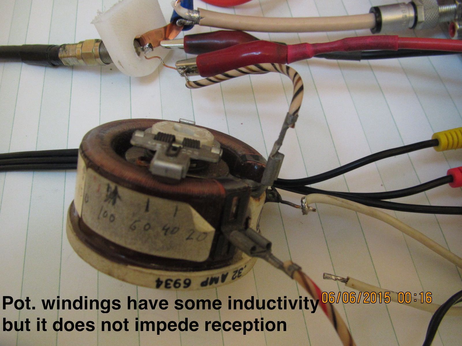

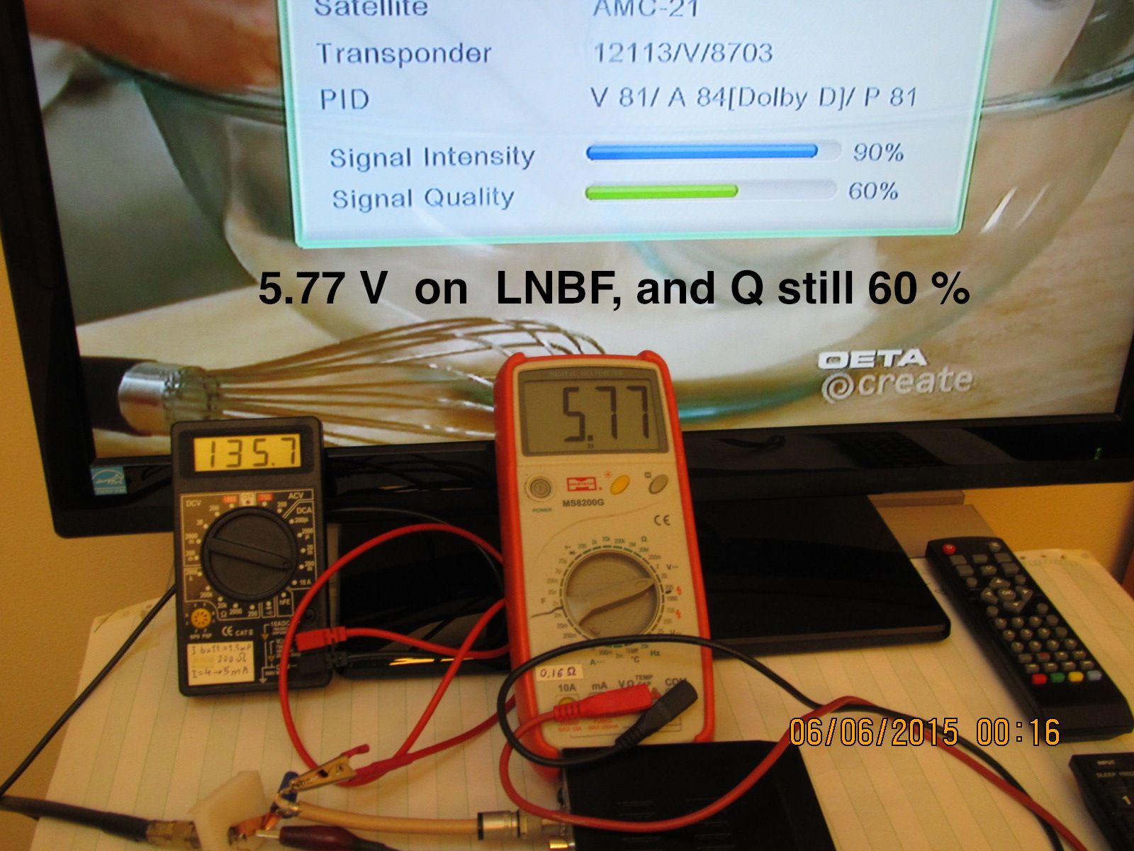

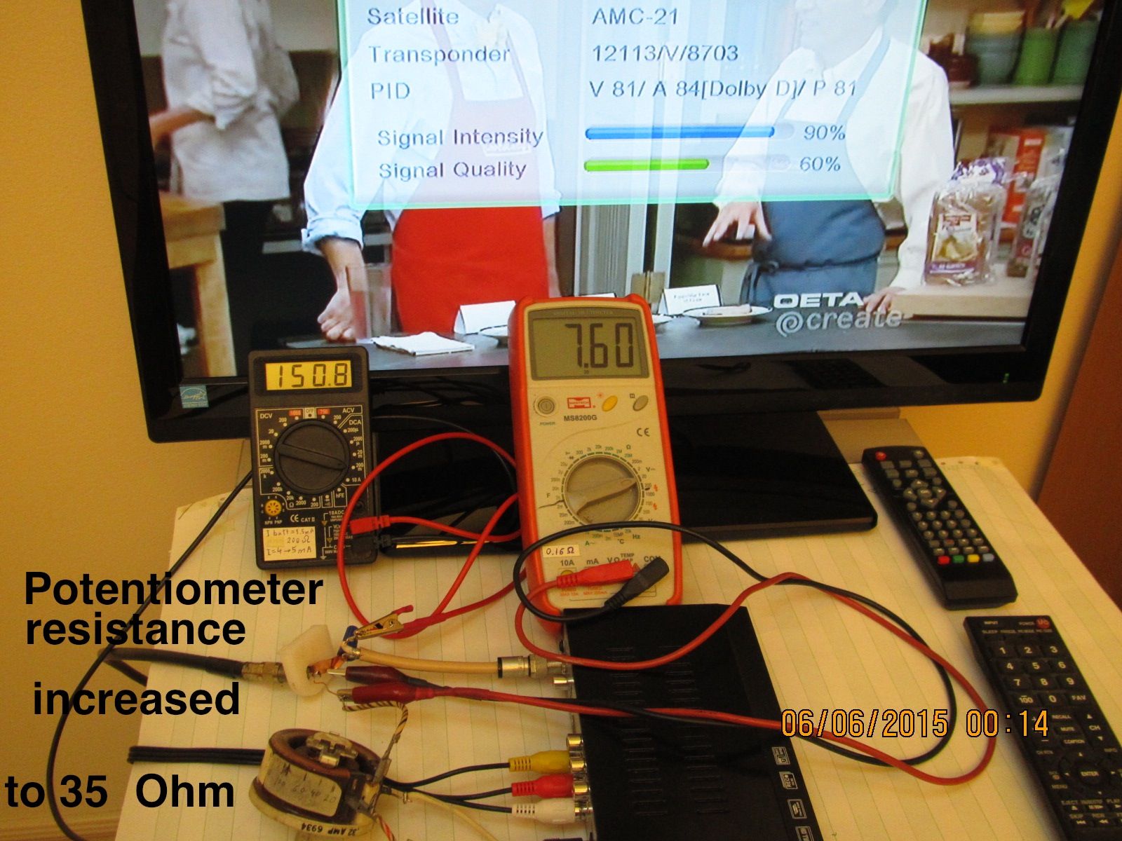

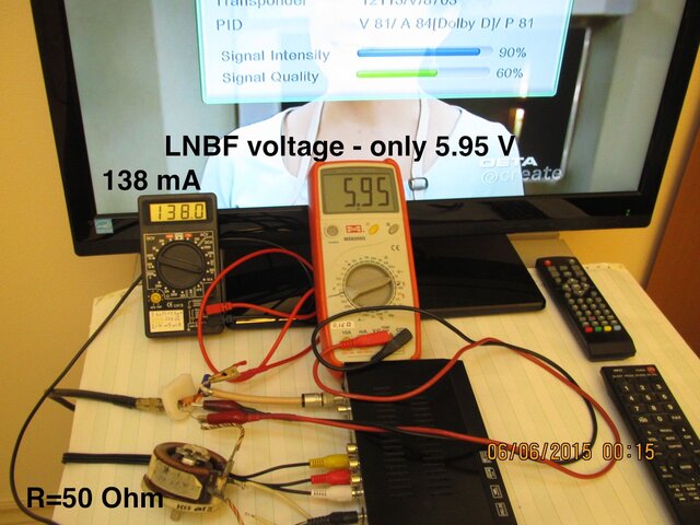

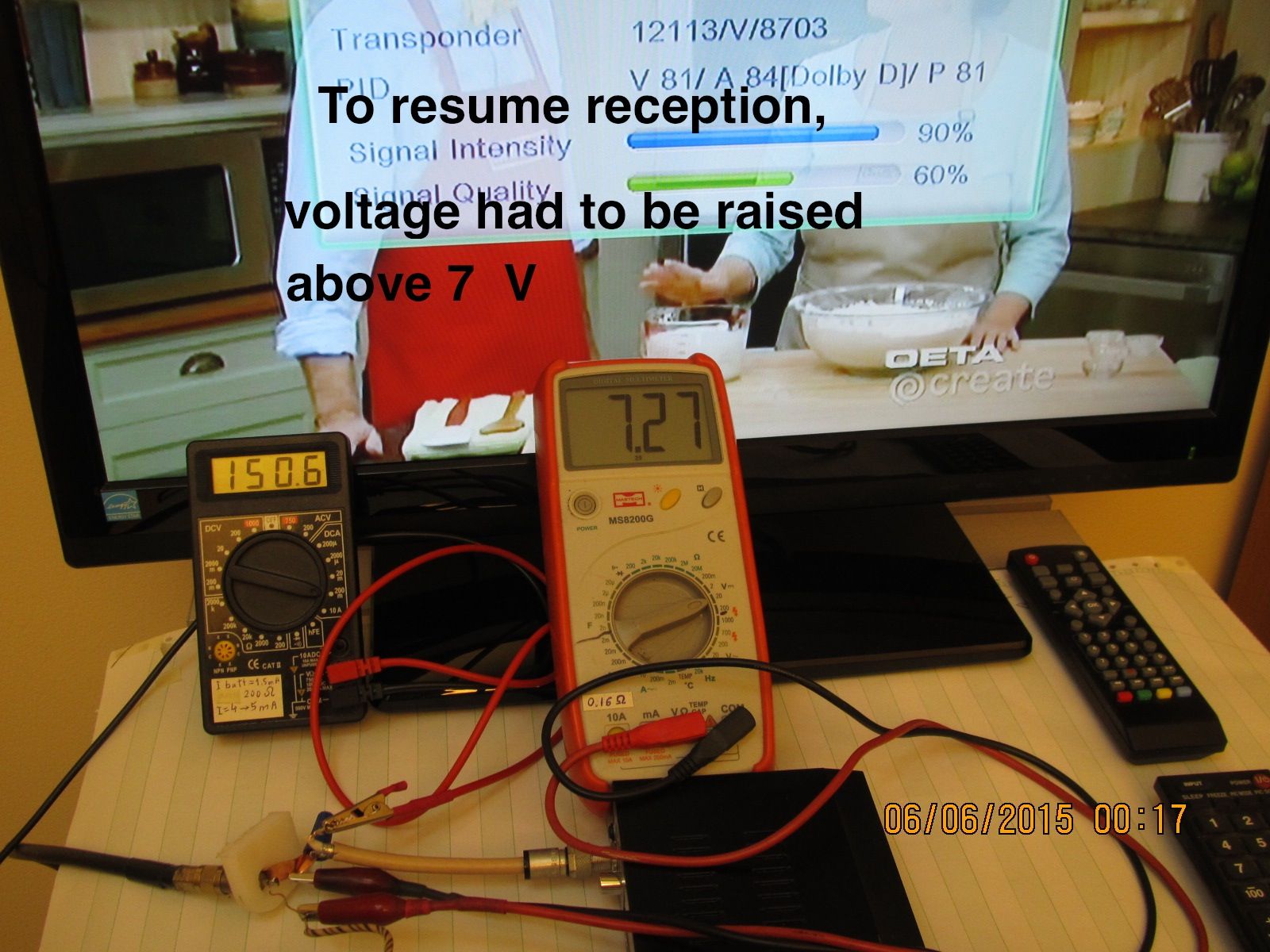

IMG_1308.JPG I tried it only for vertical polarization, where voltage fed to LNBF is about 13 V.
With horizontal, the reception would end probably around 15 Volt.
Overall, LNBF is very tolerant for its supply deficiency...

The LNBF works with vertical at a much lower voltage than I would have thought. What brand/model of LNBF was used here?
I am now curious to know at what voltage it actually switches from H to v.
I always look forward to your experiments. I wish I had the time.
I notice that you are performing your testing with one of the inexpensive Far East receivers and the screen gives the audio with Dolby D displayed. Did you ever get the sound to work?
The LNBF is a cheapo Seesat. When time allows, other brands will be tried for amperage.
All receivers powered with separate 12 V power supply can play Dolby. Other receivers powered directly with cord from 120 AC, do not play Dolby.
