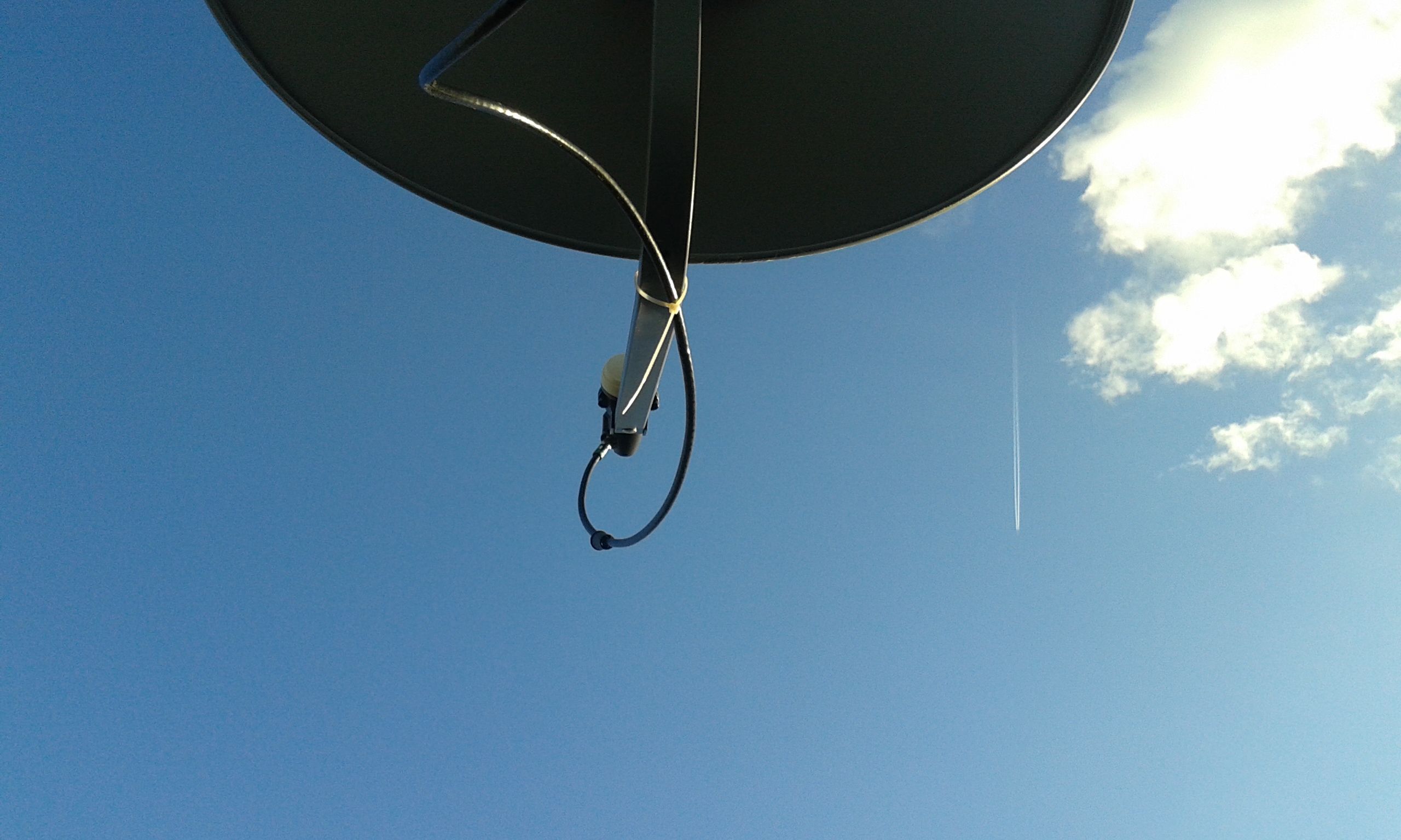

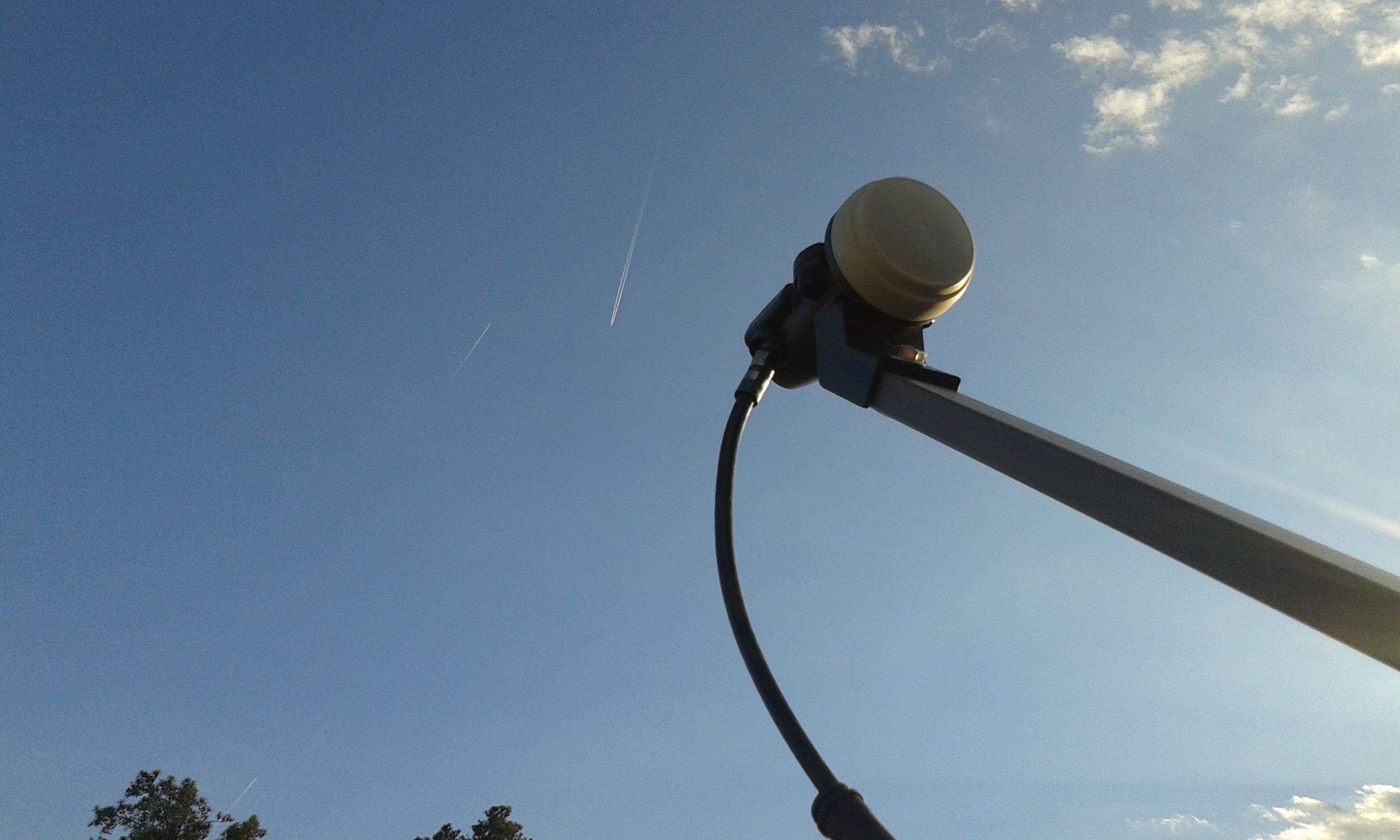

If possible, when the dish is aimed at 97w, stand behind and slightly below the dish and take a few photos of what the dish is aimed at. Wide shot and a shot looking up the underside of the LNBF support arm would be great references for us.
Here are the pibtures.

You may be skewed too much**. If the back of the LNBF were a clock face, 1 hour = 30 degrees. To me, in the pic, it appears almost 45 degrees. Think you need around 26 degrees for 97. (?) That would put the coax connector (or the seam on it) from top to bottom on the back of the LNBF) 'close to 5 o'clock but just slightly towards 6:00 for 97W.
Skew at 87 should be about halfway to 5:00 (5:30)
**that's been a reocuring problem I had/have when re aiming dishes, forgetting to set the skew correctly to the 'new' satellite.
