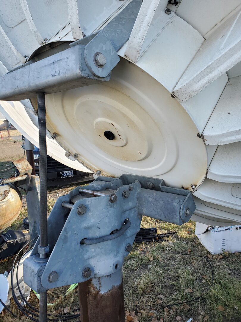

We are trying to get Galaxy 18 @ 123 degrees west for espn on c-band. The only meter we have is an old super buddy 29. Meter was updated to 2.74 field guide. It has no setting for Galaxy 18? We tried getting the dish aligned as best we could using dishpointer.com. Tried using the receiver to get a lock too... HELP. Im fairly new to this and work for a hillybilly company that is super tight on $. We have a 12foot dish just for this bird.

I take it you have a AZ-EL mount and not a polar?

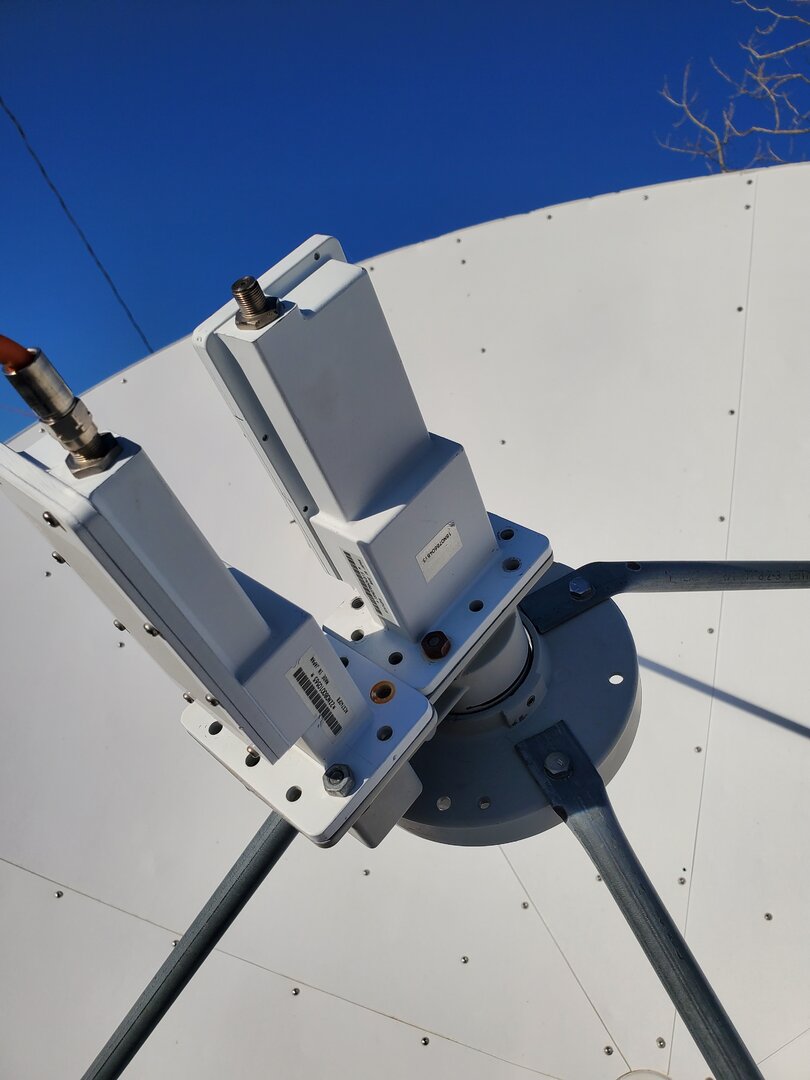

Since only the H LNB is hooked up, vertical is out. The receiver is truly a commercial unit. Info on the 'net points to it's HBO and Max purpose. And from the looks of the dish mount that is what it was receiving and decoding previously. Tight budget or not. It's about time to invest in at least a new receiver, switch, cabling (where's that vertical LNB cable?). That's my offering.

receiver is brand new. dish and LNB old. only had 1 LNB hooked up for alignment purposes.
