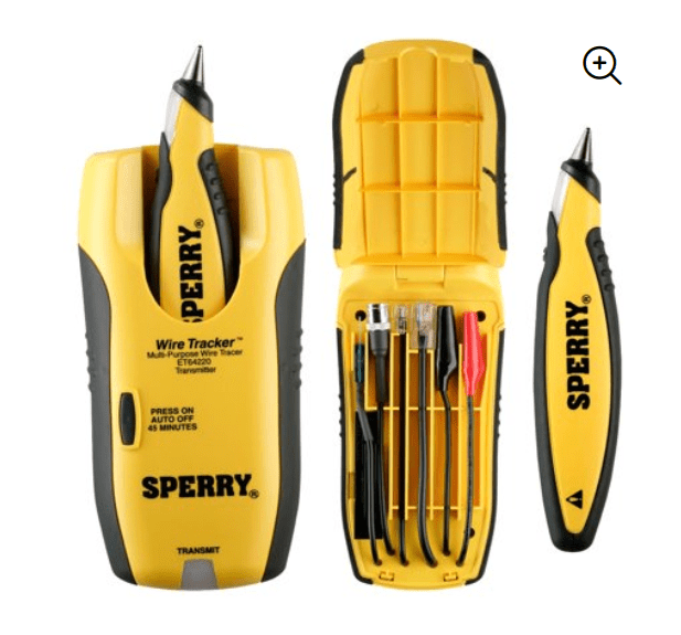

People that work in the business have tone tracers for that type of thing.
I have them for wiring, but not coax ...
I could rig it up to work, but they have a tool that does that.
Screenshot 2019-06-29 at 7.58.30 PM.png This is what I use to trace cables.

2) The tone tracer looks like a good idea. I'm checking for it online.
3) Sperry Wire Tracker also looks good.
