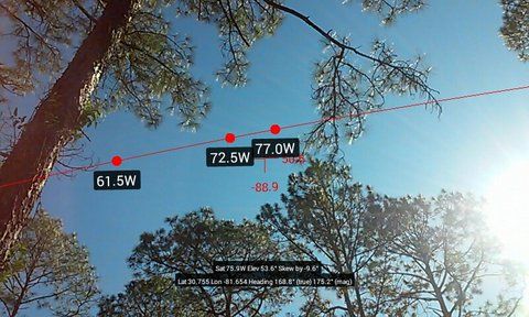

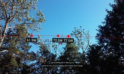

Well that got me 61.5 in the second LNB like it's supposed to be, thanks, I had to use my hand signal meter and dish point screen, I just hooked it in port 2 and found it easily, but when I done a check switch, I'm not getting 72.7, which might be a LOS problem. I downloaded a few more dishpointer style apps that were free didn't look like 72.7 had an issue but the app may need calibrated, 61.5 should be fine when tree's leaf out, but don't know 100% about the 72.7 yet, I may disconnect power to the reviewer and do a hard reset to see if it's stored settings causing me an issue, I'll return later with those results

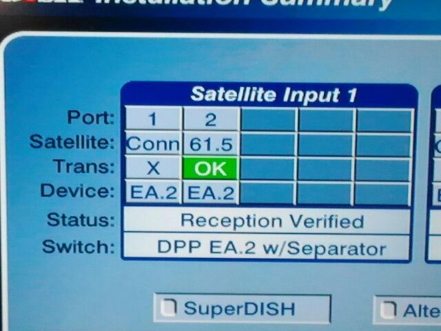

OK, cut the little tree down, sadly it wasn't the issue..Lol, sorry tree, anyway my installation summary shows nothing on port 1, it does say Conn, so does that mean it's on a satellite? For example AMC 6 possibly, guessing I need to move a hair west?
Edit: think I'll mark the mast and loosen it up, hook up my meter and put it on dish point screen on 72 and turn it a hair to see if it's the problem
