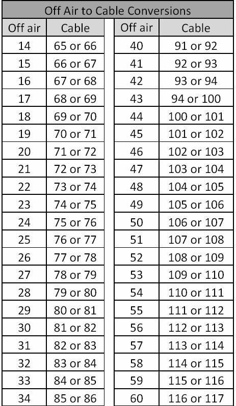

There is a way that you can get picture on another channel besides what the receiver shows. We call it "Air to Cable conversion". This is most commonly used with mirrored TV setups since one TV may be a Cable TV, and the other an Air TV.
Example: 60 in air mode will show a picture on channel 116 or 117 on a cable TV.
For the OP, I would change the modulator setup (menu-6-1-5) to cable mode for TV2 (default channel is 73), and set the TV2 to 73. This should bring in the picture without any issues in single mode, or dual mode

When analog OTA was still around I remember that channel 23 Air was the same as 74 cable (29 air was 80 cable)...had a few calls from relatives who would get a new TV and couldnt figure out why 17,23,29 wouldnt work....TV was defaulted to cable ;)
The OP either needs to change the TV output to cable or the TV input to Air
