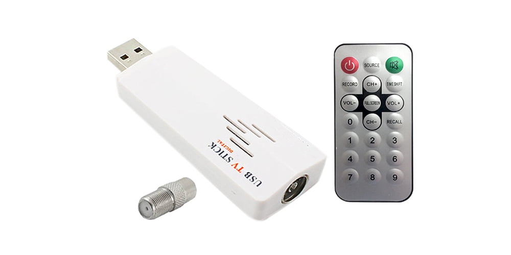

Well, so far, so bad. My adapter allowed me to physically connect the coax. And I can tell from scanning for channels that either channel 3 or channel 4 is being sent by the cartridge programmer. But the screen is black. This was using my only unused TV, which is a Cielo from Walmart.
I'll try Juan's video capture stick. No, maybe I'll try this one on Amazon which costs a little more, but also has an A/V adapter for even more flexibility, and easy returns if it doesn't work.
Amazon product ASIN B07FLKD5JQ
Another swing and a miss! The stupid adapter software will not run without being registered, and the license code cannot be entered. It literally won't let me enter the code on the CD sleeve. I sent the vendor on Amazon a detailed message asking for help. If they don't answer in a week or so, I'll return the damn thing and try again.
