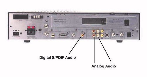

I don't have the 920, but here is the back of the 922. If the 920 is missing the Digital output you can only get Dolby Surround Pro Logic & PL II.
Hmmmm!!!!!!!!
O.k. Thank you for the quick feed back. My 920 is old anyway. Also have to think about the battery init. I guess I'll have to check around for a good deal on a 922. Not just yet though. Spent a lot of bucks on my new system. You know what I mean. I'll try yet and see what other avenues I may have to get true Dolby. Thanks again, Jim
