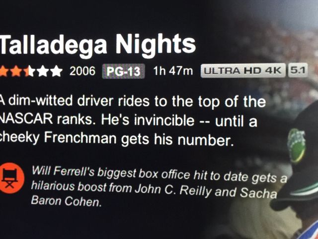

I'm curious to know if you guys are legitimately getting 4K. Netflix is telling me the program is the 4K version, but when I check the info from my TV, it says 1080.
Earlier I tried hooking up straight to the tv and it didn't work. This time it did after I let the show play for awhile. Too buggy for me and still no DD. I guess my TVs app will be the avenue of choice until this gets all figured out. If ever...

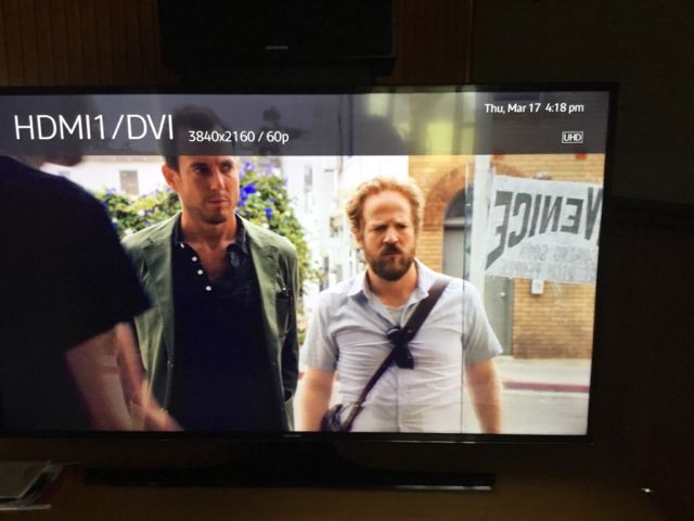

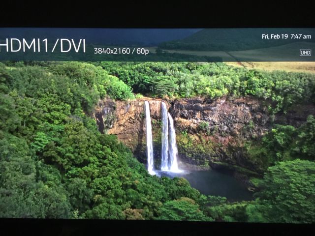

Well I guess I have 4K.
Scott I've noticed that all content 4k and HD are being up converted to 4k with hdmi from hopper3 to tv

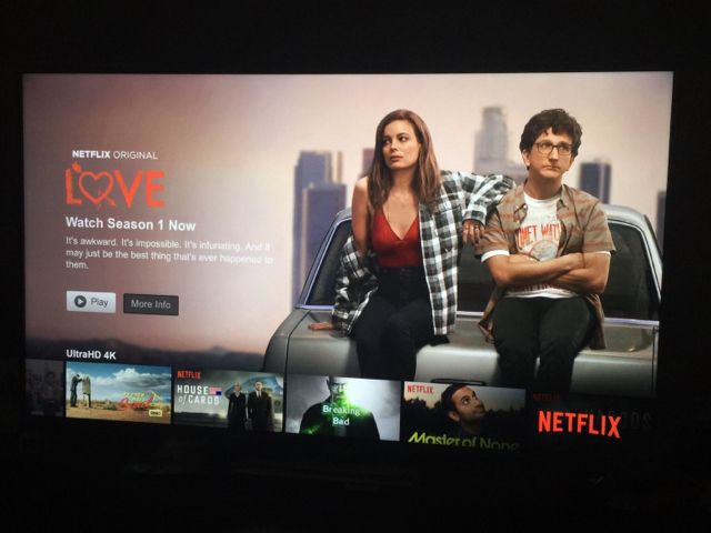

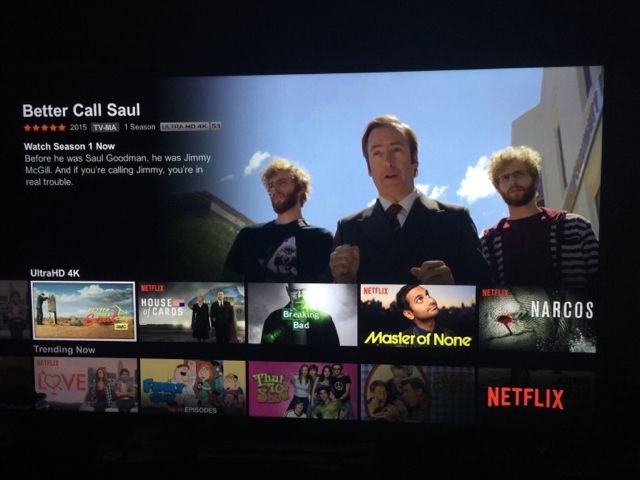

The apps front end is also in 4K too. That is different from any other platform I've seen Netflix 4K on. With them the app is HD and if you pick a 4K video, it then makes the switch.
