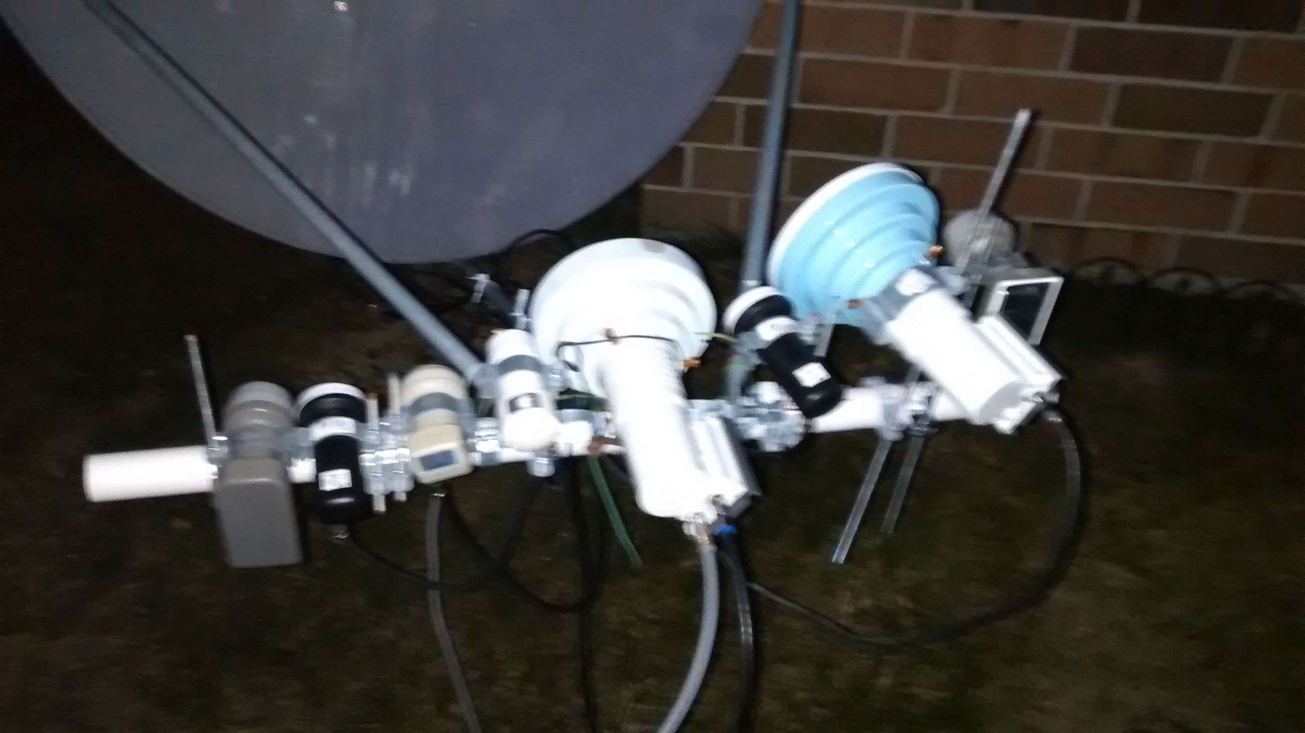

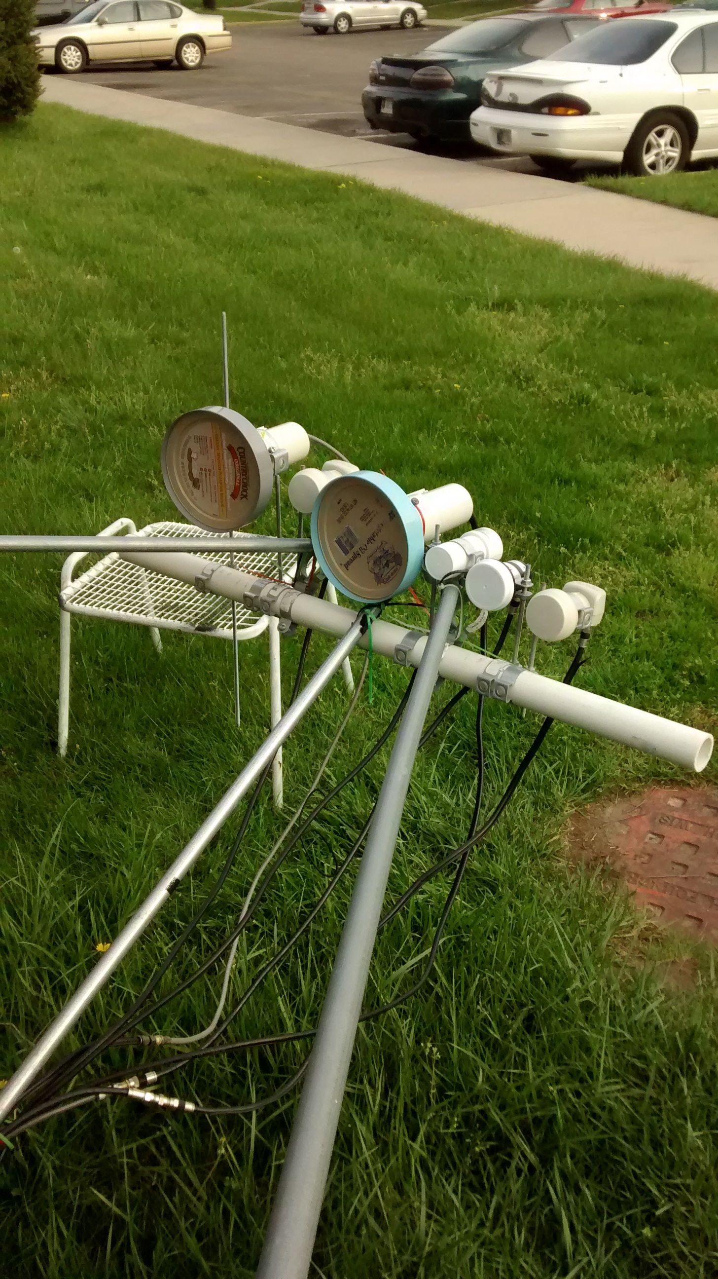

30w is the big fish cause its so hard to get. I have a another pic of close view I'll post. I have got lnbs from left to right 87w ku, 91w ku , 93, 95, 97w depending on which way I move the dish, c band 97, 99w 101, 103, ; 103w ku 107w or 111w c band, added 2 more one for 110w and 82 or 85w ku. Rabbit those are called conciliar scalers helps to get c band on a small dish. I am a proud mini budder.
