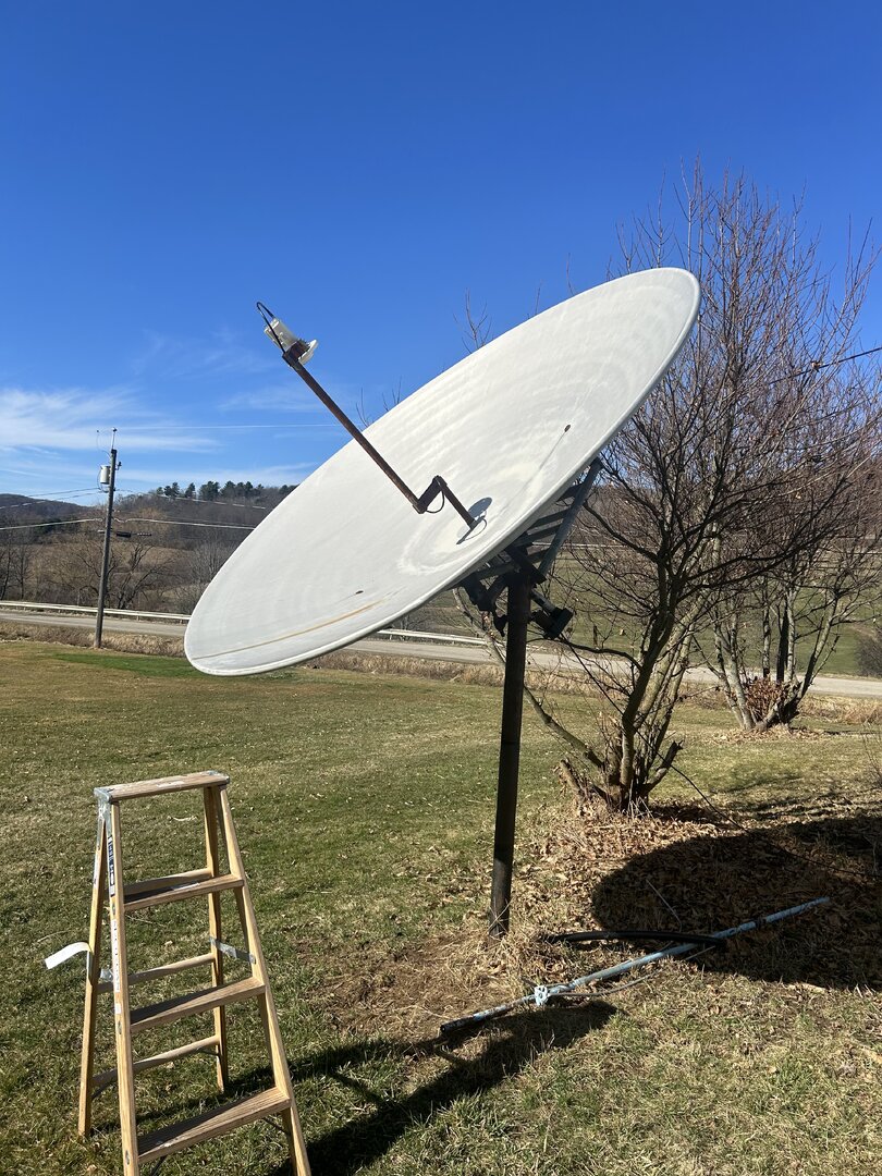

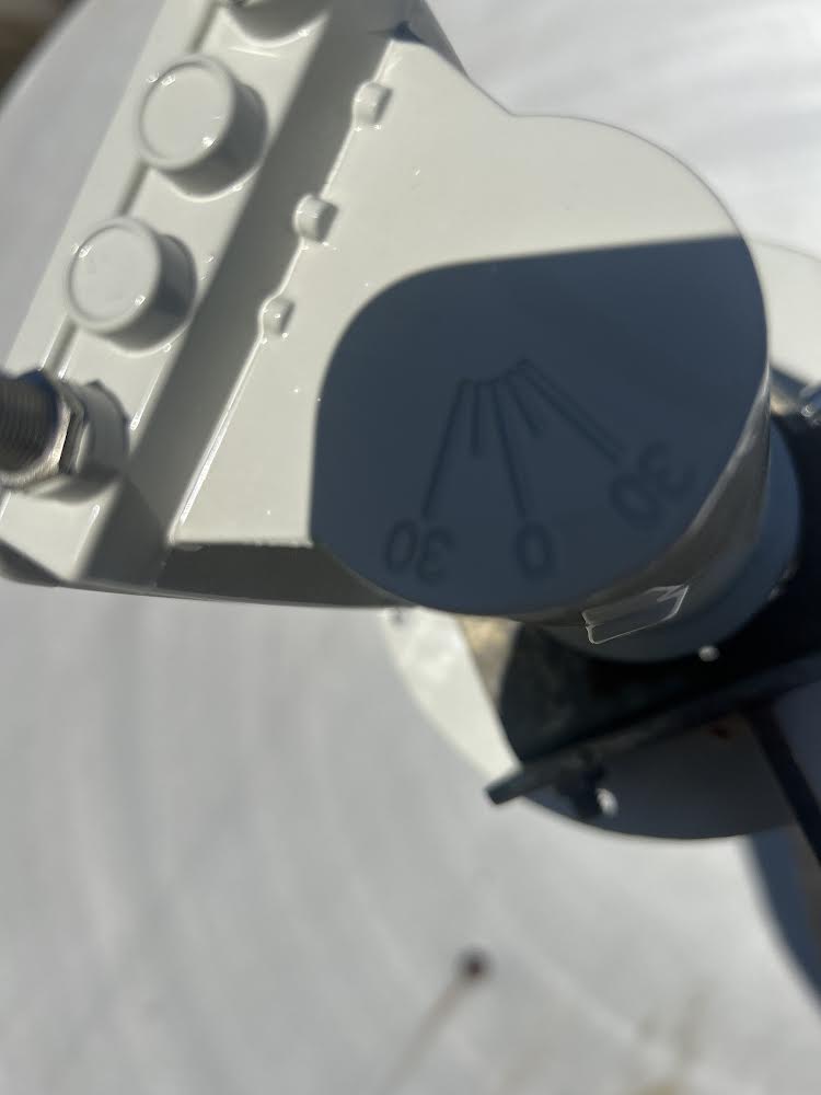

This is the setup
why wont it pick up 101W

I have never installed a system before I have no idea the name of the dish I have a titanium satellite LNB and a koquit receiver my location is Portville NY
You have to understand this is a forum of volunteers. This isn't customer service for big satellite dishes. Barking at us and making demands won't make anyone want to help you. This is a HOBBY. It takes time, research and effort. You can't just point a dish to the sky then complain "Why can't I receive anything."

I'm just wanting to know what could possibly be wrong because I didn't just point the dish at the sky I lined it up using dish pointer.com
How come I can't get a signal lock on it then
I don't know as of yet. There's a LOT of things that must be perfect, in order to do so. Please understand that the c-band signal is about the size of a PENCIL width. You MUST BE dead-on to do so. It's NOT the same thing as aiming a tv antenna just "sort-of" and getting some signal.
Give use some really GOOD photos of the dish MOUNT on the back. The azimuth and declination adjustments, etc. EVERYTHING. The more photos you can give us, the better for us to figure it out.

Ok I will send the ones I currently have I will take more when it's light out unless it's fine to just use a flashlight
Flashlight is fine, as long as the photos are lit up enough to get and idea of the settings. IF there's numbers and such, it would be good to be able to see them. Otherwise tomorrow with sun is good also.
Reactions: comfortably_numb
There are no numbers on it the dish is so old if there was they aren't there now
Are you absolutely POSITIVE that the pole is level North-South and East-West? Hard to tell from your photo, but seems like it's leaning. Maybe an optical illusion, but we need to know for SURE.
