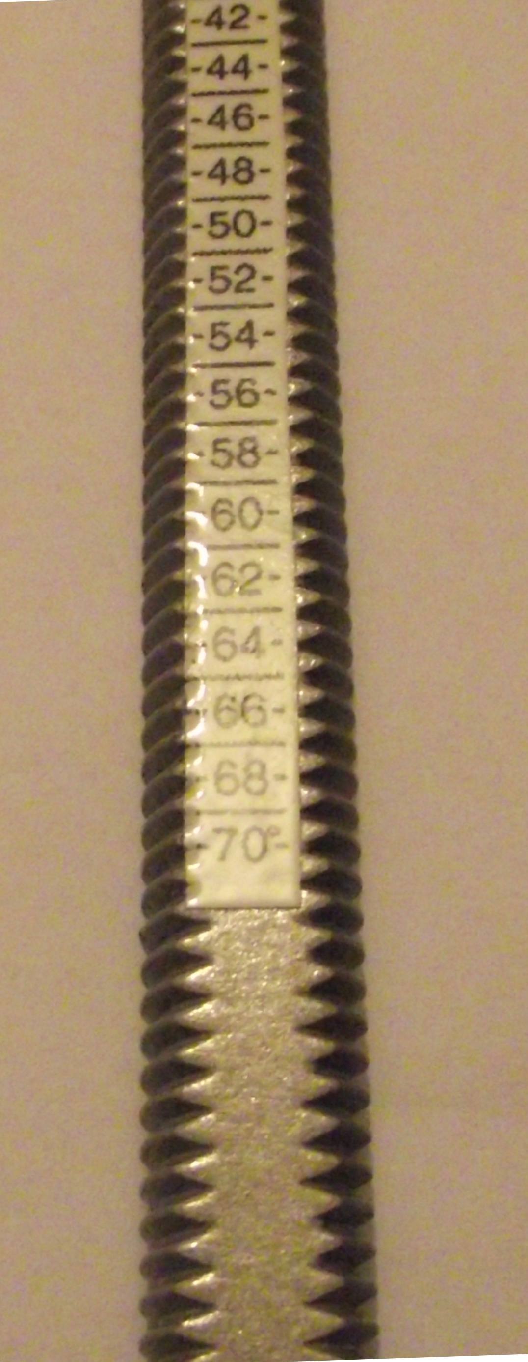

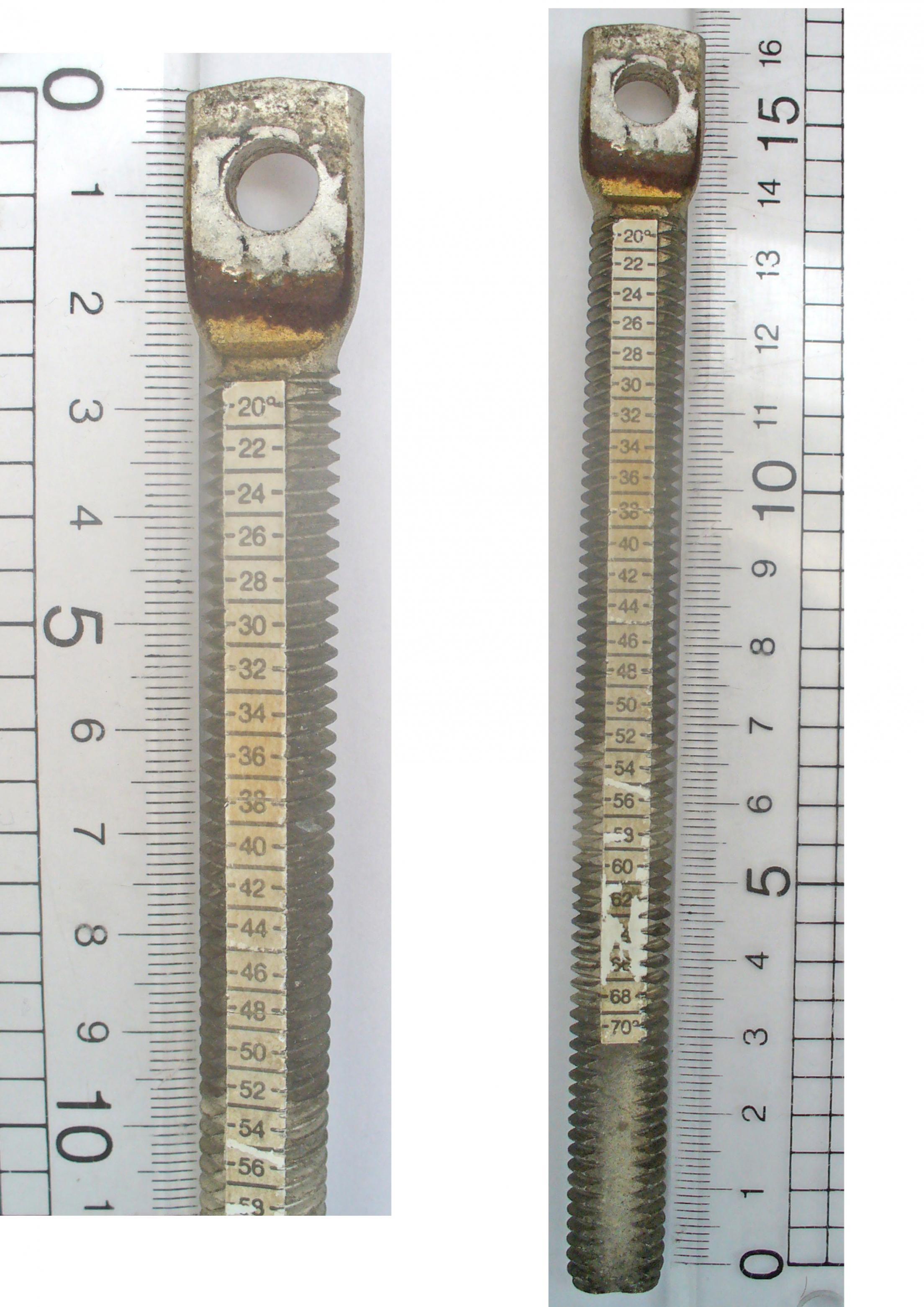

Looking for a new UNC Eye Bolt 1/2" x 6" for Channel Master Polar Mount that possible to ship to South Wales, UK at reasonable price.
It's used for the latitude adjustment.
Attached are two photographs, one with how my bolt is now after sand blasting removing the protective coating and a close up of one.
I'm in the process of restoring the mount and its just this needed. May just end up spraying some cold galvanising spray but nice to be all new :)

Nice to look all new. The mount looks good. But if I needed one of those, I would take a piece of allthread rod and hammer one end flat and drill a hole in it. Set my dish and never look at it again probably.
The bolt would be easy for any machine shop to produce, but you would want a new degree gauge for sure. Looked up some channel master sources I know of but nothing like that listed any more. Maybe some of the dealers would have old stock that isn't listed. I've seen hardware like that on Andrews dish mounts for TVRO type antennae, but I have not really looked closely at the gauge numbering... seems every installation is a bit different and those numbers are just a starting point.

I've looked at at some 1/2" stainless steel UNC threaded rod on eBay UK and create my own. That's something I may just attempt anyway. I even had a recreated sticker for the bolt waiting to be placed on :)

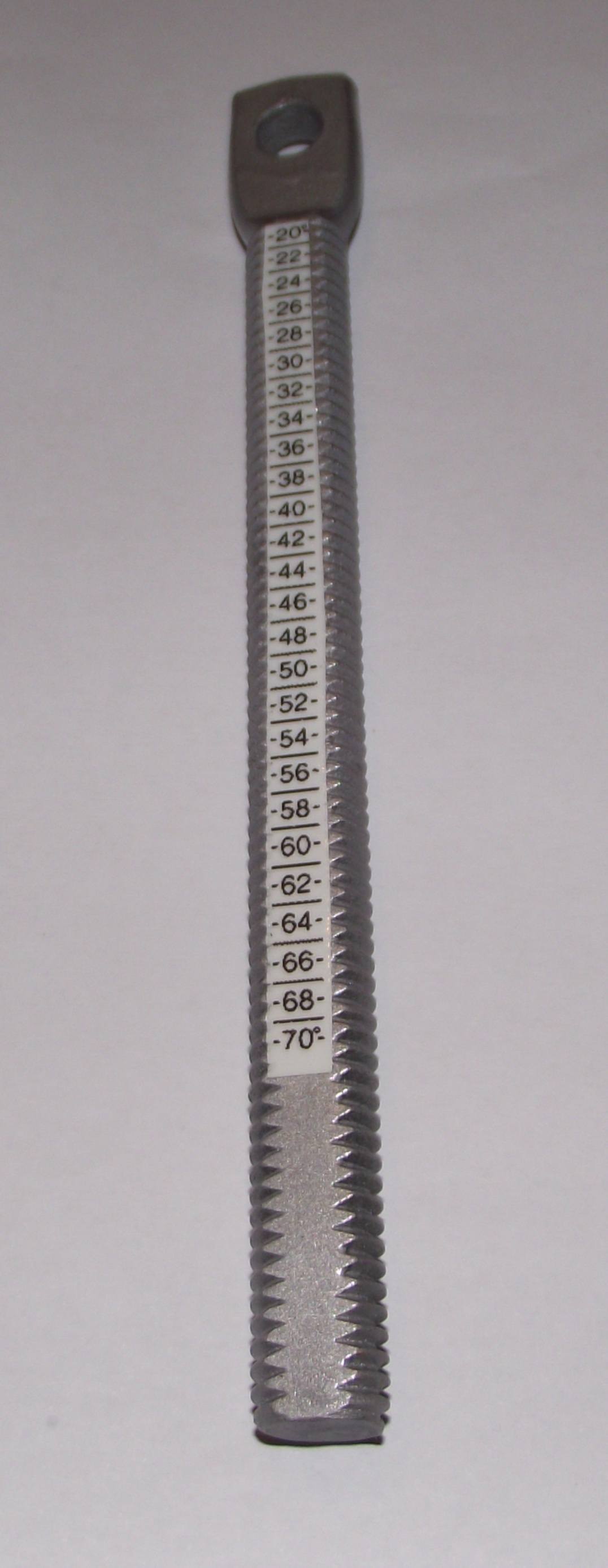

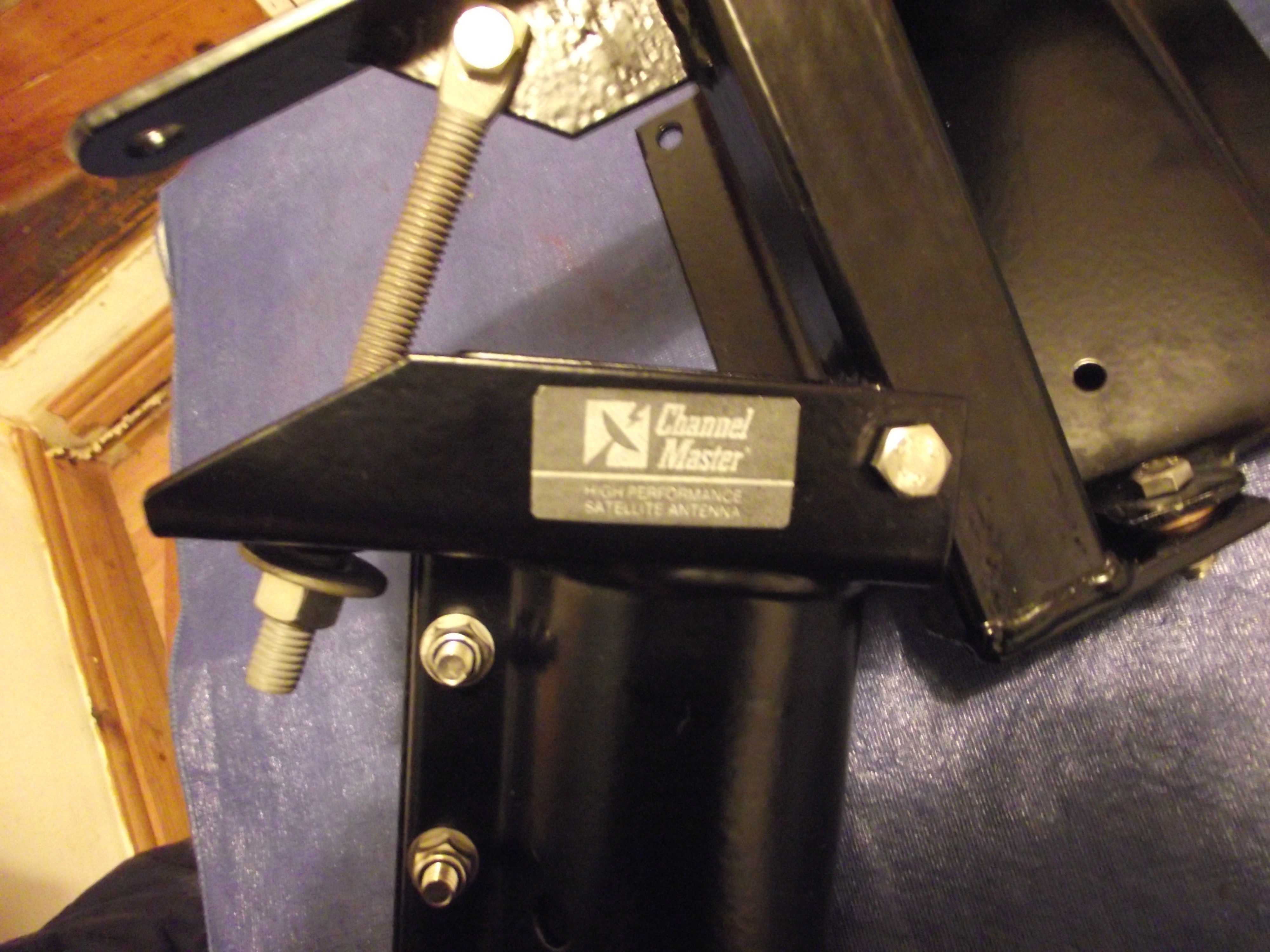

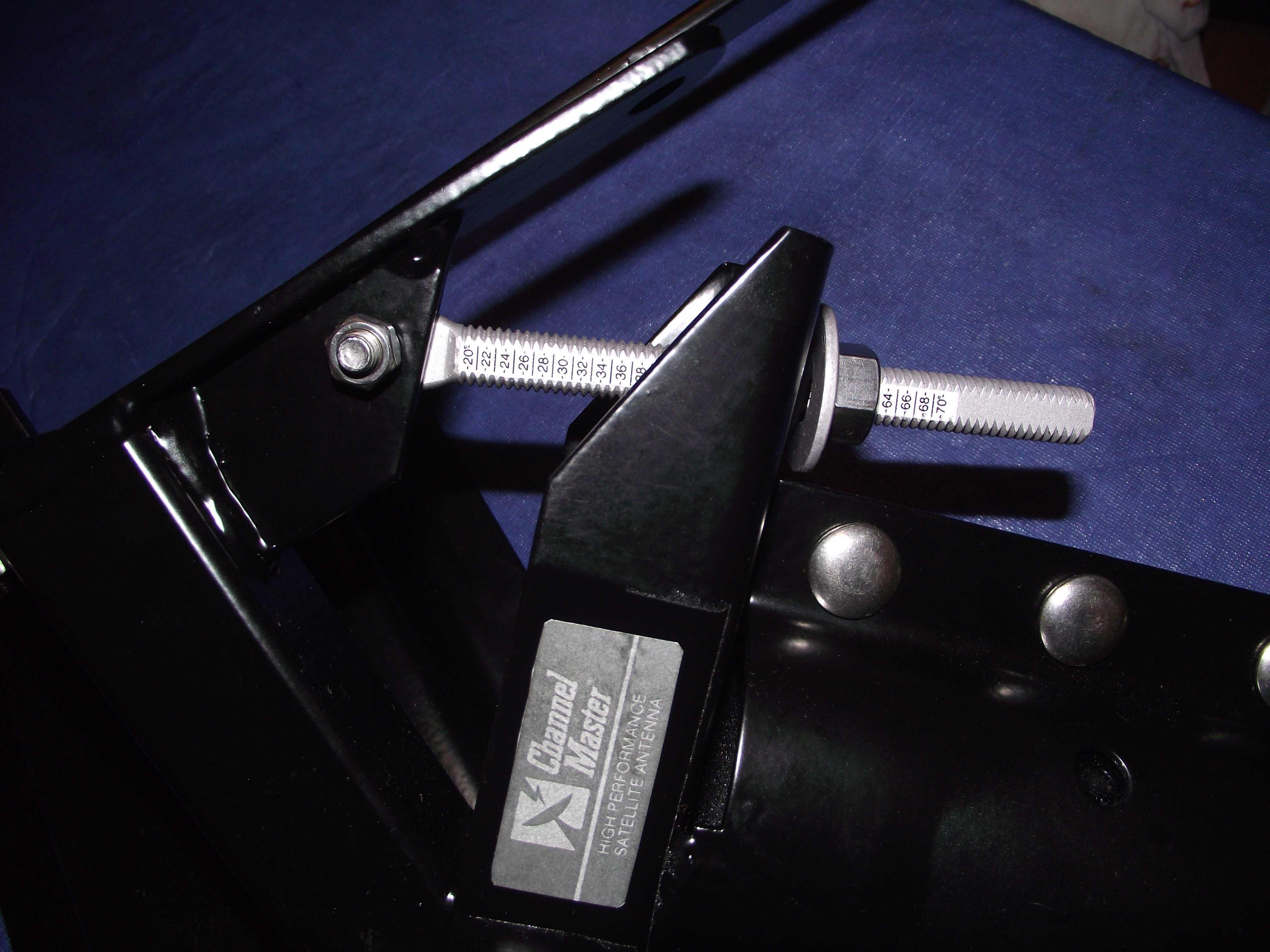

Bought some Cold Galvanising Spray Paint and sprayed it on the adjustment bolt waited for it to dry, stuck on the label then sprayed it with a coat of clear lacquer.
Also I've sprayed a coat of lacquer on both labels on the mount itself, applied lacquer not just on the sticker itself but gave a border around the label to try and stop the water getting in.

Looks great! Excellent workmanship!
Wow! If it works as good as it looks....:)

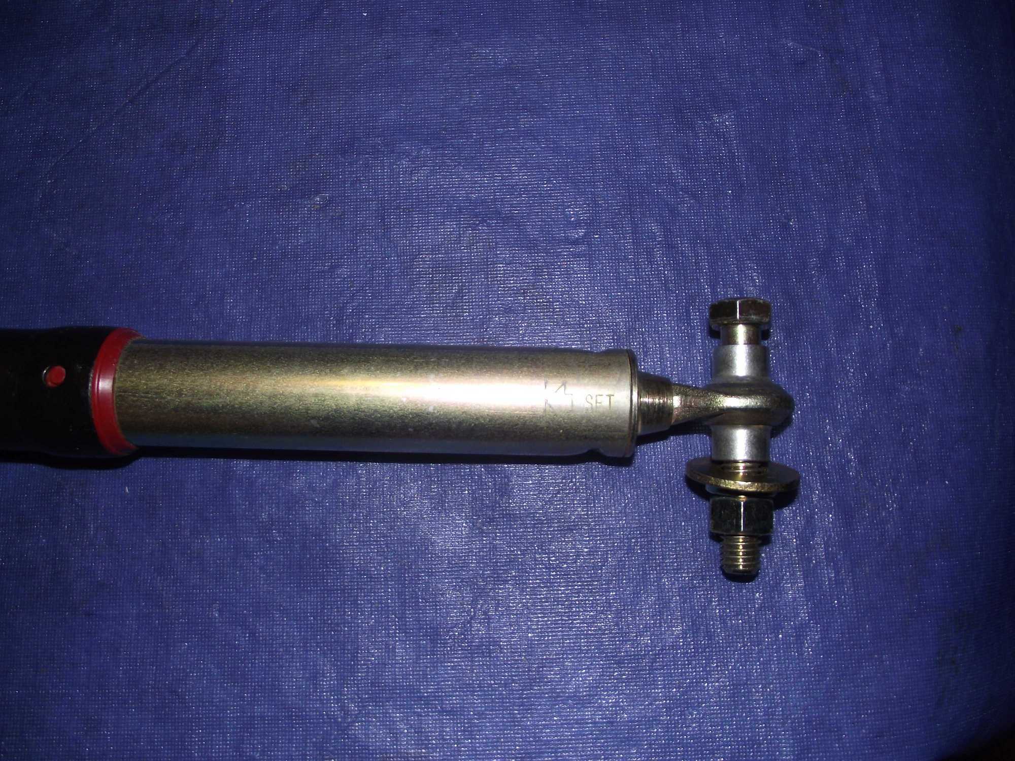

Another new part, a probably unused at least nearly new Venture Skylighter 12" Actuator needs a coat of hammerite in places and was missing a few nuts, bolts and washers which have been replaced, but works properly.
