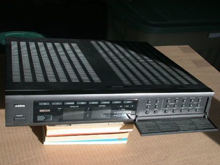

Over the Christmas break I was at my girlfriend's grandparents who happen to have an old 15 foot BUD I have always admired and hope to have some day. This time I was there, I found the receiver they used with the BUD. It is a Uniden UST 7700 with remote (UST 7700i). They no longer use the BUD and were happy to let me take the receiver. I couldn't find the manual, so I have little information about this receiver. I have done some Googling and searched the forums, but haven't found anything very informative. So far, all I really know is what I have gathered from looking at the receiver. It has support for both C & Ku bands and has dish motor control capabilities. Does any have a copy of the manual for this or any advice/information about using it? Anything at all is appreciated! I will post pics later.
If I remember right the 7700 was the lower end unit to the 9900 IRD which was my first C band receiver.
I found this in a old catalog about them (attachment)
I've been going through some old satellite and video stuff I have here over the holidays. Man those were the days :)
EDIT: I just found my UST-9900 IRD original manual. I would scan it but it is over 30 pages (too much) I may be able to scan some specific stuff if you think it may apply to the 7700 let me know anything specific you may want to know.

Still have one of those, good little receiver but no motor control on that one. Use it sometimes when I'm aligning my big dishes, with analog you can still find enough feeds to get loosely setup on the arc, then switch to a digital receiver to fine tune. It'll do a fast channel scan too, which is very helpful.

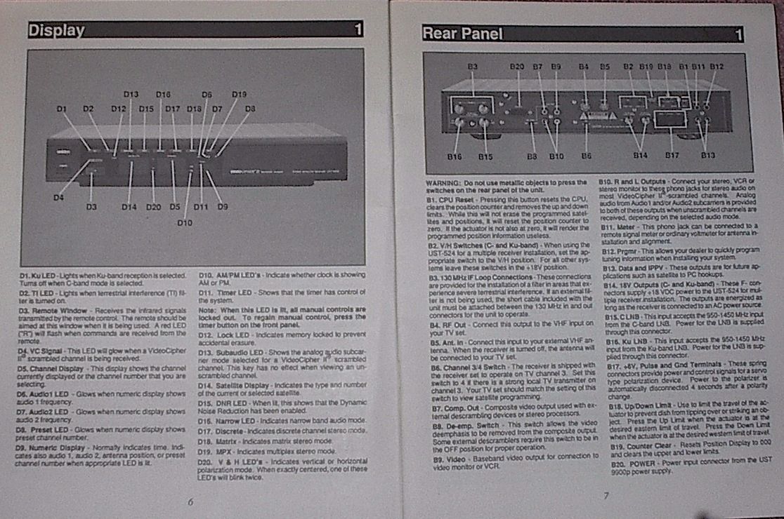

UST 9900 Major pages of manual.
I used my camera to take some shots of the major pages on operation from the manual. There readable at full size double click on the lightbox image to get and save the full size.
Enjoy :)
TvroPro ;)

Thanks to Phlatwound and TVROPRO for the helpful advice and pictures. Bottom line, at least from what I am hearing is, even if I get this system working, I still won't be able to get very much FTA programming.
Would I be better off investing my time and money in a DVB receiver, as suggested by Phlatwound, or can I get some kind of digital converter to make my Uniden UST 9900 receiver work? It has C and Ku if that makes any difference.
Also, if I need to buy a DVB receiver, what would be a good quality one and what can I expect to pay for it used?
Also, will my dish (Unimesh 10') work with any receiver?

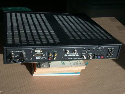

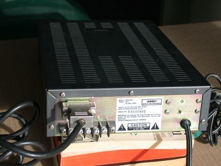

kinetic711, Do you have the interconnecting cable between the boxes connected? I remember a round plug with 5 or 6 pins on the cable.
Can we see a photo of the receiver?
Well, no good news to report. I tried to get the dish to move from inside the house. I tried from the power supply and from a battery as suggested earlier, but no go. I guess I will have to go outside and put power right to the motor and see what happens, but not today; it's -30C right now, (that's about 22 below F). I'm thinking maybe the power supply is no good or maybe there is a cut in the wire underground or maybe the motor doesn't work or maybe the actuator arm is seized from years of non use. I will try to eliminate these possibilities one at a time once it gets a little warmer. In the mean time, as requested, here are some pictures of what I am working with. By the way, the wiring in the house is a 3 part, flat, black wire. 1 part has 5 wires (red, white, yellow, black, green), 1 part has 3 wires, (red, black, white) and 1 part is a co-ax cable.
