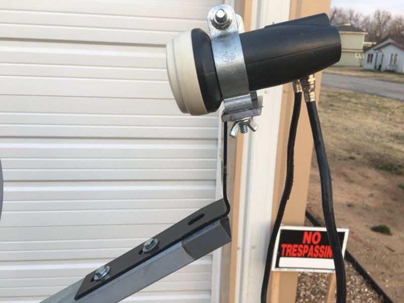

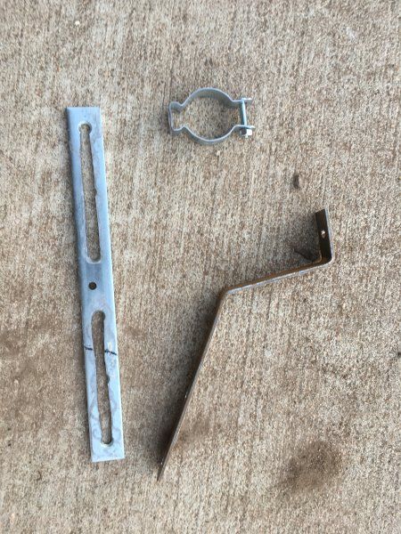

here are some photos of the items i used on my dishnetwork dishes.

Thanks for the pictures on your setup for the lnb/lnbfs!! Im going to have to come up with some custom setup if i want to use multiple lnbs. Just curious what kind of switch do you use? I have some old dish network switches..a dp pluz seperator 123254 and also a dish Network SW21 switch. Can i use either of those to combine two separate lnb into one rg6 coax to the receiver? I don't know anything about how to switches work so this is the next thing i need to research. I never got around to aiming for galaxy 19 (97w) today because after i got back i decided to run rg6 from the dish to inside so i could hook it up and enjoy the fruit of my labor. It was 61f in Michigan today so i took advantage of the warm weather to run the line and then seal it up for when it turns cold again.
Also i kind of scalped and old cable line to get the fittings. Is there a cable tool (crimper) people would suggest getting to make own custom connectors? I don't think mine will hold up long run because it was kinda flimsy since the one i took off wasn't the crimp kind.

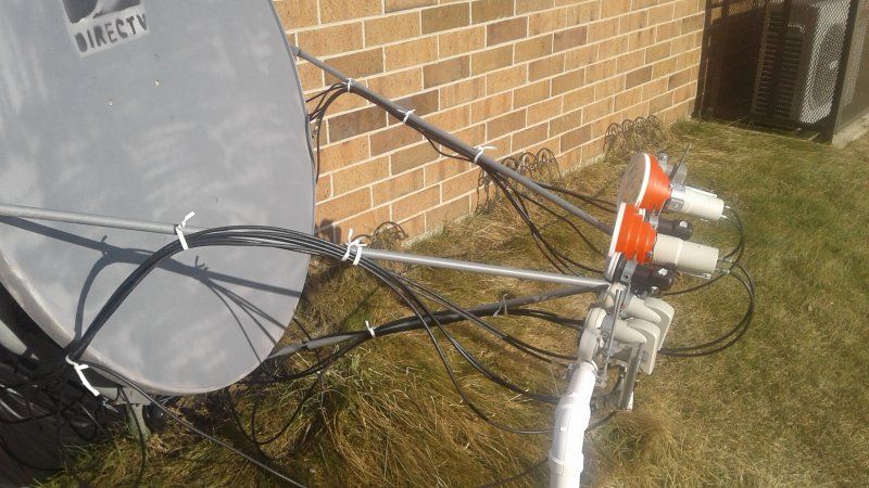

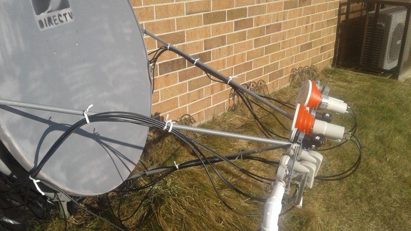

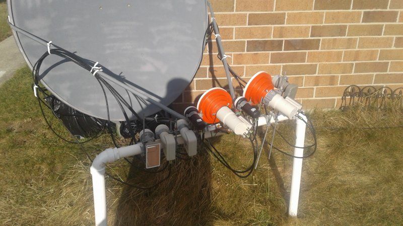

This is what going happen to you when you start getting obsessed with FTA.

1.2 meter dish with 107w c band and 99w c band in the middle.
