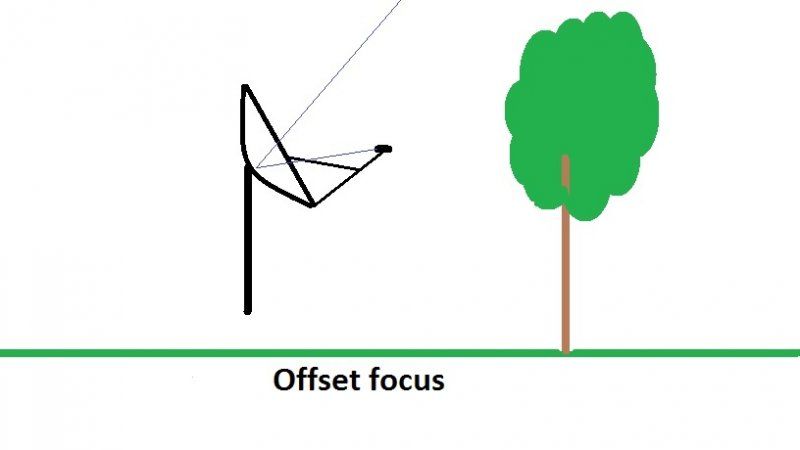

Just remember that an offset dish even though its pointing at the trees is actually seeing sats by the amount of offset.
The focal point of the dish is not in its center but at its base). In other words the dish is looking about 24 degrees higher than what its pointing at. In my case the dish is pointing at my neighbours house but receiving the sats no problem.
Whoa i really need to read up on this then. By offset do you mean that the lnb are held out in front? I think i also need to understand how the fact that my dish 36EDS is elliptical and how that affects things. I know it's still about 36" wide but the height is only like 21/24" so it's probably a bit touchier to line up since there isn't as much surface area as a true round 36" circle.

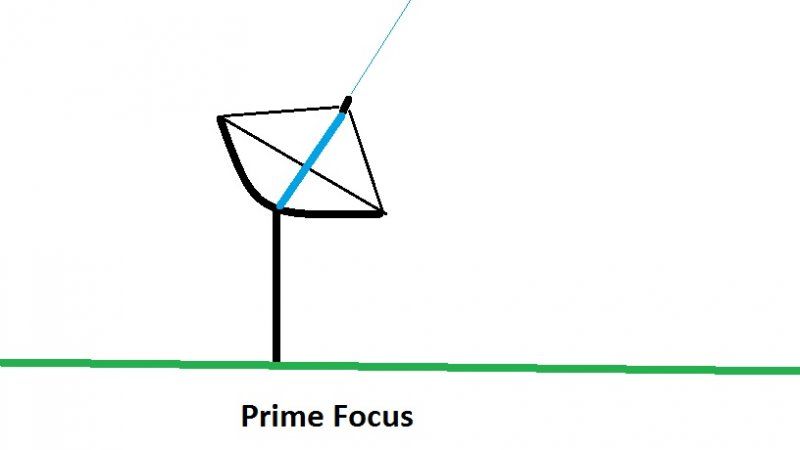

Im including a couple of general diagrams what offset focus and prime focus dishes do. Usually Prime focus dishes are pointing directly at the satellite, when offset focus dishes dont. Typically prime focus dishes are 6' and up and usually are c-band or c and ku band, and offset focus dishes are Ku band. It is possible to get some of the stronger c-band signals with a large (1m or 1.2m) offset dish. But its not "easy". the blue line in the illustrations is the "signal" from the satellite. you will notice that in the offset focus diagram that even though there is a tree in front of the dish the signal comes in from much higher then the direction the dish actually points.

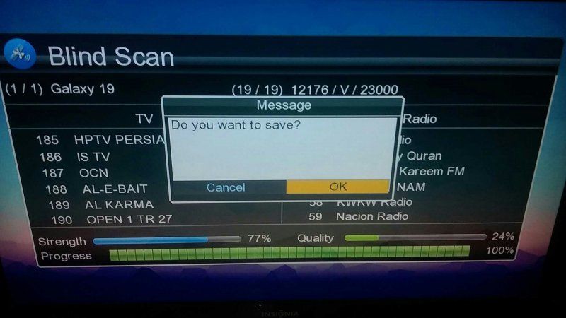

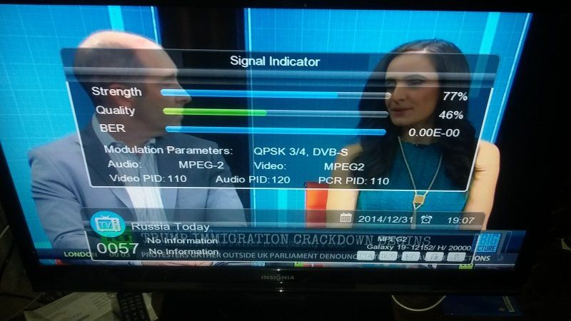

Awesome thank you this helps a lot. I have great news, i came home from work today and adjusted my tripod ever so slightly from 95w to where i thought 97w was and the very first try i got 150 channels. Some were coming in beautifully and others were coming in a few seconds and dropping because quality was like 10. I made a very slight tweak (thank goodness i can hear the TV from outside lol) and nailed it! I just got a total of 190 channels from galaxy 19!!! Attaching a couple pictures.

Yeah 2 degrees with that small of a dish aint much, congrats! I know if you had a switch you could set it up like the example i posted pics of and you could get the NBC mux that has COZI and also has NHK news and RT and some infomercial channel as well as the Microhd channels on top of the 97w mux.

Thank you and the awesome news is i didn't even have to change my ELEV or SKEW settings on the dish. Just had to move it slightly sw. This means it's probably a very good likelihood that i can at least get 95w and 97w at the same time with 2 lnbfs. Would love to get the 103w with nbc and nhk world too!!
So curious question..what is mux?
