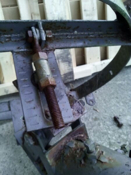

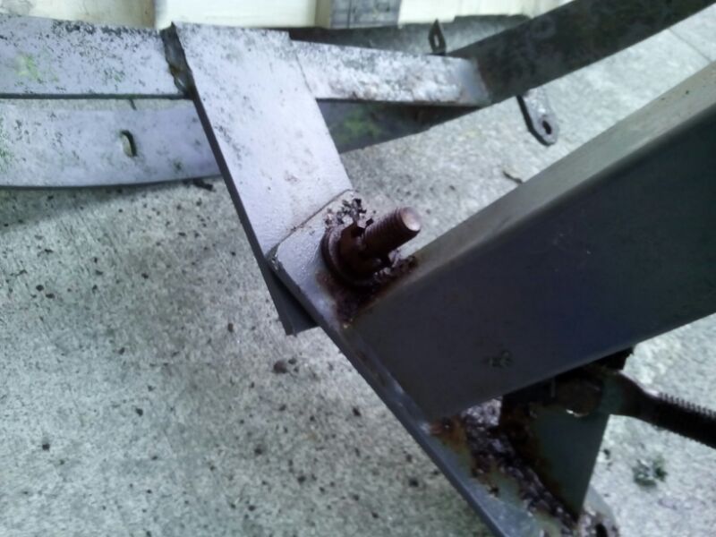

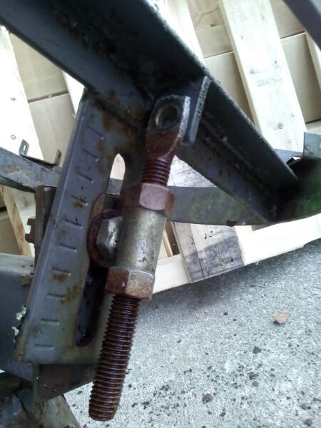

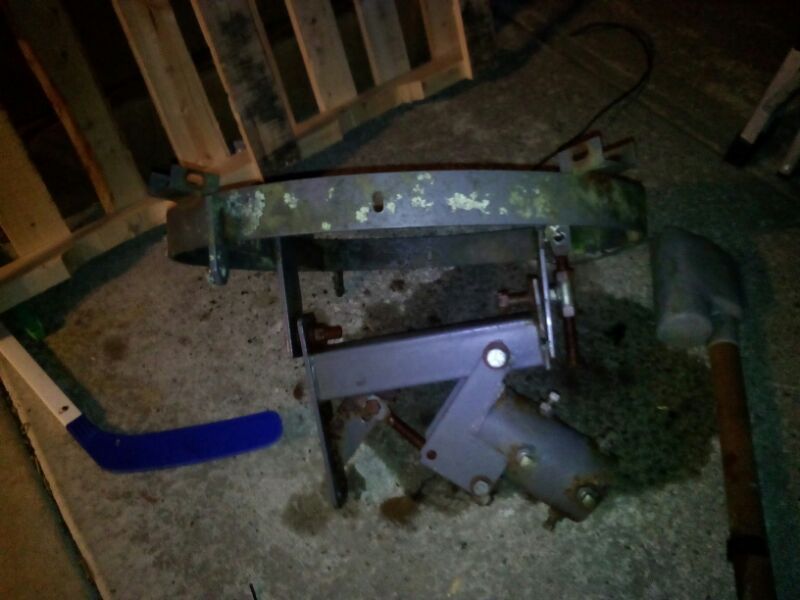

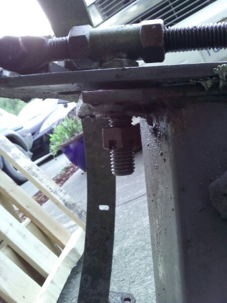

So today I got the panels all cleaned up straightened out the bent rod.
The weird thing was when I removed the actuator, I expected the ring to move free but it didn't.
I started to loosen the bolts and realized that the ring was bolted in place.
I have attached some pics and am trying to get my head around this. I don't see how this unit can do declination while also moving freely.
IMG_20150927_58776.jpgI took out this bolt
IMG_20150927_53985.jpgThen loosened this one
IMG_20150927_12652.jpg Then loosened this one
IMG_20150927_35411.jpg And it would then swing in one direction.
I don't see how this is supposed to be motorized and be adjusted without tightening it in a way that locks the ring ...hmmmm
I just took this pic. A bit dark, but easier to understand the above pics I think.
