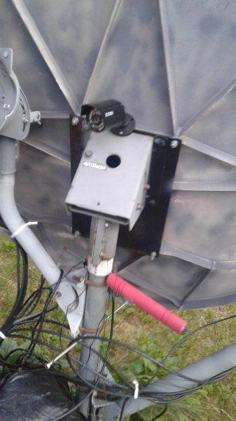

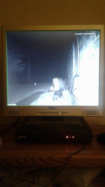

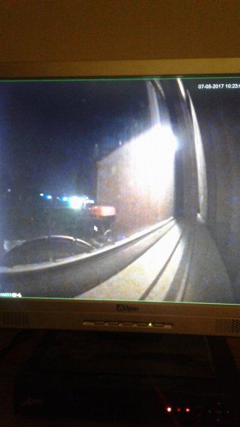

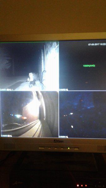

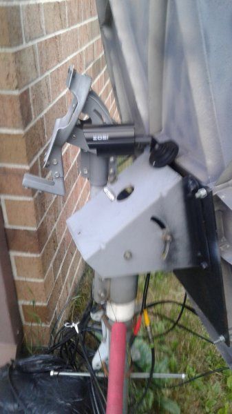

Well I wanted to give you guys an update I found 2 cats, giant moths, rain, cars, a few stupid neighbors but nothing good yet but I have been learning how this stuff works. I got my mom to learn this she hated at first but now she likes it. I got night vision cameras with infrared so it works well at night. I put camera at the back door in the kitchen window so she can see that one too. For under $200 you can put together your own kit so if anyone would like some help I can help them out as best as I can. here is a pic of one of my cameras I have a white one also. Here are some pics.

Don't put a nightvision camera behind a glass window you get a white wash. I tried that i had to go back to the camera thats at the back porch now.

I am using an Anran 4 channel system from Amazon for $39 hard drive is about $40 to $50 for 1 terrabyte. Its an western digital purple. I cant mount anything to the apartment so the dish was the next place on my mount there is a hole at the top. It perfect place to mount my camera since its behind the dish people won't see it untill its to late.
