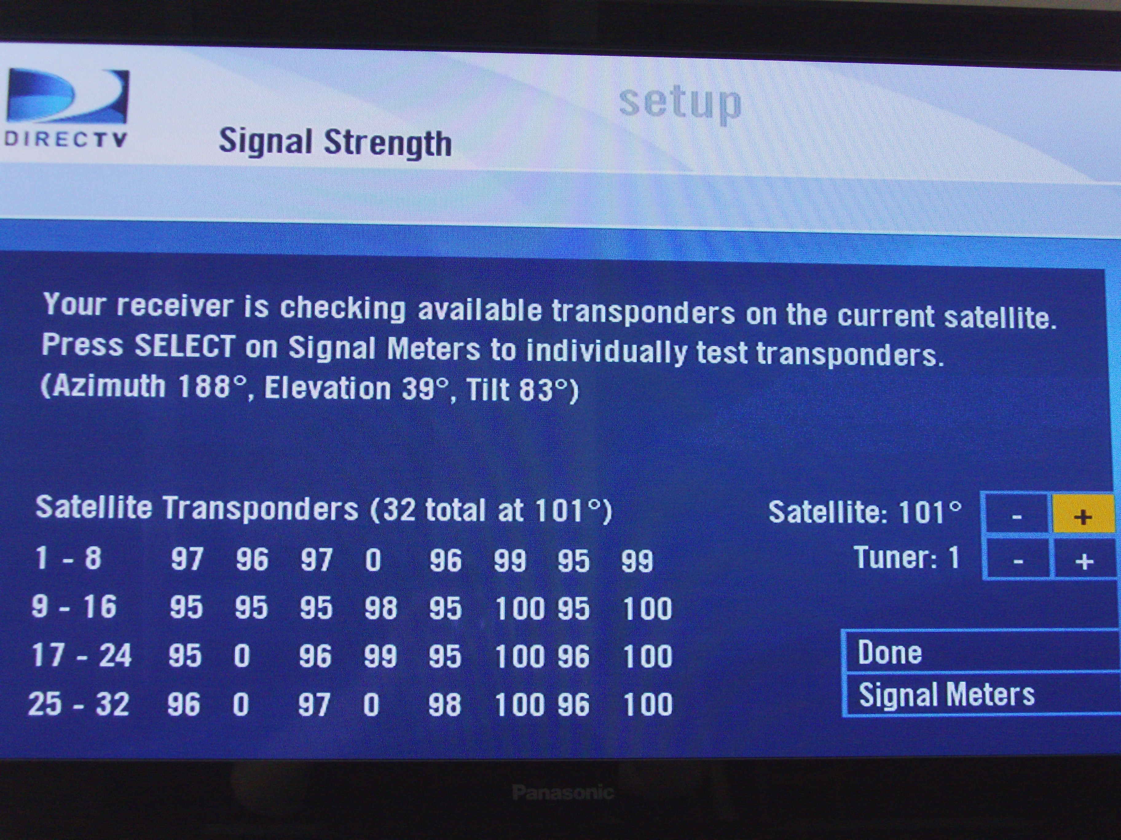

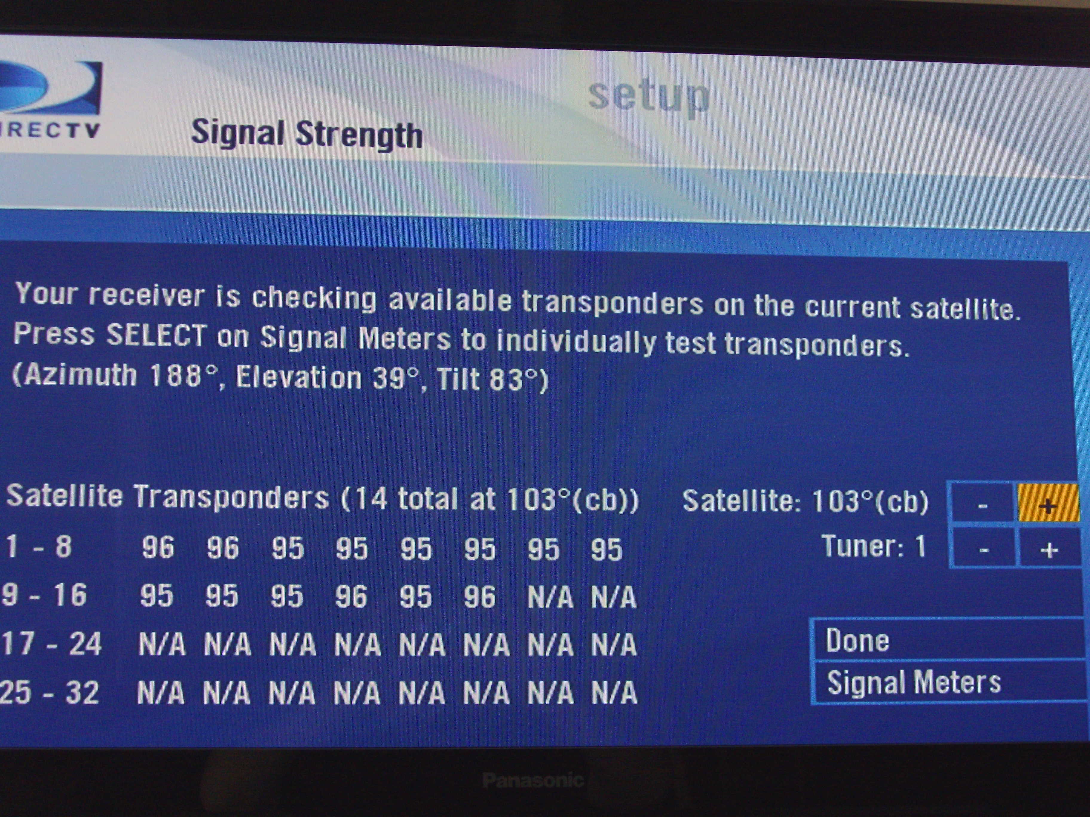

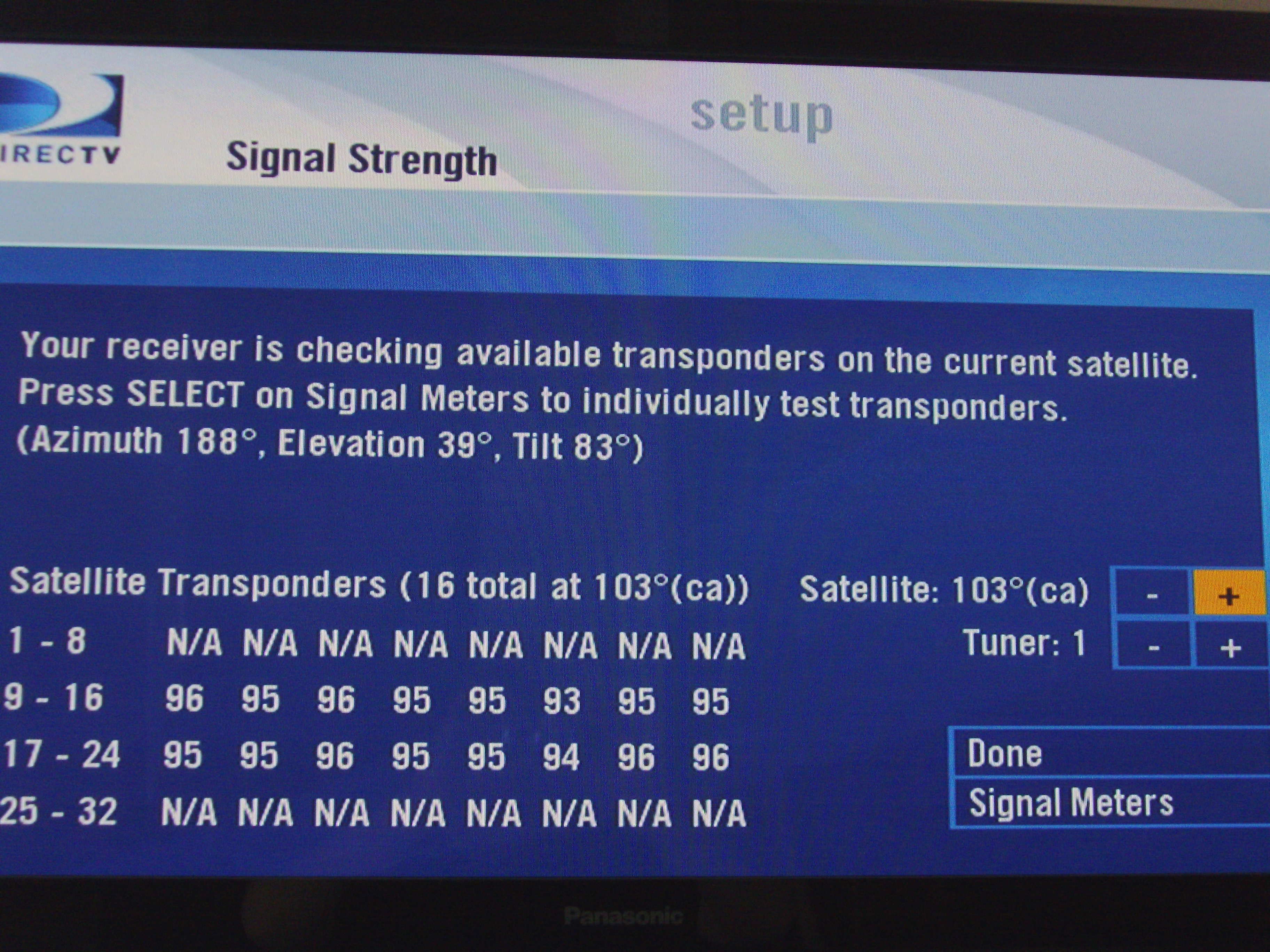

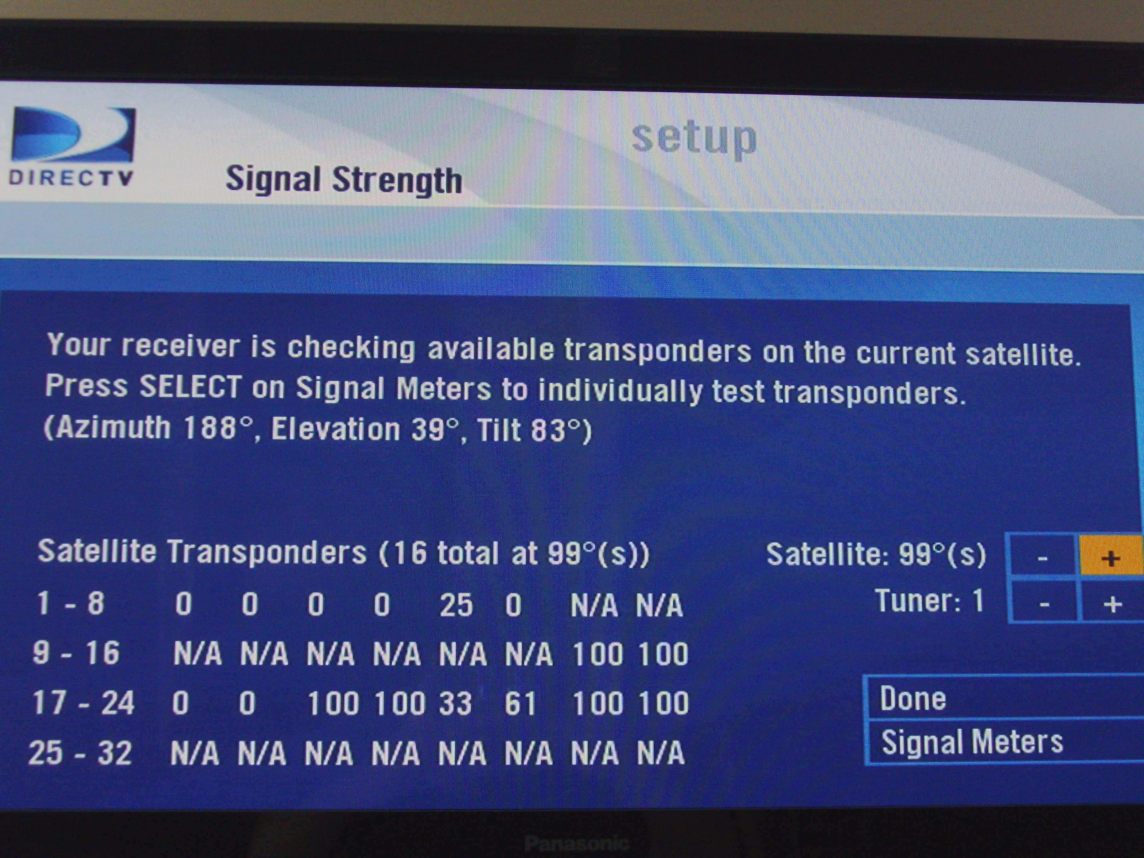

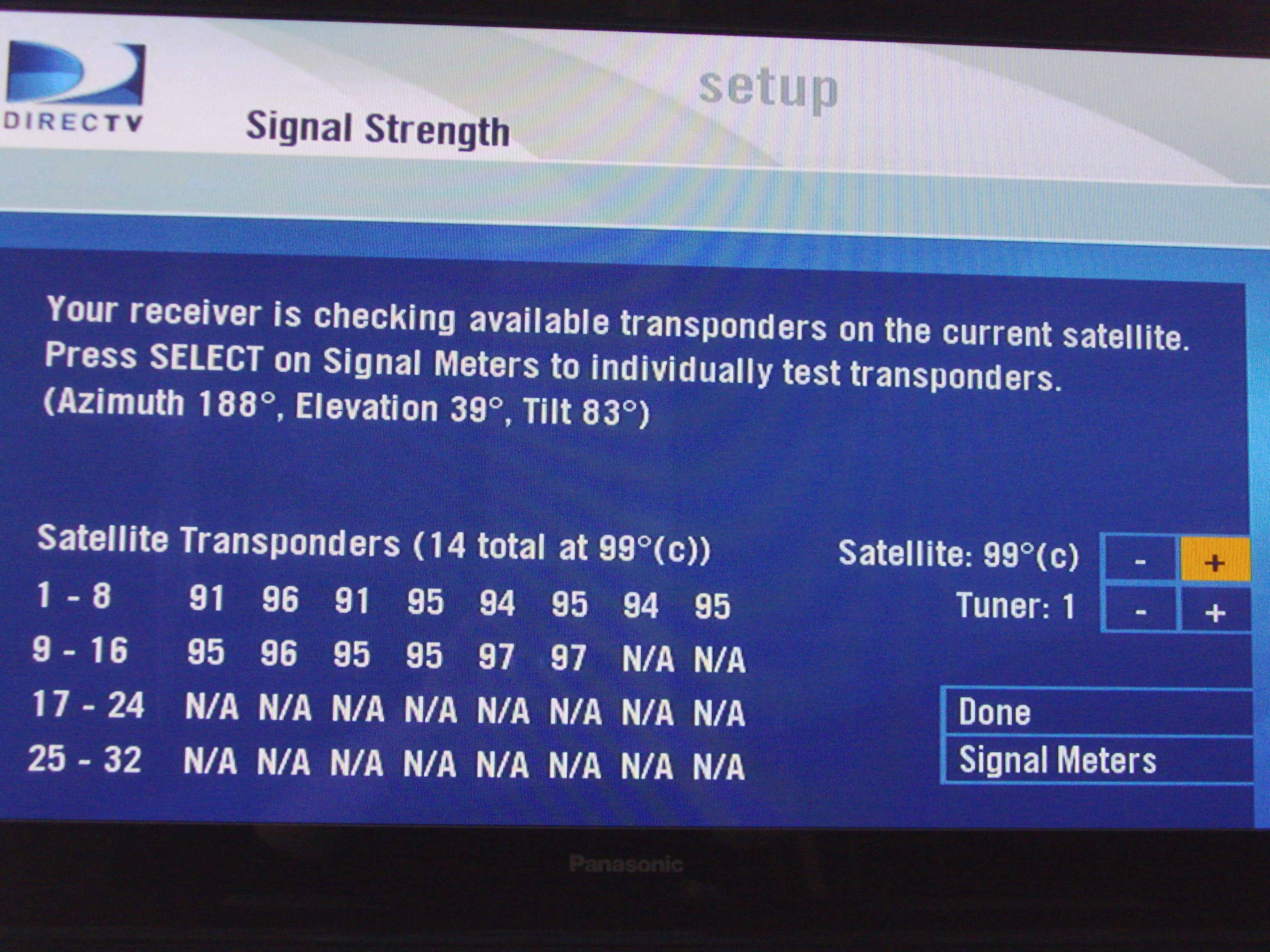

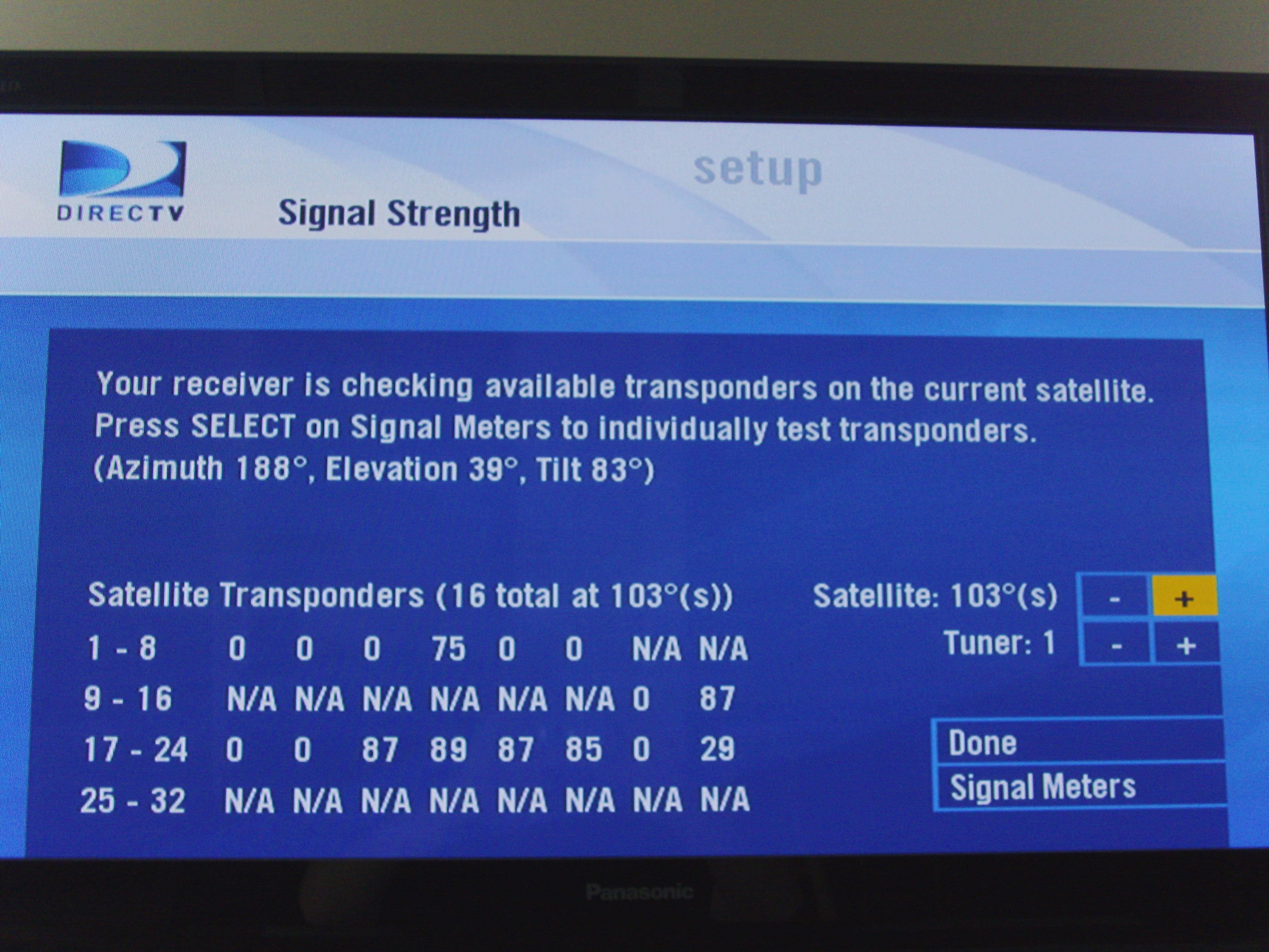

WOO HOO! All up and running...well been up and running an hour+ ago. Was playing with it.
Dispatch called me at 9:45 that the tech was almost there. I said he just pulled in. 7 year installer. Showed him the roof (which was cleaned off already) and the existing stuff. He said they are told to use the "old setup" (aka the 6x8 switch) if they can but he saw the R22's and said "I use a swim setup" :)
I had to laugh as he said he never seen the dish I had up there and he had been an installer for 7 years. I had an old Phase II with a single LNB in the middle. 2 lines into the house to a 3x4 multiswitch right behind the 2 R22's
With it being -2 out he already had the dish installed and roughed to the right elevation and skew. Got the pole up and level. He used an old LNB to aim the dish which took him all of about 3 minutes. He put the dish up and locked the bolts right away. Then used those "fine tune" knobs to finish. Swapped LNB's and hooked up the SWM in the house and reran the sat setup on the R22's. He was confused as to why I'd keep the R22's on the HDTV and I mentioned that the HD gets turned on automatically once HD is on the account. He had heard of it but didn't know how that worked. Hooked up a H23-600 in the computer room and that worked. He had to call it in but got it working.
Signed paperwork, thanked him for coming out in the cold (and tipped him). He thanked me for helping him with the minor details and he was on his way.
Total time...about an hour. Checked the R22's and they now say "R22 (with HD)-100 as model #.
I think the signals are good ;)
all and all I happy :) I called D* to verify my free HD which I have now :)
