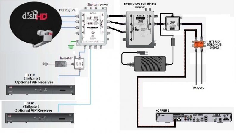

I'm trying out putting the DPH42 downstream of the DPP44. Something tells me the DPH42 needs a DPP feed. *edit: yeah, that didn't work. Putting the DPH42 on the DPP44's trunking lines produced the same results as above, and on the receiver lines not even the HWS worked. So I'm out of ideas.
It does need a DPP feed.

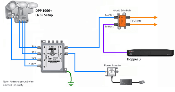

Here's the wiring diagram. The power inserter may also go off port 2 before or after the hub on the Host line
That's the diagram that made me think it needs a DPP feed, but apparently not from the DPP44. I may need to get the DPP LNBFs.

I would think that it would work off of the 44 switch, but hey attention to the wiring because it has to be done in this specific way coming from the dash to the 42 switch. How that works with a 44th switch, I’m not sure
What I would do is run a direct connection from the DPP44 feed output (119 or 110, whichever one the software spools are on, I am not sure which) to the Hopper and see if it will upgrade its software. Then connect it as per the diagram including the DP42 switch.
This is actually almost precisely my setup: Power Inserter on Port 1, Hub and everything downstream on Port 2. The only difference being the LNBFs are DishPro, not DishProPlus. I have a DPP 500+ LNBF on order.
All that is needed is a dish pro feed. Dpp is not necessary.
My setup is a dish 1000 with 3 dp dual lnbfs connected to a dpp 44 switch with the dph 42 switch trunked.
I thought that was the case. Looking at charlesrshell's wall and HipKat's wiring diagram, if DP LNBFs didn't work then 129 wouldn't work.
Is the DPP44 necessary? I figure it would be needed to feed any ViP receivers; the trunk lines don't change the LNBF signals, it's just what goes in comes out, right? Either way I did trunk the DPH42 to the DPP44, and no change.
