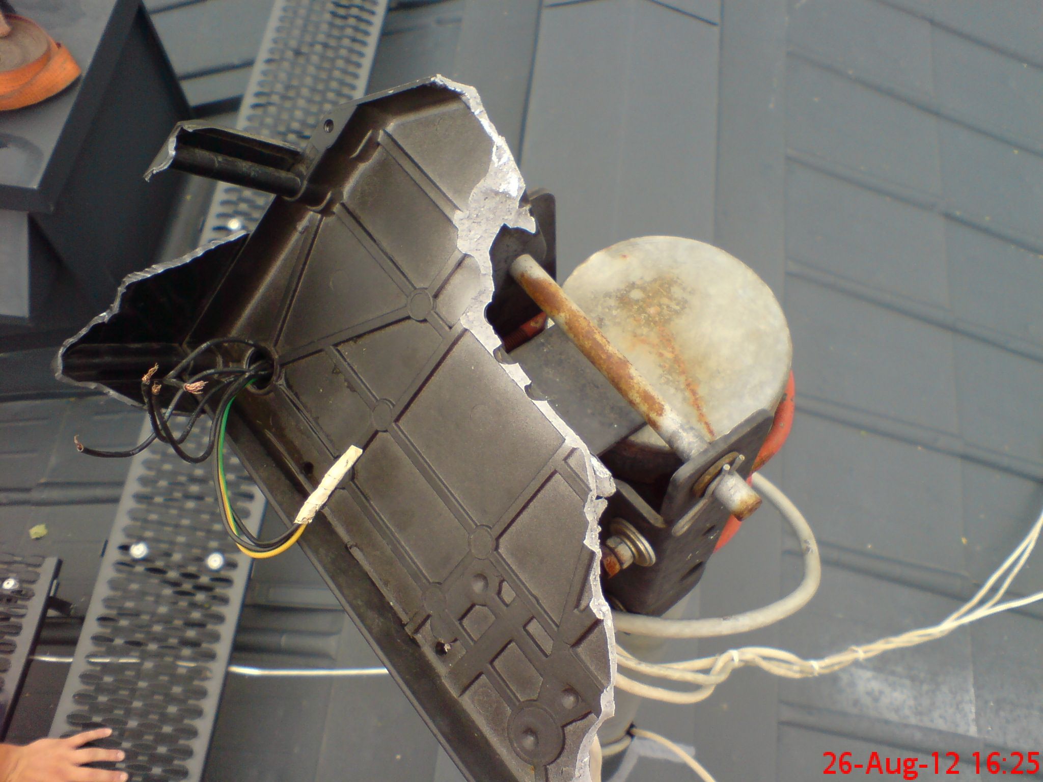

agree with putting reflector on modified polar mount... this safest best solution. RimaNTSS posted this photo to what happened when someone put a 1.8m on a jaeger 1224. catastrophic failure. :eek: DSC02381.jpg
