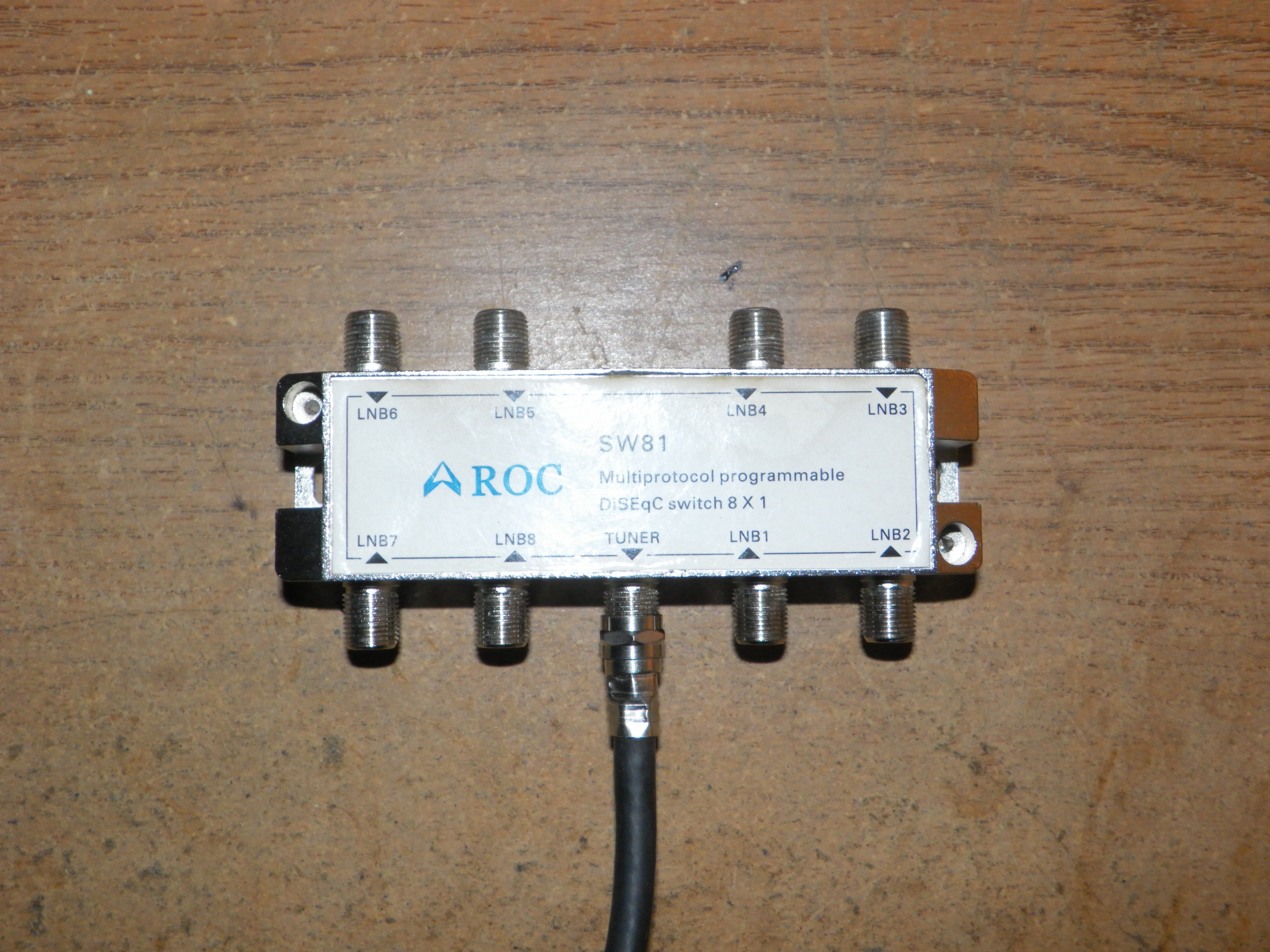

Which 8x1 switch are you using? I am using the Digiwave.
I'm currently using the Digiwave 8x1 switch and it has no problem passing motor power. For 2 years I used a GeosatPro 4x1 Diseqc 1.0 switch , and had no problems passing motor power . Possibly , a heavy dish might create a heat problem in the switch, but my 1.2M Fortec mini-bud, 1.0M and 90cm dishes have not had any switch problems related to motor current. Switches are located indoors , in a controlled environment. If you can get several years of service from a switch, it's paid for itself . :) [edit] The ecoda 22khz switch is rated at 300 ma . My SG-2100 motor has a MAX current ( at highest load, about 35 # dish) of 350 ma. Normal current is 200 ma. Seems like the ecoda is worth trying in your application. :)

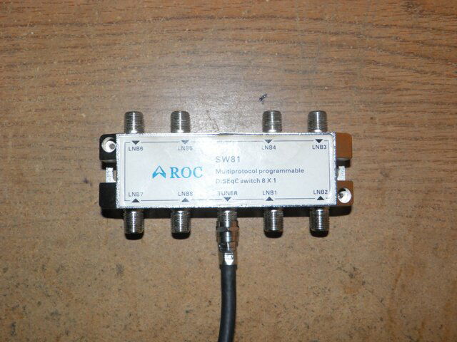

MAYdish 045.JPG AROC? (a Republic of China) One of those household brands LOL
Mine is sun faded so I got to go dig up my spare or search the inet and see what it says about current draw.
