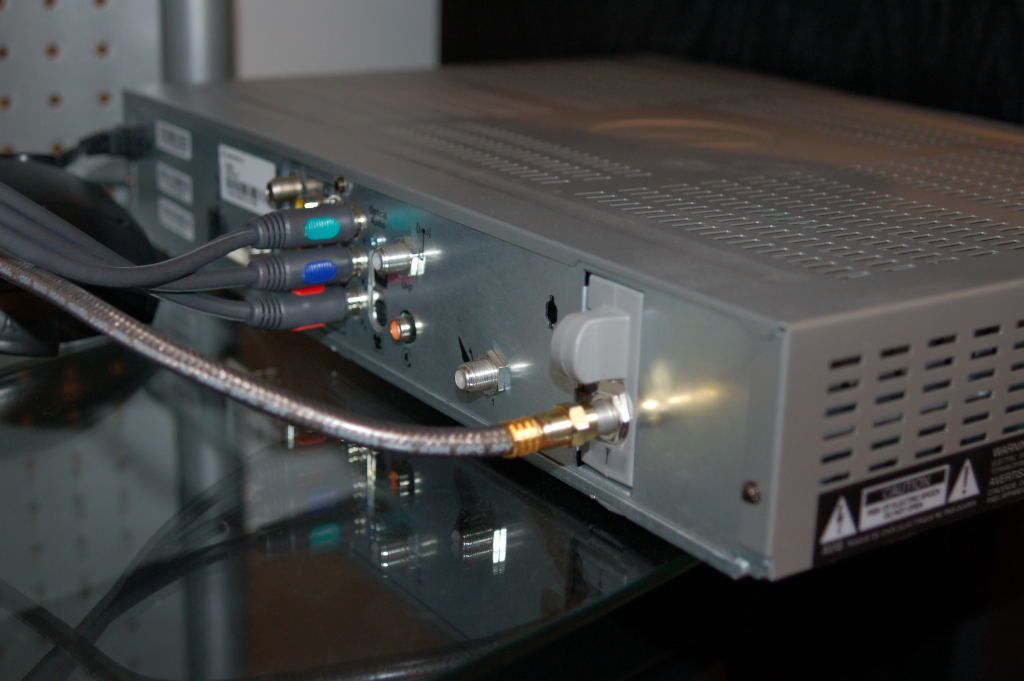

Voom setup
The Voom receiver will pick up ota transmissions. Do you have an antenna setup? If you do, you simply run some rg6 cable from then antenna to the receiver. Then run the rg6 from the receiver to the tv. Better yet, use componet or dvi connecters from the receiver to the tv. Depending on where you are located, you may need a uhf-vhf antenna. Check www.antennaweb.org
