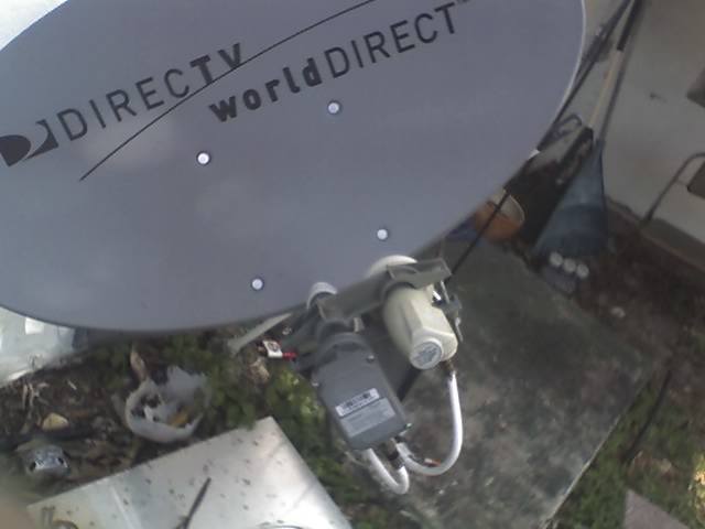

Is it possible to replace the 95 LNB on the DTV Dish with a Dual Linear LNB? Something like this Link ? One port will go to the 6x8 Zinwell switch for DTV and the other will go to a FTA box? is this possible?
DTV International Dish
Is it possible to switch out the 101 Circular LNB to a Linear LNB to receive AMC 4 101 programming? Thanks

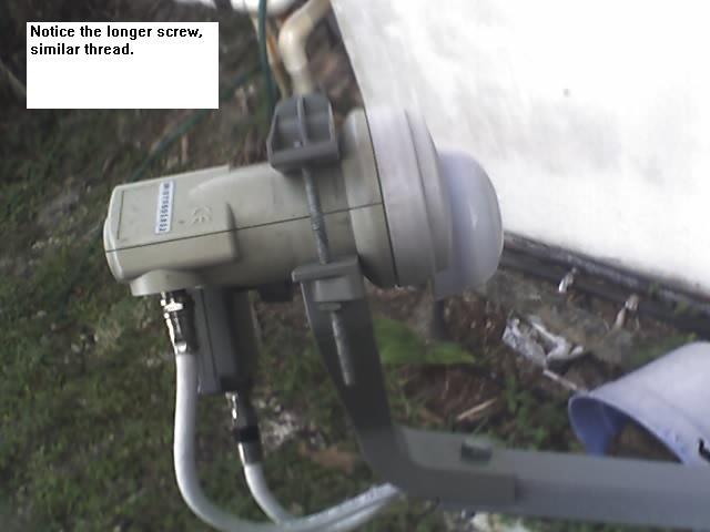

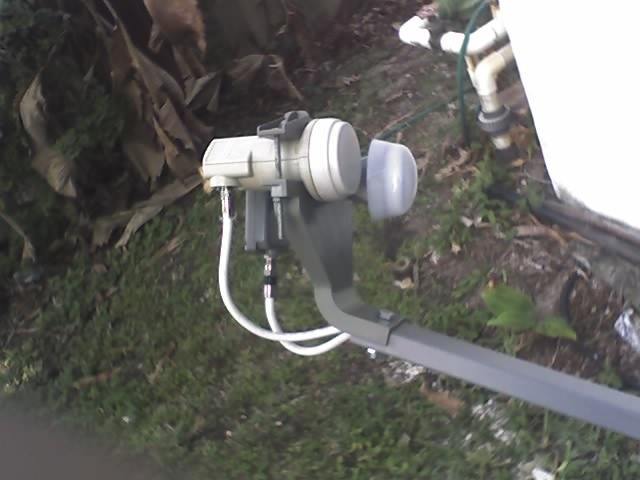

B~Man
remember the long screw you saw in the picture? Gotta use a long one on both ends. If you mount the 95 LNB just right, the c120 flange screws kind of hold it in place. It can be tricky but possible. Must be sure the 95 lnb is tight. May wanna have the dish aimed correctly before the mod.
How long are your screws? I bought 8/32 - 2.5" Length screws......i couldn't get the 95 LNB to be tight...maybe its possible to use 2 of those Eagle Linear LNBS? since they are smaller in in thickness...
can't find my tape measure at the moment, but the best thing to do (if you can't find another eagle sized LNB) is to pre-mod and see how much screw length you will need to hold the larger (new) linear down in place. Go to Home Depot or Lowes and match the threading of the screws and get the length you need.
I just so happened to have a similarly threaded set of screws laying around and I got lucky. Good luck!
