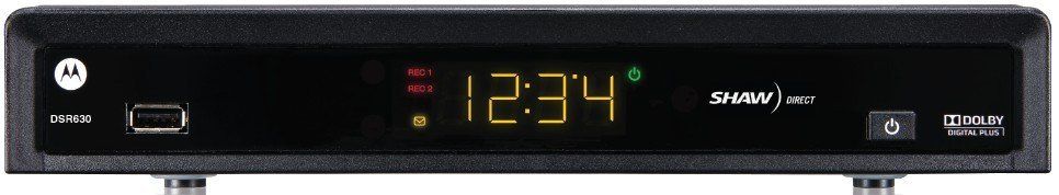

I plan to eventually terminate my Shaw Direct pay TV subscription. After I do, I would like to connect my Motorola HDPVR630 HD receiver/PVR, which I own but was supplied by the pay TV company, to the loop out connector of my FTA receiver so I can use the PVR to record FTA signals. The PVR has the capability to manually enter data (channel, date, time) for programs to record so an EPG is not required to use the record function. I also wanted to use this PVR to record OTA signals as tuned by my HDTV.
The problem is there is only a satellite input connector on the pay TV receiver/PVR, presumably that needs a 950-1450 MHz L-band signal. No A/V or other inputs on the pay TV receiver/PVR at all. I guess there also isn't any OTA video output from the TV either. How would you tune the pay TV receiver since it can only move between pay TV channels with its remote.
Is any of this possible? Or should I just sell the pay TV box and find an OTA receiver with PVR capability, and have a separate FTA PVR and OTA PVR?
As far as I know the pay TV receiver is locked into it's own set of frequencies & mapped in channels, so it wouldn't be possible to use it in this way. It's recording abilities are part of the subscription package. Not sure about a Shaw box, but a Dish/DTV one usually turns into a pretty doorstop without the sat signal from it's provider. :(
I agree (mostly) with you; I see no way forward with this. The recording capability seems to be independent since I can type in the specific data (channel, date, time, length, etc.) necessary for the recording. But the tuning capability seems locked to their channel assignments. Unless...the down-converted pay TV channel frequencies just happen to coincide with discrete down-converted frequencies in the 950~1450 MHz range of regular FTA frequencies. Unlike Dish, Shaw Direct does not operate on DBS frequencies. Their tps are linear and they all lie in the regular FTA band of 11.7 ~ 12.2 GHz. This would suggest that their channels would fall on top of FTA frequencies.
