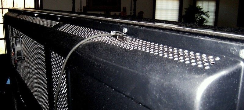

Yup, LCDs are notorious for spurious IR. You can do that or you can get sometime like a HOT LINK PRO [ame="http://www.amazon.com/Link-Remote-Control-Booster-System/dp/B00023JJV6/ref=sr_1_3?ie=UTF8&s=electronics&qid=1261857746&sr=8-3"]Amazon.com: Hot Link Pro Remote Control Booster System: Electronics@@AMEPARAM@@http://ecx.images-amazon.com/images/I/41FENGKB6EL.@@AMEPARAM@@41FENGKB6EL[/ame] which is what I did for my Plasma and my neighbors LCD.

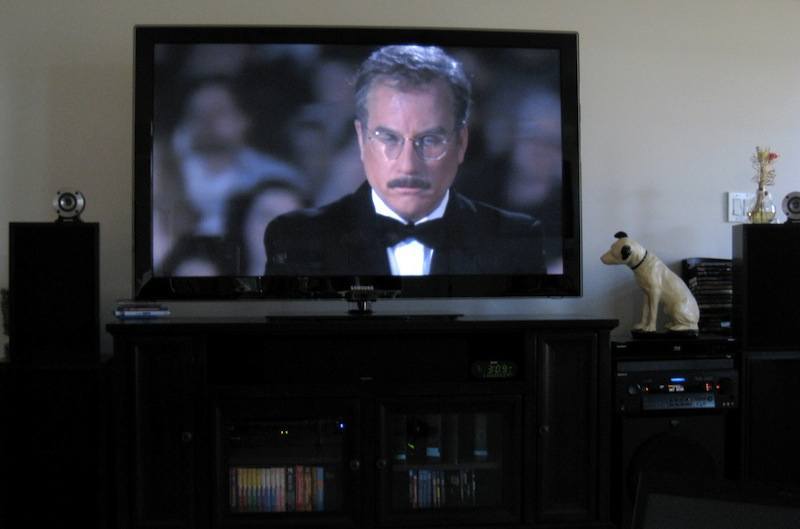

The sensor is so sensitive you can literally hide it behind the TV, books etc and it will pick up valid IR from the Harmony and not see the emitted IR from the TV. Then just run the emitters to your components (I have them on my Sony BluRay, 722K, Receiver, Samsung 63" panel, Apple TV and one left over.
I just point the remote anywhere at the TV or wall and the sensor will pickup the reflected IR off the wall and will not see the direct IR that the TV puts out. See the attached picture.
