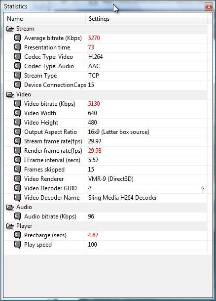

One or two things you can also do.. 1 start the stream .. when the audio is playing, hit the "full screen" arrow to see if the video shows up .. appears to be a DO (Dish Online) glitch ... Another thing you can do.. in windowed mode .. hold down CTRL and left click inside the video window ... this will bring up current specs and maybe something there will show out of whack.. (screen shot below)

Did reboot and still nada on pc for video. Did get the specs but have no clue what they mean.
