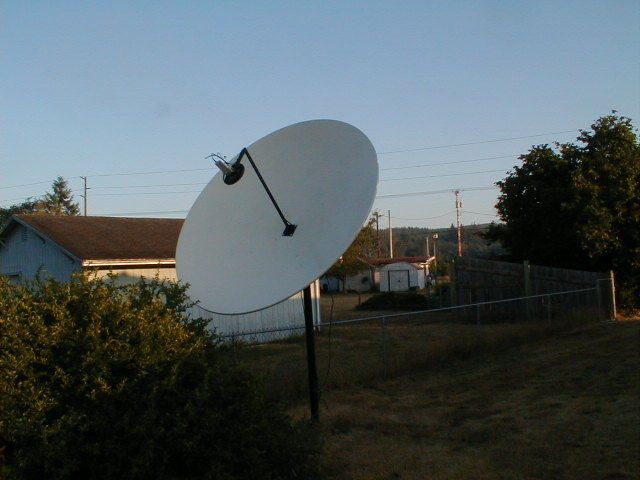

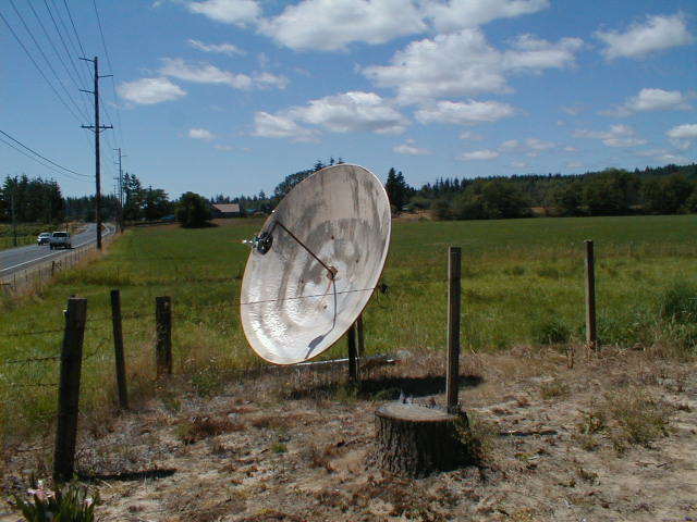

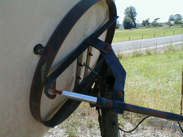

Here are a couple Before/After pictures. :D Note the new paint job.
