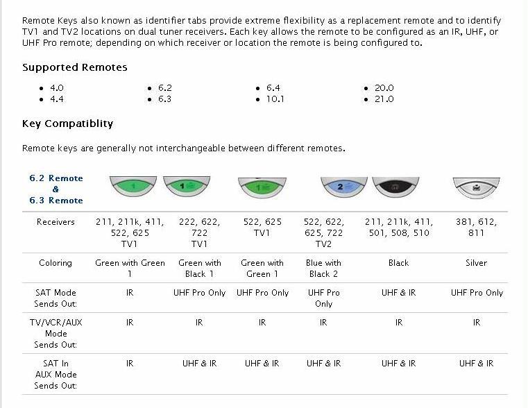

First of all, you need the correct tab/key in the remote
In this case it's the green tab, with the GREEN #1 that says UHF pro next to it (please note there is a tab with a BLACK 1, which you do not want).
On the front of the receiver, or with the old remote press menu-system setup(6)-Installation(1)-TV1 UHF Pro Setup(6)
Make sure the feature is enabled, then from the same screen select the "system info" option on the right.
On the system info screen, you will need to use the front panel buttons (arrows) on the receiver to highlight TV1's remote address (located in field i, it will be orange when it's highlighted). When the remote address is highlighted, press the record button 3 times on the UHF remote (the 6.3 you just received) and ideally the remote should now work TV1 as UHF. Note: The receiver will not let the primary and secondary remote addresses be the same number, so you may need to change it (hold sat til all lights flash, press a number 1-15 on the keypad, then press #), then press record 3 times again.
Hope this does the trick, and also that I didn't forget anything (don't think I did).

Thank you all for your advice! I do have a question for MattG. The remote I received has a blue and a black side. The Blue side has a 2 and UHF Pro on it. The Black side just has UHF with what resembles a rainbow over it (just lines in the plastic, no colors) going from the U to the F if that makes sense. I don't have a green side and I don't have a side with #1. The number on the back of the remote is 140077. I'm not sure what that number is but assume it means something otherwise it wouldn't be there. There is either an 8 or a B on the black side of the little tab that gets inserted into the remote. That's all I can find.
Where did you get the remote from? When it's ordered from DISH directly, it should come with all of the tabs/keys so that you can put the needed one in.
If you can not find the #1 UHF tab, you can program the remote with the #2 side it with the steps I posted above. Just make sure you change the primary remote's address by highlighting it before hitting record. Once you get it programmed, I would mark it or something so you don't get both of your remotes confused.

The only duo dvrs are the 522, 625, 622, 722, 722k, and 922 only the first two are sd
Sent from my EVO using SatelliteGuys
You're right Matt...I tried to save a few bucks and bought it off Amazon.com ( Amazon.com: DISH Network 6.4 UHF PRO Remote: Electronics ) The one in the picture appears to be the exact model I have based on the black 2 on the blue tab. I am thinking of switching receivers (my current account in ex-wife's name). Is there a better receiver that would allow UHF control of TV1 and TV2 and also have DVR capability? HD not a big concern now, but could be in the future.
I had 522 rcvr's in my account, and I have setup 625 rcvr's for others. These are SD boxes but you can set both TV1 and TV2 to work with a 6.0 or 6.3, 6.4 remotes with a blue 2 tab. One remote will work both TV1 & 2 just by setting the address of the primary (TV1) and secondary (TV2) to different numbers. TV 1 has to be enabled for UHF first. Then just change the remote address for the TV output you want to use.
The newer HD receivers require separate remotes for TV 1 and 2. You could use one 6.3 or 6.4 remote but you would have to change the tab at the bottom. That's a PITA though. The 21.0 remotes that come with the 722 are a bit more expensive and I find it easier to have a black 21.0 remote for TV1 and a silver 6.3 remote for TV2, a bit less confusing for others in the household. The 922 remotes are a different animal all together.
