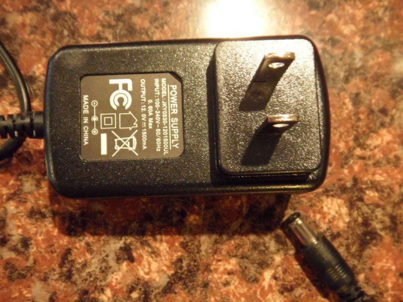

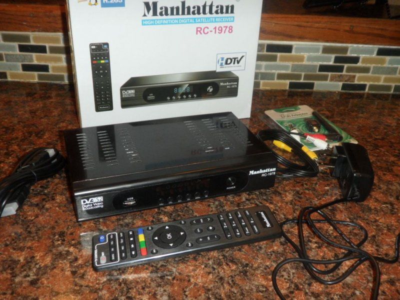

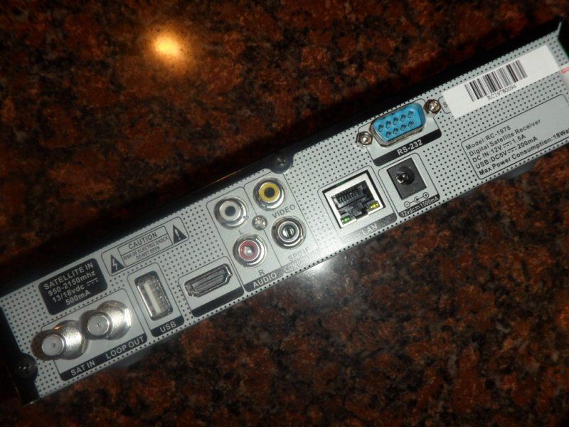

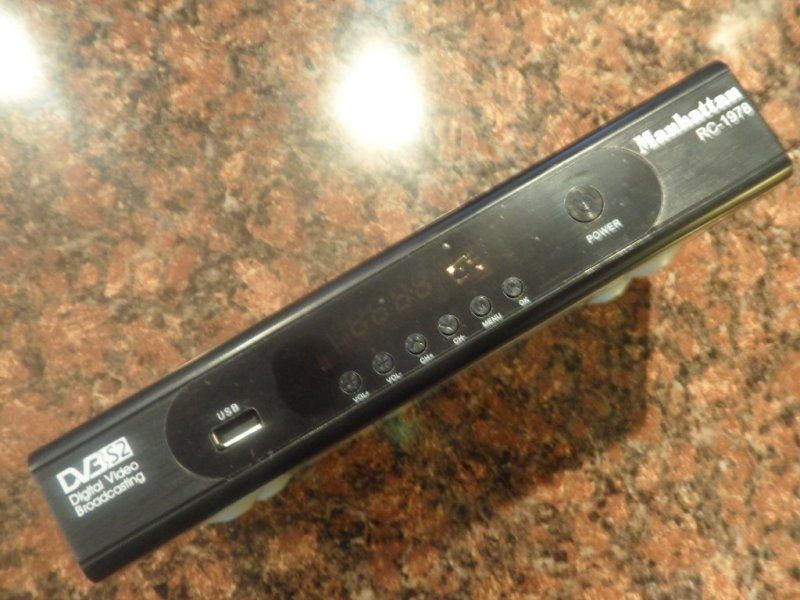

Receiver with power supply, HDMI cable, RCA cable, wireless adapter and box.
Hooked up the RC-1978 to the TV and coax. Current setup is a motorized C-band dish (w/ ASC-1), a motorized Ku (HH-120) and two fixed Ku all through an 8-port Amiko switch.

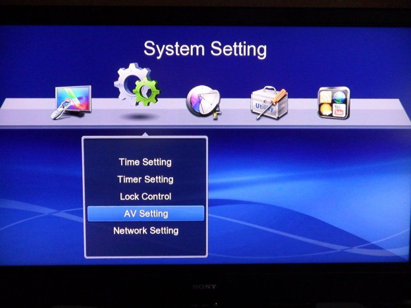

Setup screen whenever 'Menu' button is pushed on remote control

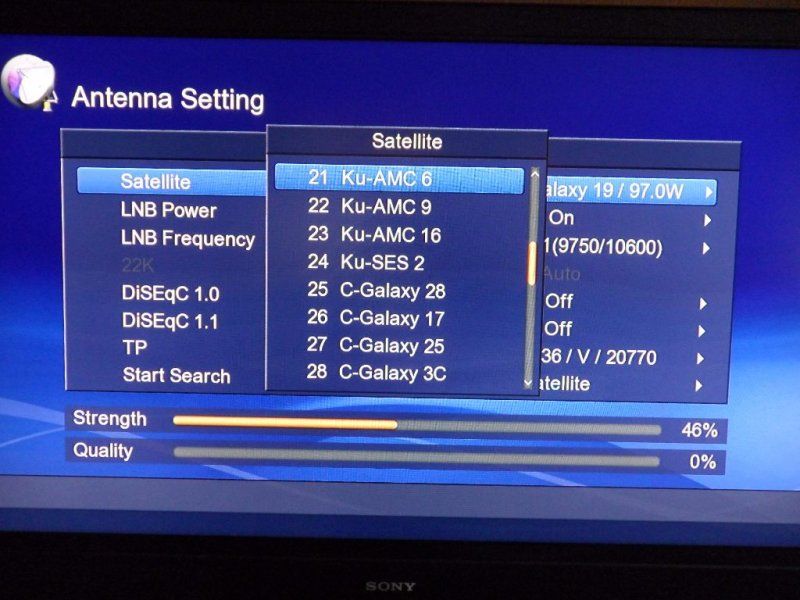

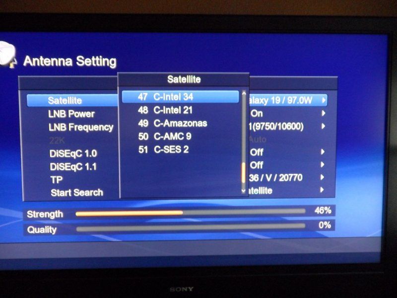

Setting up and scanning satellites was fairly intuitive and similar to other receivers. Most C-band satellites were programmed in, but had to add a few. The display screen for selecting satellites had names and not positions. That got corrected later...

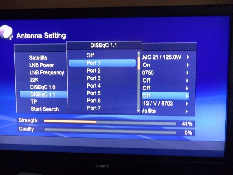

Within the satellite setup screen, LO and diseqc switch options can be selected.

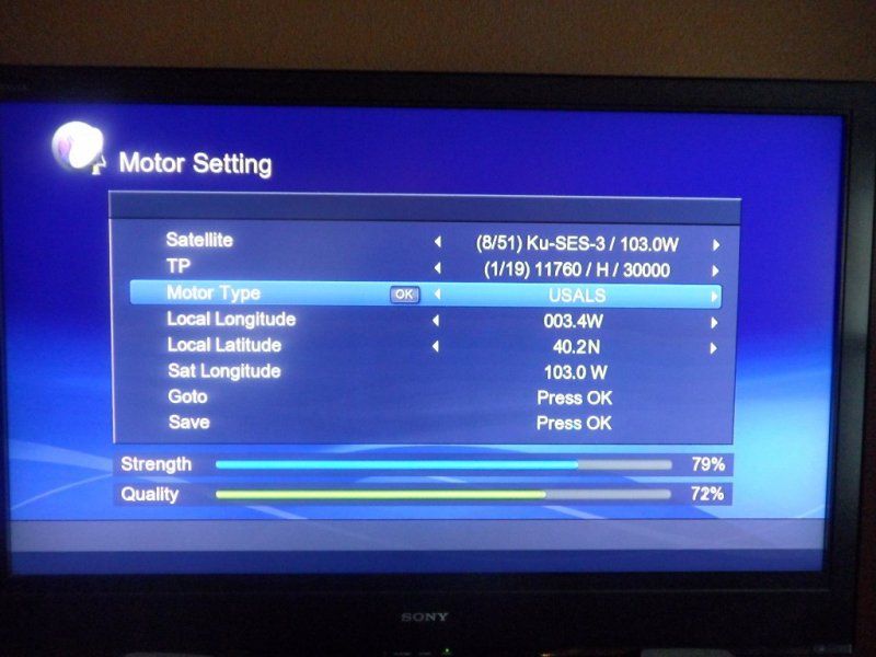

Within the motor setup screen, each satellite can be setup for motor operation with USALS or Diseqc optional. Input USALS for one satellite and it populates the remaining sats that are selected for USALS operation.

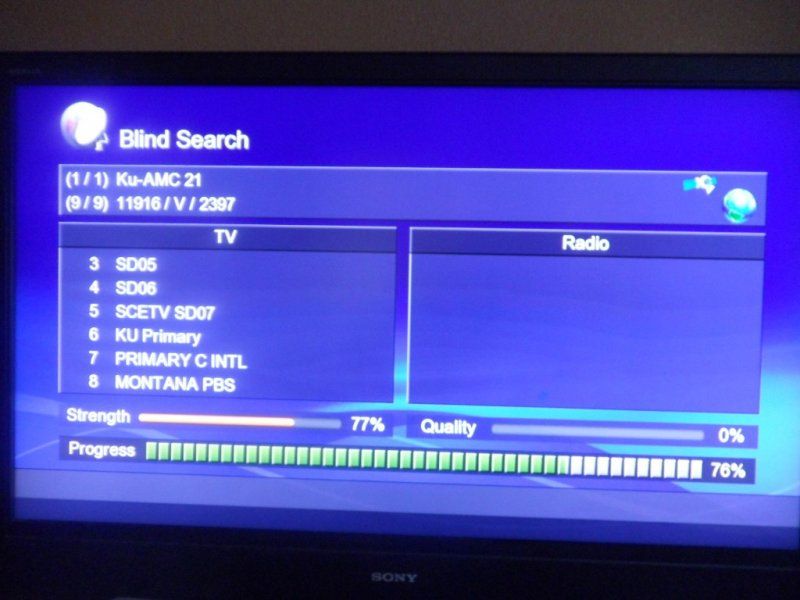

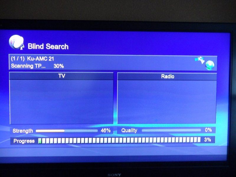

There is an option for Satellite, TP or Blind search; NIT is an option on the former two. Blind scans were performed initially. I didn't time the scans, but they didn't seem extraordinarily long. Most were within a few minutes time.

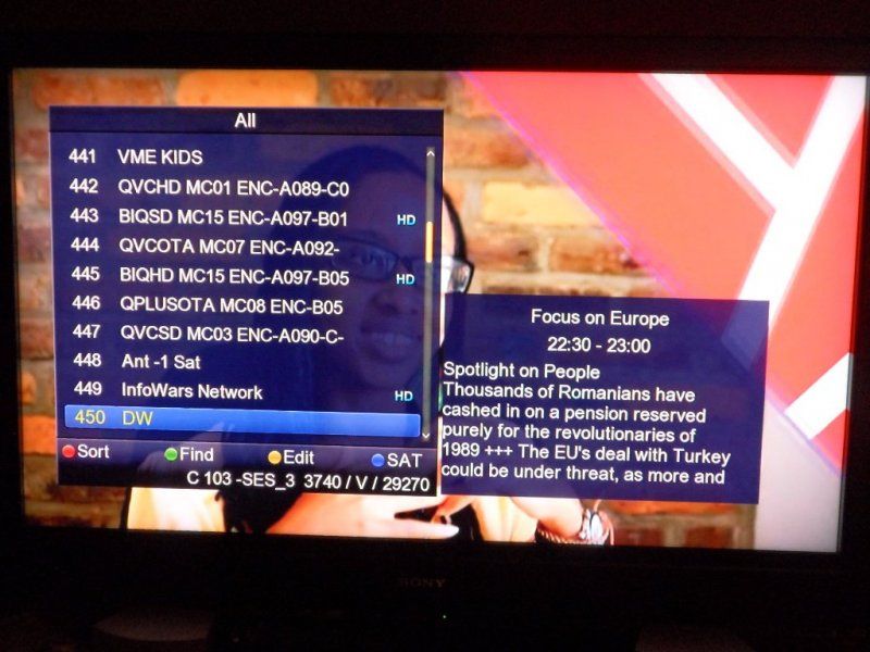

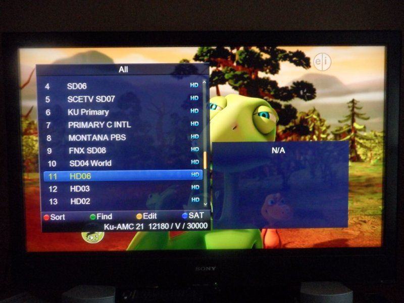

Viewing channels, press 'OK' button in center of remote and brings up screens as above. There is an option in the setup menus to set opacity of these screens.

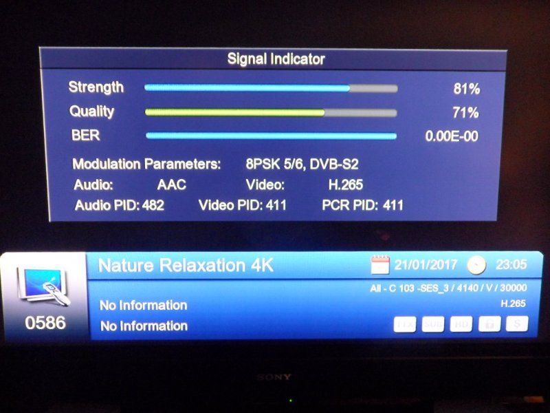

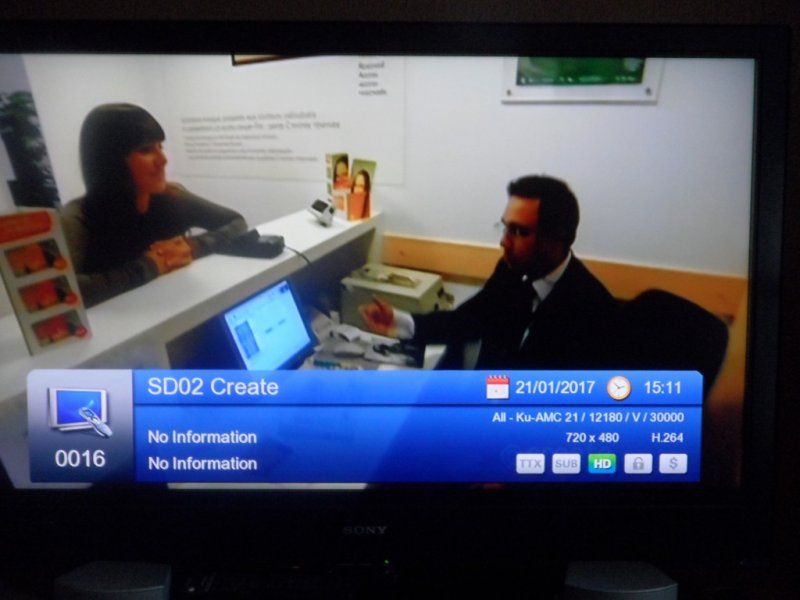

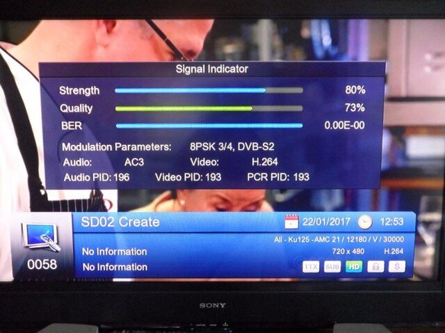

Press 'Info' once and screen in first photo comes up with transponder information, resolution, etc. Twice shows Strength, Quality, BER, pids and more.

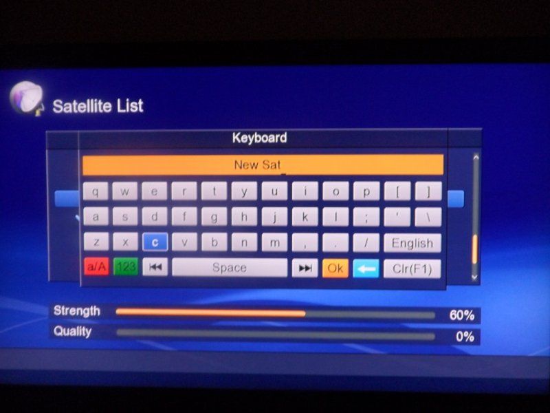

This is the interface keyboard for adding/changing satellite names, changing channel names, etc.

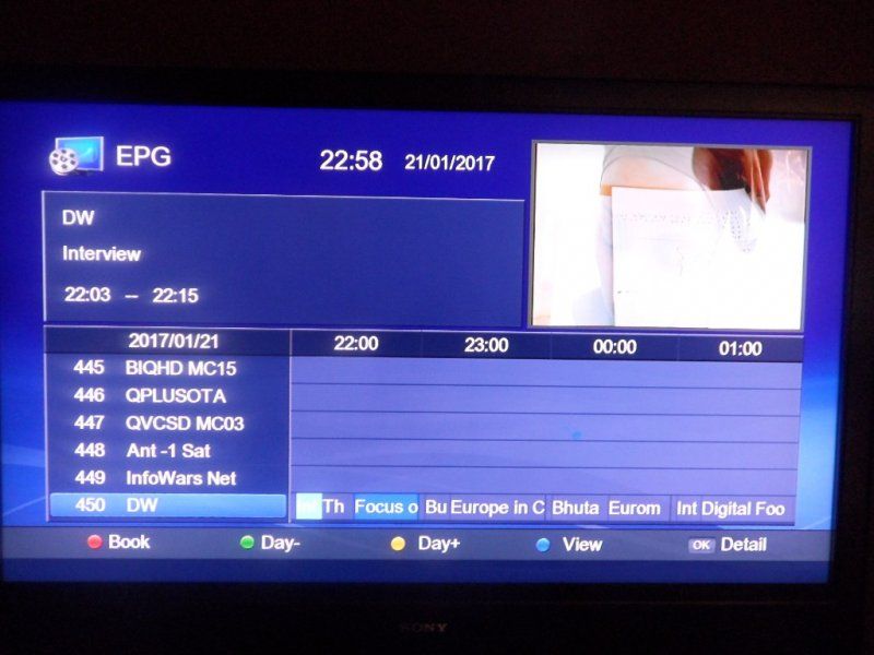

View of EPG and program guide display information.

The audio and video with PBS mux on 125W-Ku were very good. No issues were noted here. Last night on 101W-C, there was some stuttering observed on the culprit channels.

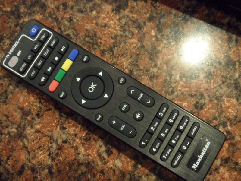

The main stumbling block for me is there is not a 'SAT' button on the remote. I'm trying to figure out the best way to go from one sat to the next without scrolling through the menu of all channels. There is a 'FAV' list and entering channels is intuitive. However, upon opening the FAV list a command issues to go to whatever channel was highlighted and send the dish off to an undesired position.
