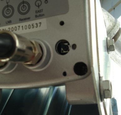

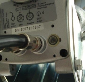

0k, now were getting somewhere, my manual states to push the reset button... as you can see by the attached photo I dont have one. I will try the push both, power off, power on and see if it works.

The reset button is inside of that small hole just to the right of your LED. It is partially covered (as I suspected it might be, mine is) in your first picture by the LED cover. In the second picture (without the LED cover), it is exposed. Push a paperclip into that hole to reset the motor. The LED will blink orange and green alternately. Hold the clip until it is fully green again, then release the reset button.
Look closely at the pictures.
In the first image, look at the label above the holes.
The large round hole is labeled East button, with the LED to the right of it.
In the 2nd picture without the cover, you can see the East switch at the bottom of the large hole.
I think the small hole to the right is just the LED...
This is clearly the 2-button model.
I've never seen it reported that they had a 3rd switch for reset...
...but ya never know. :rolleyes:
I have an earlier generation around here somewhere with the single button and the reset switch hidden under the LED cover as Tron described.
It's a whole 'nother animal. :)
Will see if I can get a close-up picture of it this afternoon.

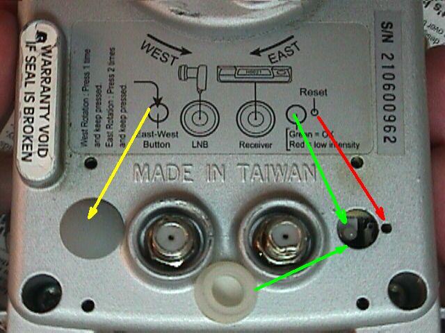

older SG-2100
Okay, here is a picture of a classic (older) SG-2100 motor.
This is the one everybody knows and talks about.
Yellow: the gray rubber cover is the East/West button.
Green: translucent cover fits over the LED (see the LED down inside?), and partly covers the reset hole.
Red : toothpick actuates the reset switch.
The -new- SG-2100's don't look like this... they look like the pix posted above by OCGW.
Read his label to see the differences.
Yes, they have used the same case, with the same holes, but the guts behind the metal are different.
Looks like the casing is identical, they only changed the guts :) Wonder if a reset can be activated using the paperclip-hole technique on the newer model... I've heard they can be a bear to reset, glad both of mine are the classic version :up
