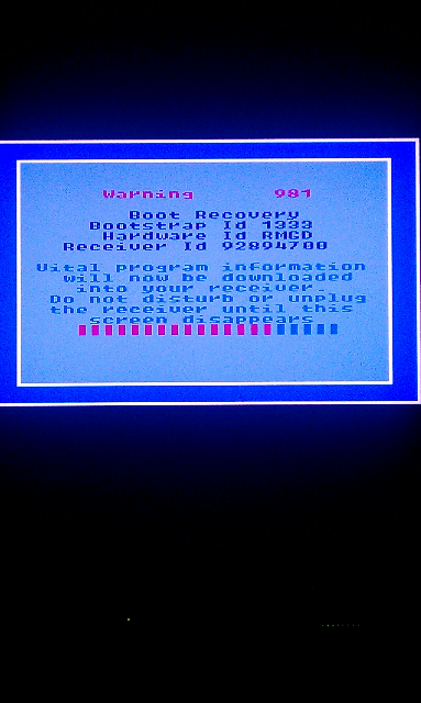

When it started going nuts and rebooting every few minutes, I unplugged it, let it sit for about 20 minutes, then plugged it back in.
It got the Warning 981 error and downloaded software. Then it went through the "Starting up..." screen numerous times, with the TV1 LED on sometimes, sometimes not, then the Mode LED on sometimes, sometimes not... eventually, it came up... somewhere around 30 minutes of it restarting like that.

Sorry oldave, but it's dead. This has been happening with 722ks for the last month. Mine did it on November 13th (ironically my birthday) what you saw was this:

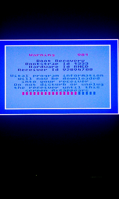

Right, that's what I saw, but it got beyond that, on to the Dish logo and "Starting up..." screen. Then, it restarted from there numerous times, and finally came back up and I was able to watch TV... for 27 minutes.
Now it's stuck in a reboot loop, and eventually gets to this:
It did that about 2 this afternoon, and we went to town, had dinner, came back - 4 hours later, it was still stuck there.
(edit to add): Pressing reset puts it back in the reboot loop, until it finally starts flashing all the LEDs again.
I'd say it's well and truly dead.
