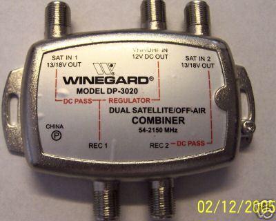

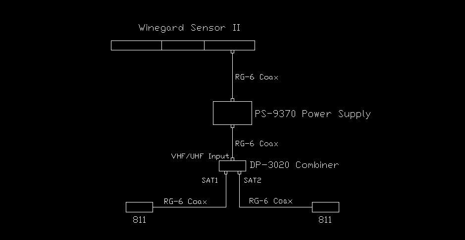

I am not familiar with E* installation. What is that DP-3020 combiner for in the left-side diagram?
The picture on the right seems to be ok, but the one on the left may not work if the DP-3020 blocks AC voltage from PS-9370 to the antenna.

There is no need to spend lots of money on the power inserter for your powered sensar. I have converted many voom installs to Dish using the standard diplexor method.
The key is to use a standard diplexor only behind the receiver, and then to use a 2ghz power passing splitter outside instead of the diplexor.
You need a splitter that passes dc power on both ports and is rated up to the dishpro frequencies. This then uses the dish receivers LNB power at 18volts to power the sensar. I have had some of these inplace since well before voom went boom, and have yet to have a sensar die from the extra DC voltage.
