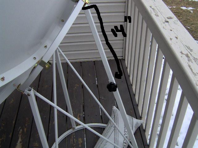

It's going to use the stock AZ EL mount since it will be fixed on W5. Are there adjustments on the feed legs to set the focal distance and F/D ratio?
not really. Its all trial and error
The elevation slide bar has no numbers so what I did (again yours being fixed makes this moot) but I found true south and marked the elevation slide bar with a notch. Went to 137 and put a notch there. Put a couple for 121 and 72 so I can quickly access
Being in IL you have a good amount of sats at or near the same elevation...you might want to try if you have an analog box nearby to get Shepherds Chapel on G4/16 first then go from there.
I'd measure the arm on mine but after the dish fell off the table I got new braces on it and they were a little shorter so the dish sits back farther (and the number would be off)
duh! I have another dish that is different (and stock model) and probably would be the same as what you got
I measured from the top of the bolt to where the pieces come together and its 14"
That dish is on 99W which for me is at 38.1 elevation in Minneapolis. I used Chicago and 105W and its 38.5 elevation so its very close
