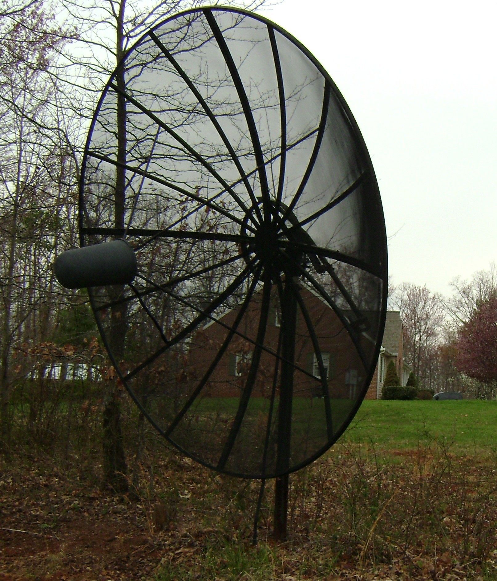

We are dismantling the big dish. Do you want it? Otherwise, could use some advice taking it down.
We inherited with the house 9 years ago. Was fun for awhile, esp. NASA channel and wild feeds. But a windstorm broke something on it, and you can see where it is pointing...perhaps at a satellite in geostationary orbit over China.

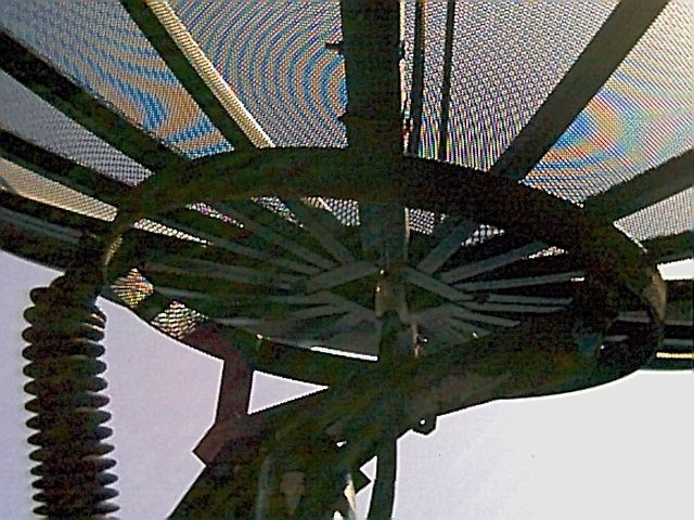

I took a picture of my dish just to point out the obvious what would happen if I took out the two jack bolts first the dish and not resting it on the pole, it would drop and kill me knocking me off my ladder. Mine is easy twenty feet up and through the outside corner of my deck, ouch! Also do not do it on a windy day.
i would agree with Anole a few pics of the backside and motor would help. to me from the picture shown it looks like an over extended actuator. might not have anything broke so it could be an easy fix.
I would love to have it, but (even if I was driving that far,) pulling a trailer to bring it home would be too expensive. We would much rather see you get it working again! I will not been heading East again until November, and I am not planning to go back that far North on the East coast..... But there is probably someone a whole lot closer that could come over if this forum can not talk you through it! Unless a bracket broke, there is not much of anything that can not be fixed rather easily!
Looks like the actuator arm is bent. Seems if you look close enough you can see it arc just to the top right of the mount.
Sure wish I could get it. It looks like a 12 foot dish.
Biggest I've found around here are 10 footers.

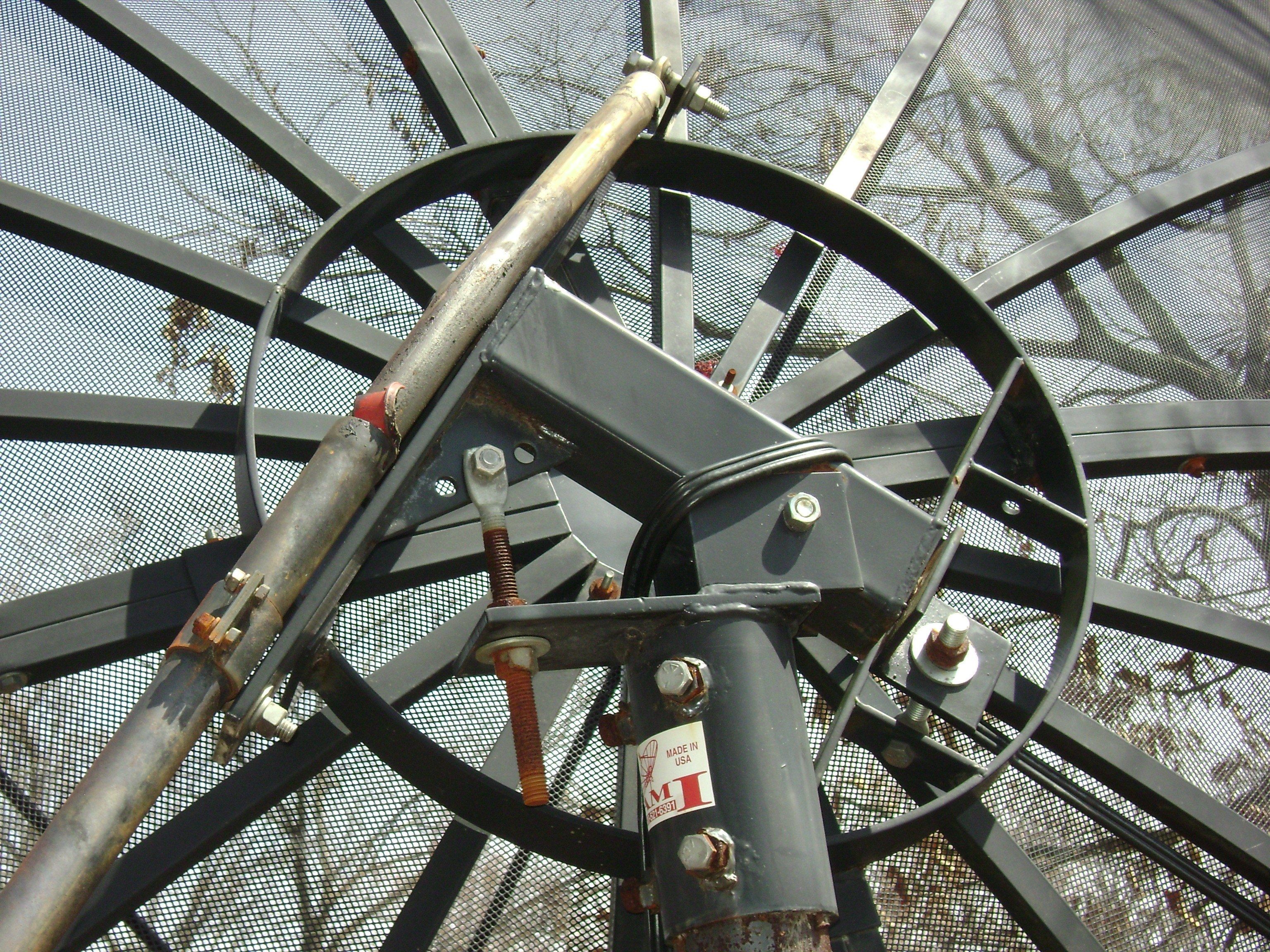

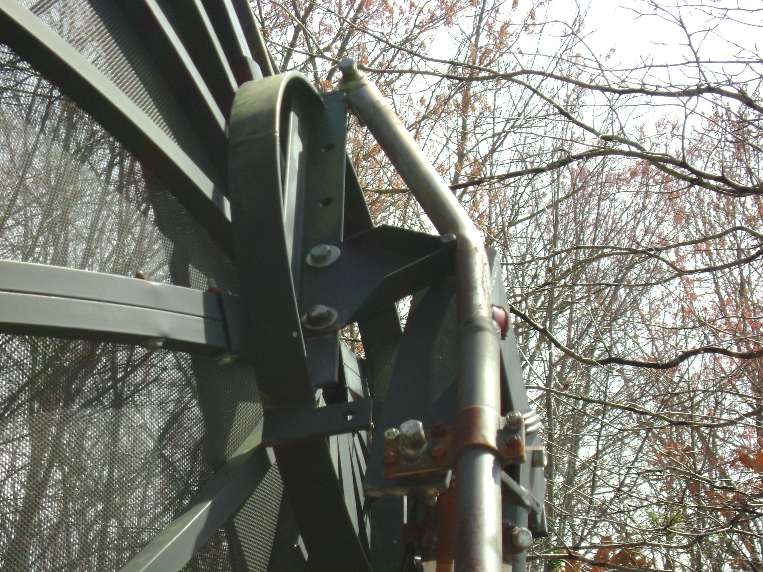

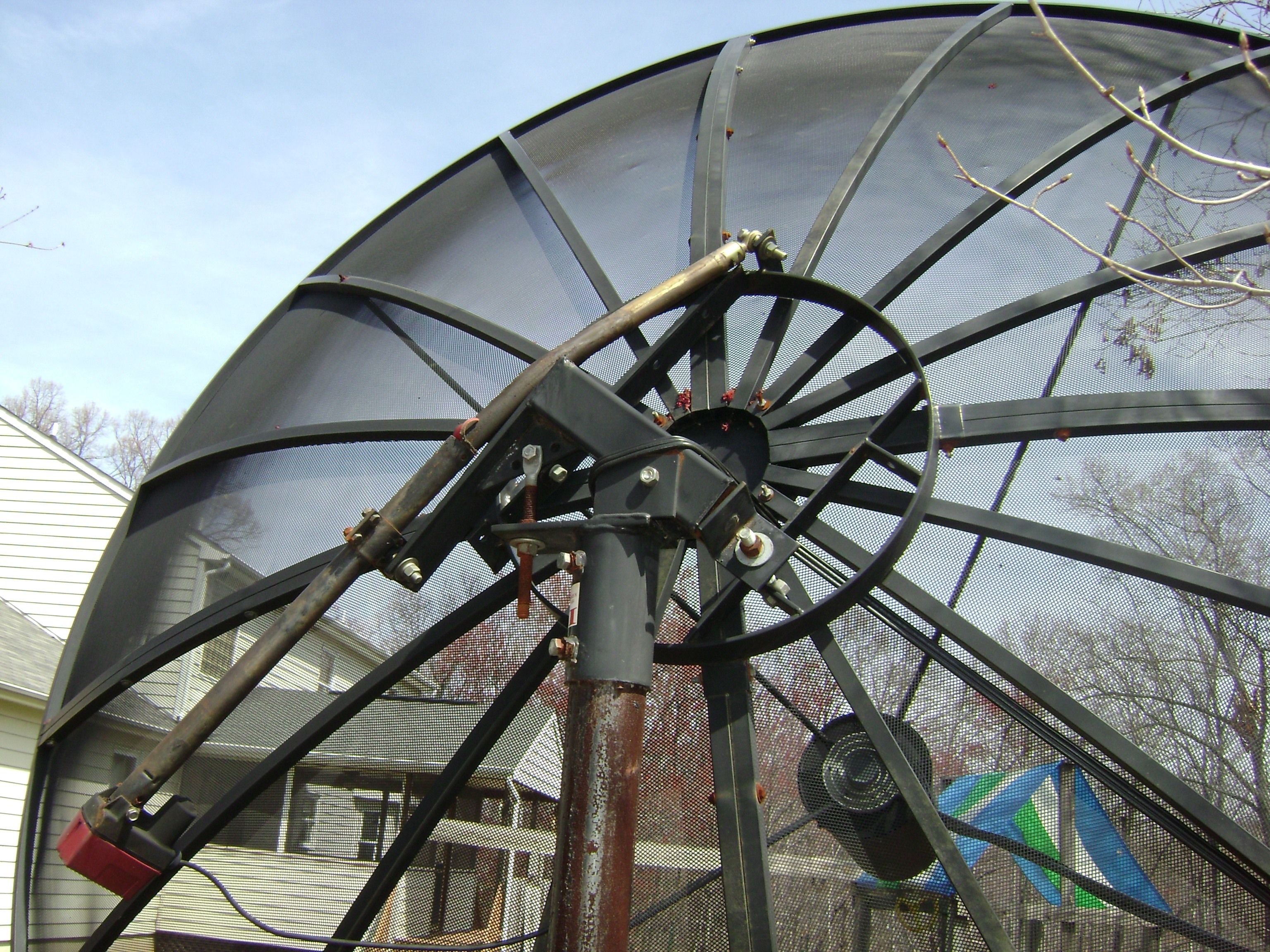

Thanks for your responses so far, you all do seem like a good group. Here are pix of the backside my son took while I was out today, hopefully it catches the relevant parts. I started on the hobby for a few years until work and kids swamped me. We are probably moving soon so I would rather someone from a group like this take it than have to take it down as part of the sale. On the other hand, I hate to see it go!
nice pix
Wow, as rust goes, that's in quite good shape.
The third picture shows the perf surface pretty well, too.
Just a few hail dings.
Not sure the exact size, but does the label say: SAMI ?
Looks like the motor is broken.
I assume it would need a new one - :confused:
Hope you can find someone in the area who'll appreciate it and give it a nice restoration.
If I was within a hundred miles, I'd rent a trailer and drive right over with my wrenches. - :cool:
It is a nice dish.
Nothing broken that I can see except for the actuator. That could be fixed in a few minutes with a new one.
