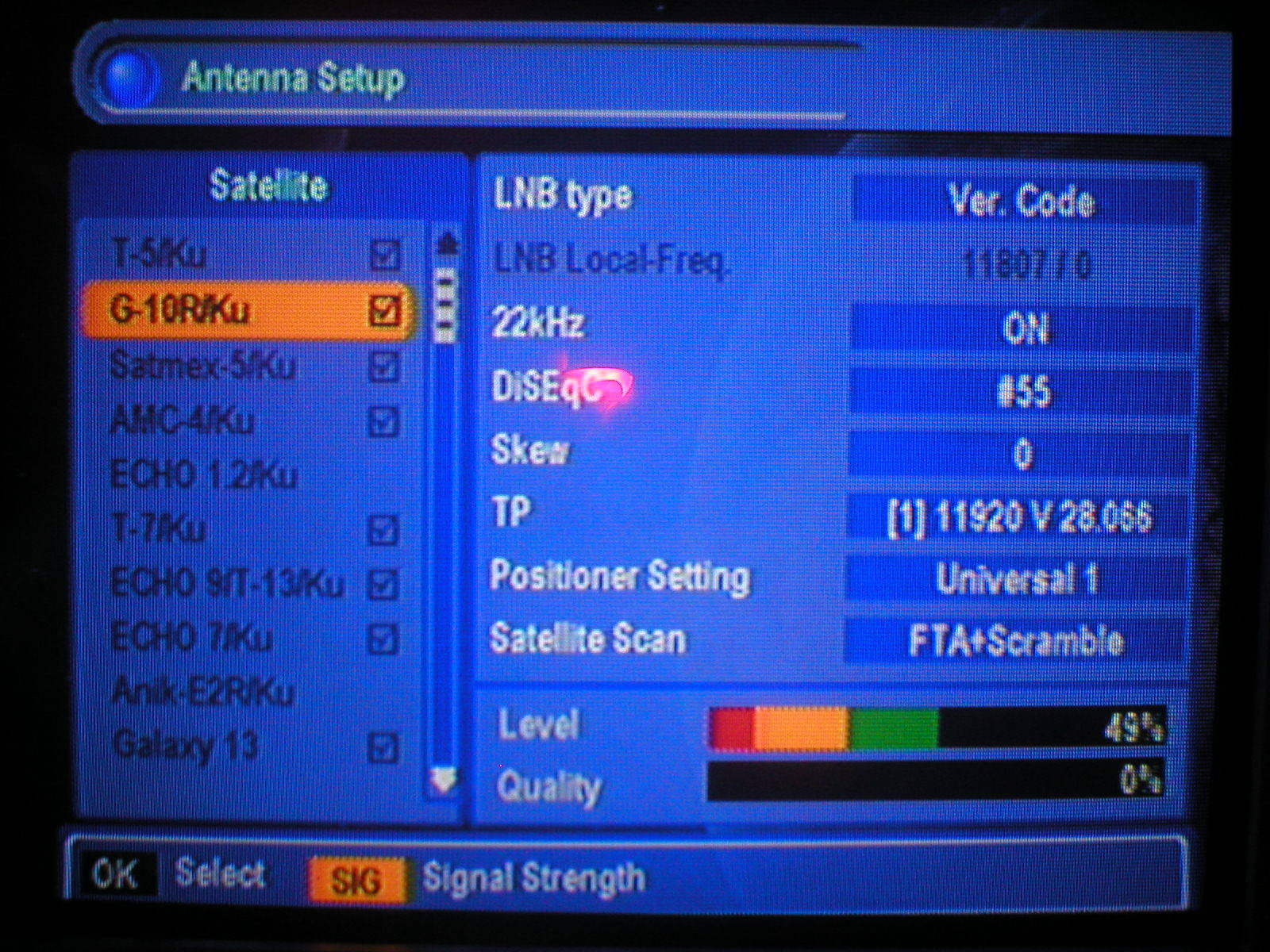

I have a Pansat 2500a and after doing a blind scan some of my settings in the antenna setup get changed. It changes my LNB type, Diseqc, Skew and Positioner Setting. See attached. Has anybody else seen anything like this? I may do a master re-set to see if that helps.

It sounds like you have too many tp's scanned in. try deleting all but one tp per sat and see if that helps. Also, if you have ever had a scan interrupted during the "save" phase, that could cause the same problem. Only fix for that is a factory reset ( i just had to do this on my pansat 2700 last week).
Thanks. I will remove most transponders...
