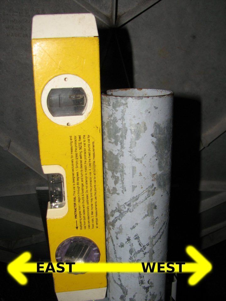

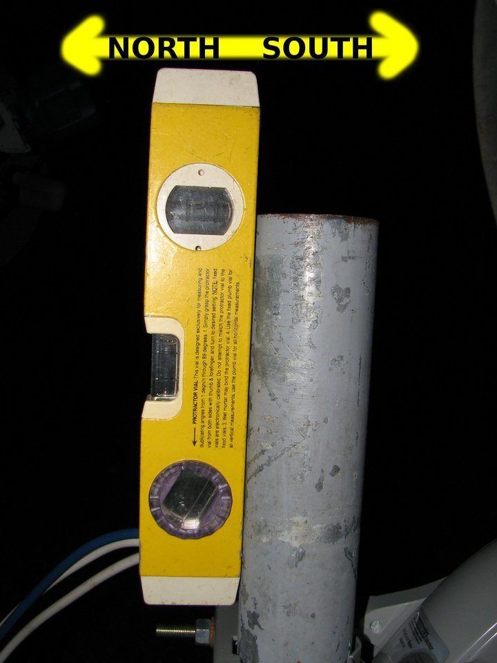

For a few weeks now I've been stumped as to why my ku motorized dish would only see between 83w and 103w. Anything else, NOPE........
So tonight it was COOL out. It's the time of year where we finally begin to get little tastes of fall like weather now and then.
So I decide to go see what's up with my stuff. For days now the dedicated dish on 123w has been MIA. No signal, nothing. Hmmmmm... :(
And the motorized dish as well.
So I pack up my new S10 tuner and assorted tools and head out to the back yard.
I put the S10 on the 1.2m dish and BOOM! FSTV is there loud and clear.. :confused:
So at that point I am assuming the 22k Ecoda switch has gone bad. :(
Then I go over to the motor and put the tuner on it. I go to the menu and tell the motor to move to 125. It moves but no signal. :(
Basically, I spend an hour loosening everything up and wiggling everything around, tipping the dish up and down, you name it. Still can't find 125w. :(
So I tell the tuner to put the dish to zero. I look on dishpointer.com for true south. I check the motor and it is indeed pointing to true south as best as it possibly can. Google has a very high resolution picture of my backyard (They take new pictures after every hurricane) and you can see not only the individual dishes but can even see the LNB's on them! So once I was sure I had the motor pointed the right way I got a square piece of metal and put it against the side of the motor and the back of the dish mounting plate so that I know with 100% absolute certainty that the dish is aligned properly with the motor.
And being that I made this dish from spare parts left over from other dishes, it's a Frankenghetto dish all the way. :eek:
Back and forth, back and forth. I also discovered that some of the satellites had their coordinates in backwards, for instance 85 and 79 were reversed, if I selected 79 it would go to 85 and 85 would take me to 79. Huh? How did that get in there??
Finally I was ready to admit defeat, again, when it dawned on me at 2am in the morning sitting outside on a stool in the dark to check the level of the pole. DUH......... I go get a level and TADA!! Ms. Dumby discovers she went to school without her thinking cap, again!
So yeah, the pole is waaaaay off from east to west, it tips a lot to the east and a bit to the north as well. The bubble is all the way to the side, it's not even remotely close to being in the middle of the lines. With the pole all cattawhampus like that I can see why it's not working right!
This darn drought has dried up the ground so badly so I guess that's what's going on.
There's not a lot I can do about it tonight but tomorrow I'm going to Lowe's to get gardening supplies and I'll pick up a new pole and cement. The pole that's there now is in a bad spot and it's too short. I bolted some goofy rig onto it that I found on the side of the garage to make it taller and I really don't think it's the right answer. So a new pole would be best. I'll dig it deeper and put more cement and maybe that will help with the drought. Maybe if I plant it while the ground is all dried up it may hold tight since the ground is already shrunk up as much as it can be.
Oh and tomorrow my dad is going to put a new power cord on my S10 and a fan. He found an itty-bitty fan on an old mainboard from an old pc (packrat is the family middle name).. I'm hoping that will cure the heat problems.
If I can get the kooky pole problem fixed so that I can tune in ALL the satellites, I will be so much more happy with things. My pc will not get the LPBS channels at all so that leaves it to the S10 to pick up the slack. Adding in the C-band 87w will also make me a a happy girl too, then I can record several things off 87 at the same time or record one, watch another.
With fall coming those stupid trash trees will defoliate soon and I should be able to pick up HOT TV. I just don't understand how the big dishes can't see 118 (HOT) but my smaller dishes right next to them can see 123 and 125 just fine? :confused: Can just a few feet make that much difference? I guess it can but it really messes with my head. All I know is, those trees have to come down. One way or another. They are only there because birds sat on the fence and pooped seeds and previous property owners were too lazy to take them down when it would have been very easy. Idiots..
Oh well. I'm getting closer now to getting things ironed out..

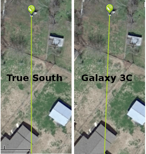

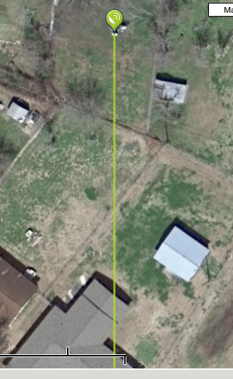

Well now I'm stumped... :(
I went out there and I hammered sticks in around the cement and I got the pole VERY level and it's tight. No wiggling at all. I checked the level on it on all four points of the compass and the bubble is perfectly centered between the lines. Not sort of centered, I mean truly, absolutely centered. The pole is level and sturdy now.
Then I used dishpointer.com to aim the motor at true south as best as I could. Google has very hi-res photos of my yard and dishes (as they were the last time they flew over) so it is extremely easy to select individual dishes or the spot where new ones are now that weren't there when they took the photo.
It draws a line from the dish to true south and I can see that it lines up just a smidge over from the peak of my neighbor's roof. So I aim the motor to that point.
So, I get everything between 72w and 103w and then, nothing. From 103w on, there is no signal at all. I have other dishes within a few feet of this one that are aimed at 123 and 125 without any problems.
I've verified that the GPS coordinates are set precisely in the tuner for the USALS. I have an iPhone and a GPS thingie for my car that I can carry out there and they jive with each other. Plus I can drop a "lat/long marker" on google maps that's 1000x more detailed. I looked up the instructions for the motor and I set the motor tilt according to what the manual says to do.
The motor and the dish are square to one another in the zero position. I don't know if that's the right terminology to describe it.
I checked the dish settings in the tuner and they are all set correctly. Originally I found a few satellites that were flipped, like 89 was flipped with 72, or something like that. I double checked them all and they are all set correctly.
When I tell the dish to use "accurate scan" on ALL the satellites, it starts at 72 and scans everything west of that, one at a time. It finds everything up to 103 then from there on, it's all a dead zone. The dish does move but it finds nothing at all. :confused:
It can't be trees because I used this same pole to put my parents dish and motor on when I set it up here. Using their dish I could see everything from 72w to 125w and in between. And this dish is larger than theirs. I'm using a true 1m Primestar dish, my old "Lawnchair dish". I guess it's an Andrew or Raven or whoever they are this month, whatever..
I just can not understand why it won't see anything west of 103w....... :confused:
Can you guys throw some suggestions at me please? I don't know what I'm doing wrong or what step I'm missing.
I do have to say though that this is a true Frankenghetto dish, I robbed parts from other dishes and the junk box to put this one together. So, like the mount on the back, there are no markings you can set it by like you can with a store bought dish that was designed to be mounted to a motor.
Thanks guys! :)
