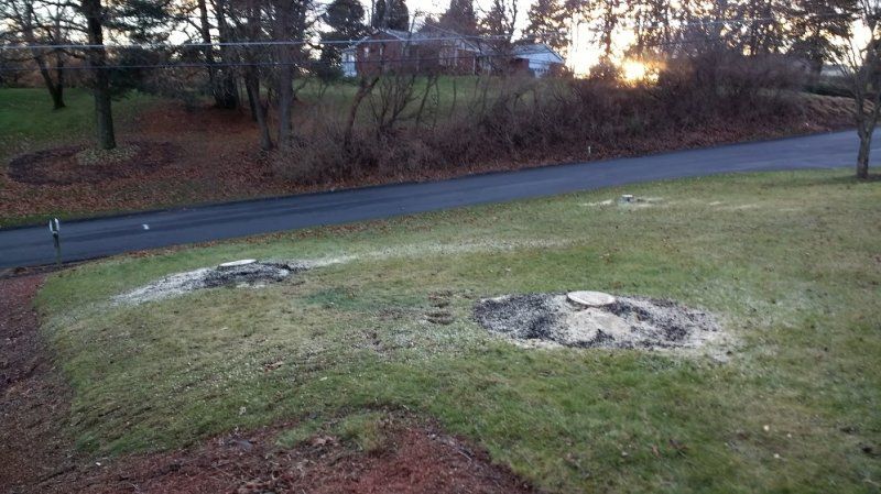

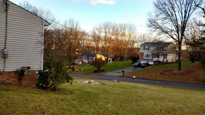

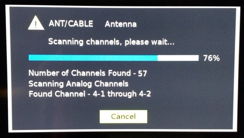

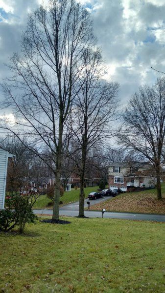

I live near Pittsburgh and usually receive approx. 40 channels OTA using an Antennas Direct DB8e UHF antenna. Some channels like channel 29 (QVC) , 31 (Bounce) and 59 (COZI, MOVIES!, Retro) were always weak and came in occasionally.
This past Tuesday I had two large trees removed from the front yard. Not only will I no longer need to rake leaves, clean the gutters, lay mulch, etc. I now receive over 50 channels and 99% have a 5 green bar signal strength including channels 29, 31 and 59 without adjusting or moving the antenna. I'm sure glad those trees are gone and now I can enjoy all the extra channels.

Worst thing for UHF reception are trees in line of sight with signals. Even worse when the leaves come out in the spring.

A tree that is close to the antenna can make a big difference.
There's a cedar tree alongside of my house that moves in the wind and you can actually see the signal change up and down in time with the movement of the tree on channels in that direction.
Going from 40 channels to 57 is a great improvement!
