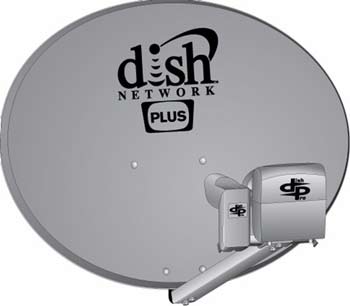

is there any way to tell by going on the menu screen or by going outside and looking at the serial or Manufacture #'s on the dish it self?
It says Plus on it and has 3 transmitters if thats what they are then in the middle of those is a oval shaped glass .
Does it look like this? This is a Dish 500+.

looks like that but with 3 total transmitters the one in the middle and one on each side

The plus series of dishes are designed to receive the 118.7 FSS satellite, and they use a special LNB for that. The 118.7 satellite has international programming, and specific local HD channels. Assuming that you fit into one of those categories, then the Dish 1000+ is the correct solution for you.
