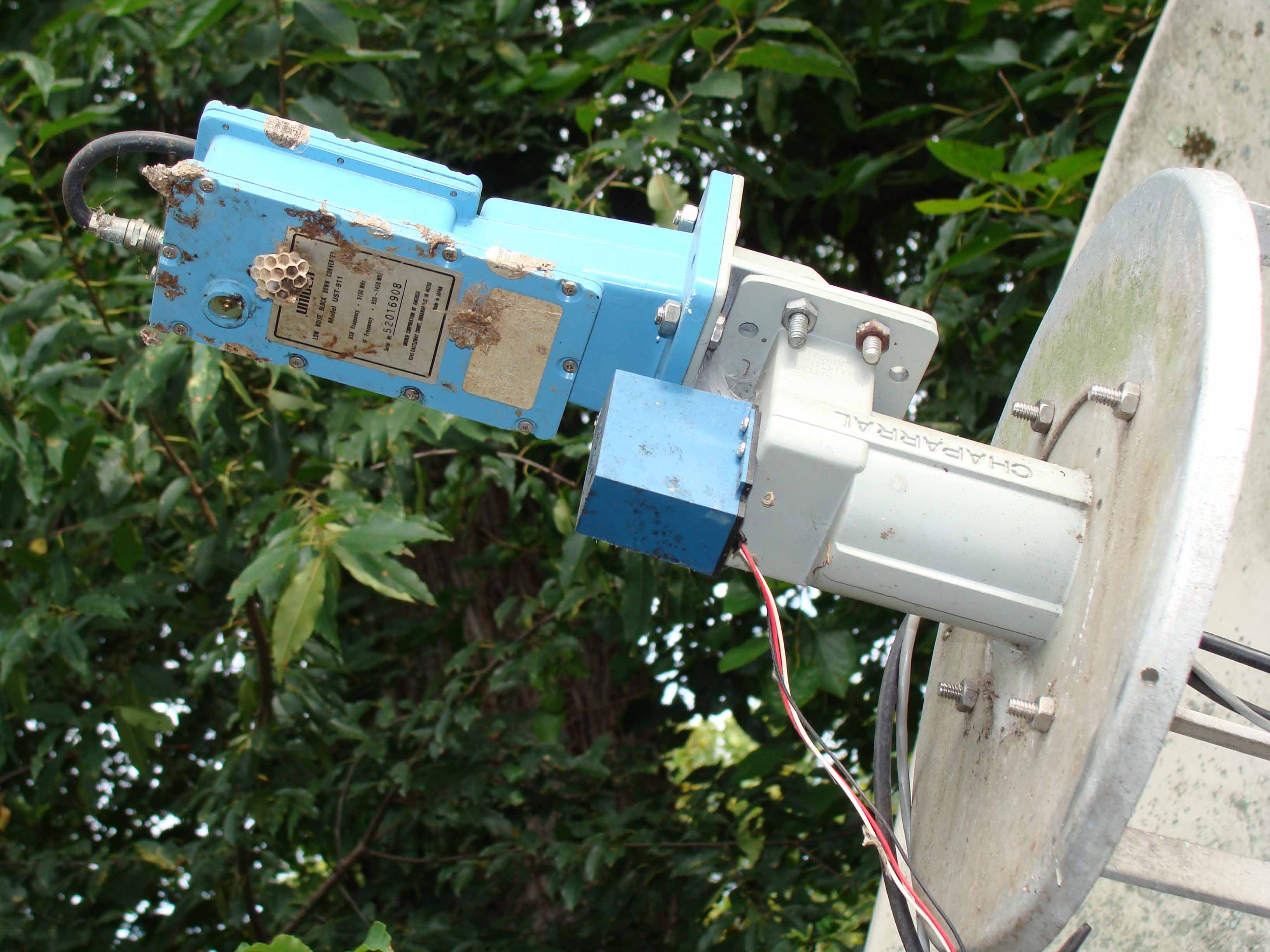

What does the servo do? Is there another way to operate it. I have looked at the lnb, it is a chaparral, and then there is a uniden blue box attached to it, I suspect that is the servo.
If you have an old school Chaparall or other type of feedhorn on the dish (it should have a blue square box (servo) with three wires coming off of it - probably red, black, white.
that little servo motor rotates a probe in the feedhorn to switch between vertical and horizontal positions to receive the signals the dish collected.

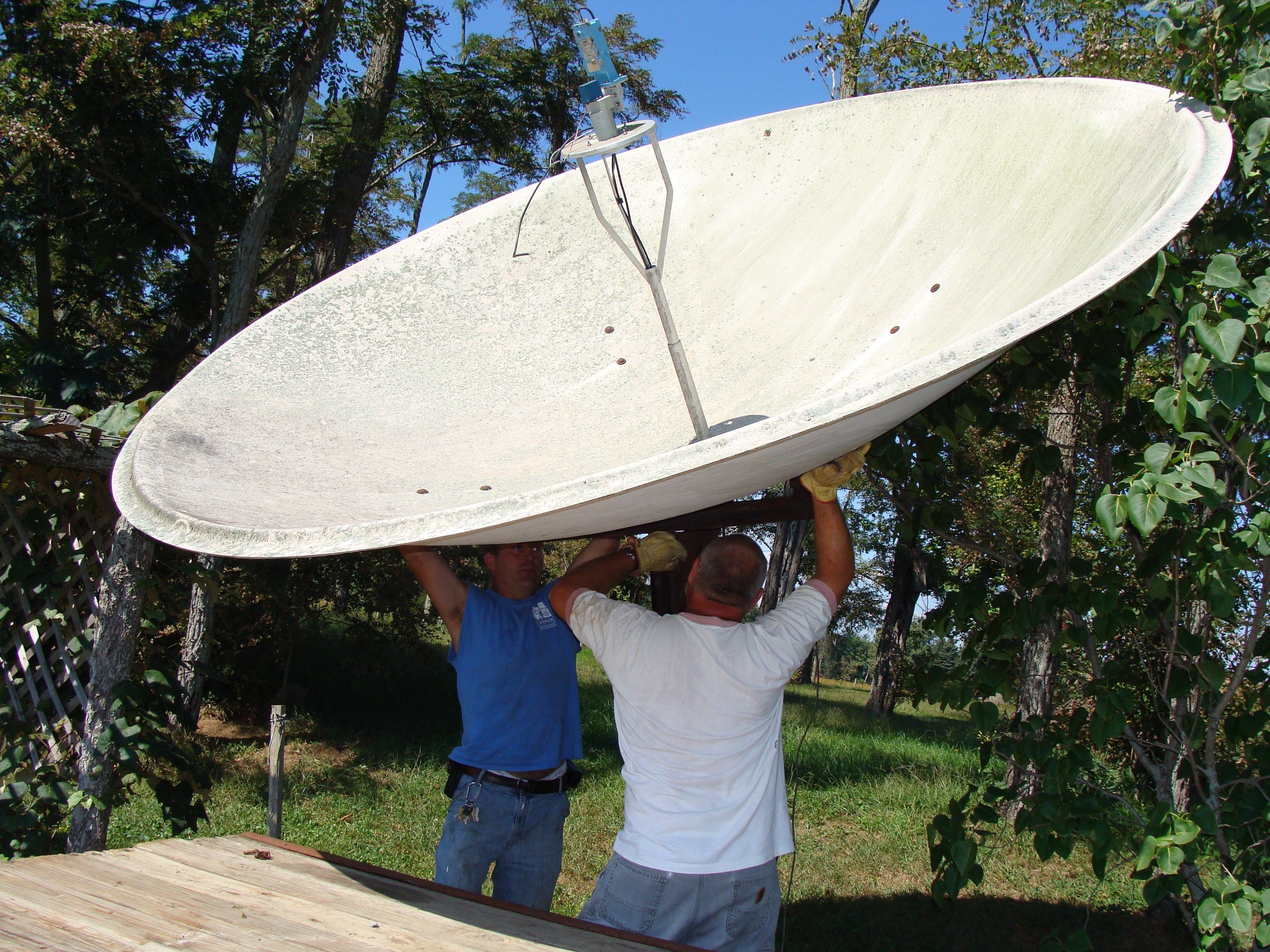

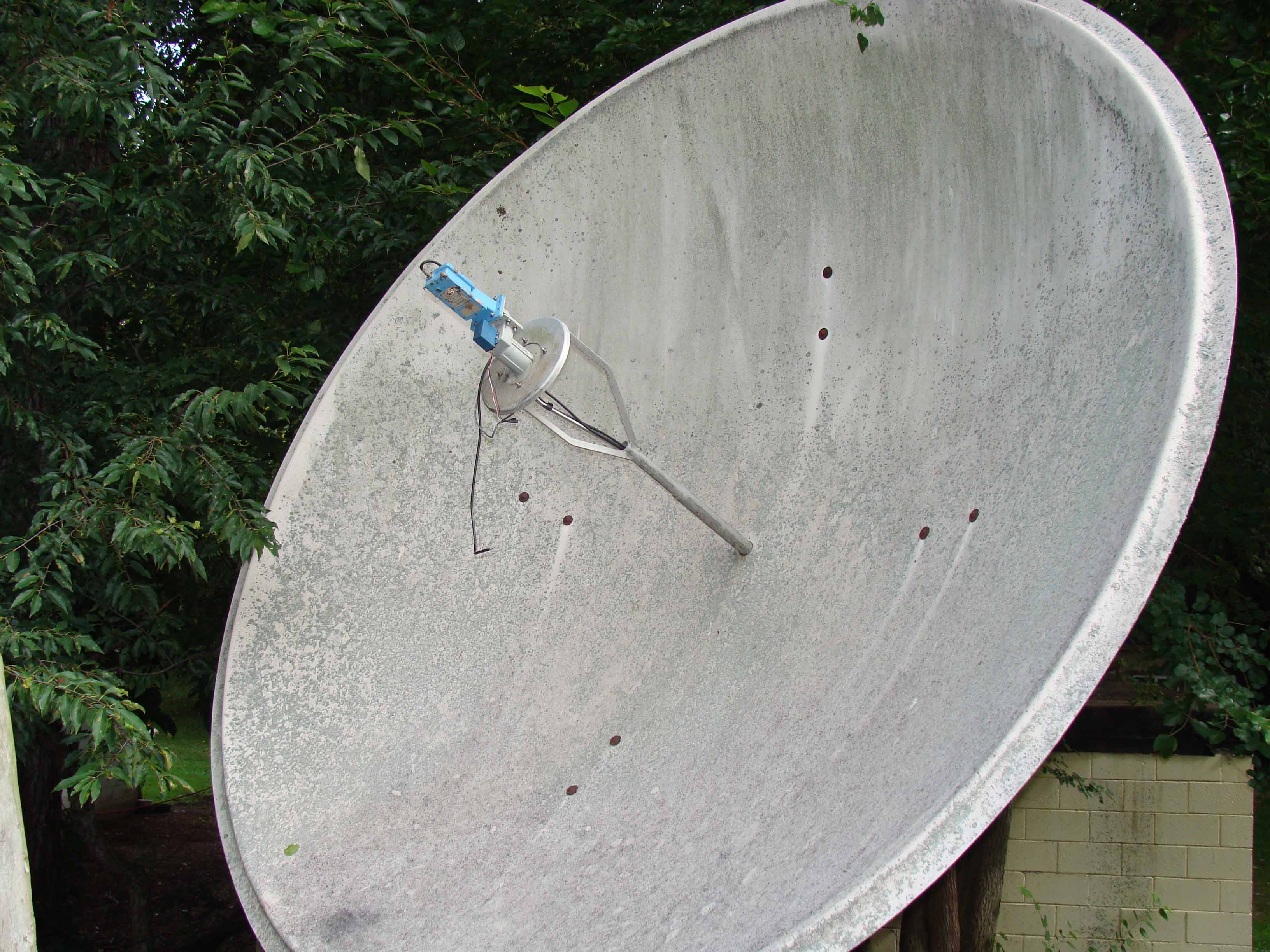

I will take some pics tomorrow and post them. I will have a few days to set the post in the ground, so that will leave me time to sort the motor/servo situation out. Thanks to all, I really appreciate it and I am getting excited about working on this bud! And that brings me to another question. It really is a big ugly dish, covered in algae looking stuff. Will that have any affect on the reception?
probably not but it wouldn't hurt to pressure wash it with some bleach water. and maybe paint it with flat paint. Don't use glossy paint! You could paint it back white or some color that will help blend in with its surroundings.

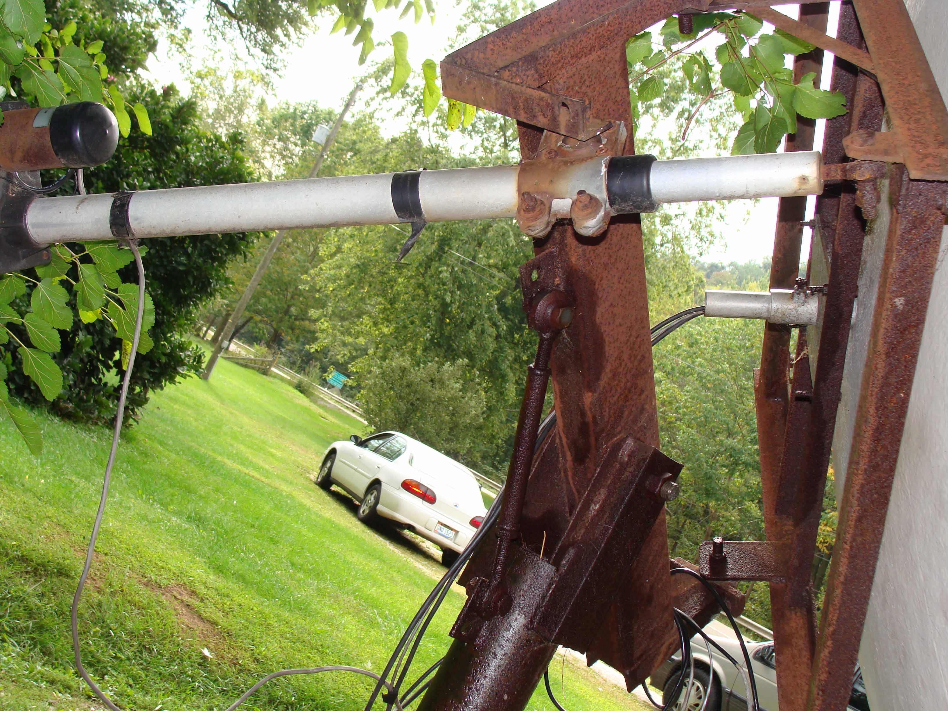

rust:
Getting all the parts to move, and lubricating it is your first concern right now.
But once you have it operating and want to do something about that rust, . . .
... I found that a bit of wire wheel to remove the flaky stuff was good enough.
Then you spray on several coats of rust-bonding primer and/or paint, according to mfgr's specs.
Details in my signature, so I won't repeat, but the stuff really works, looks great when done, and you do -not- need to get off all the rust!
I don't recommend the brand that first springs to mind, so do give a read. :)

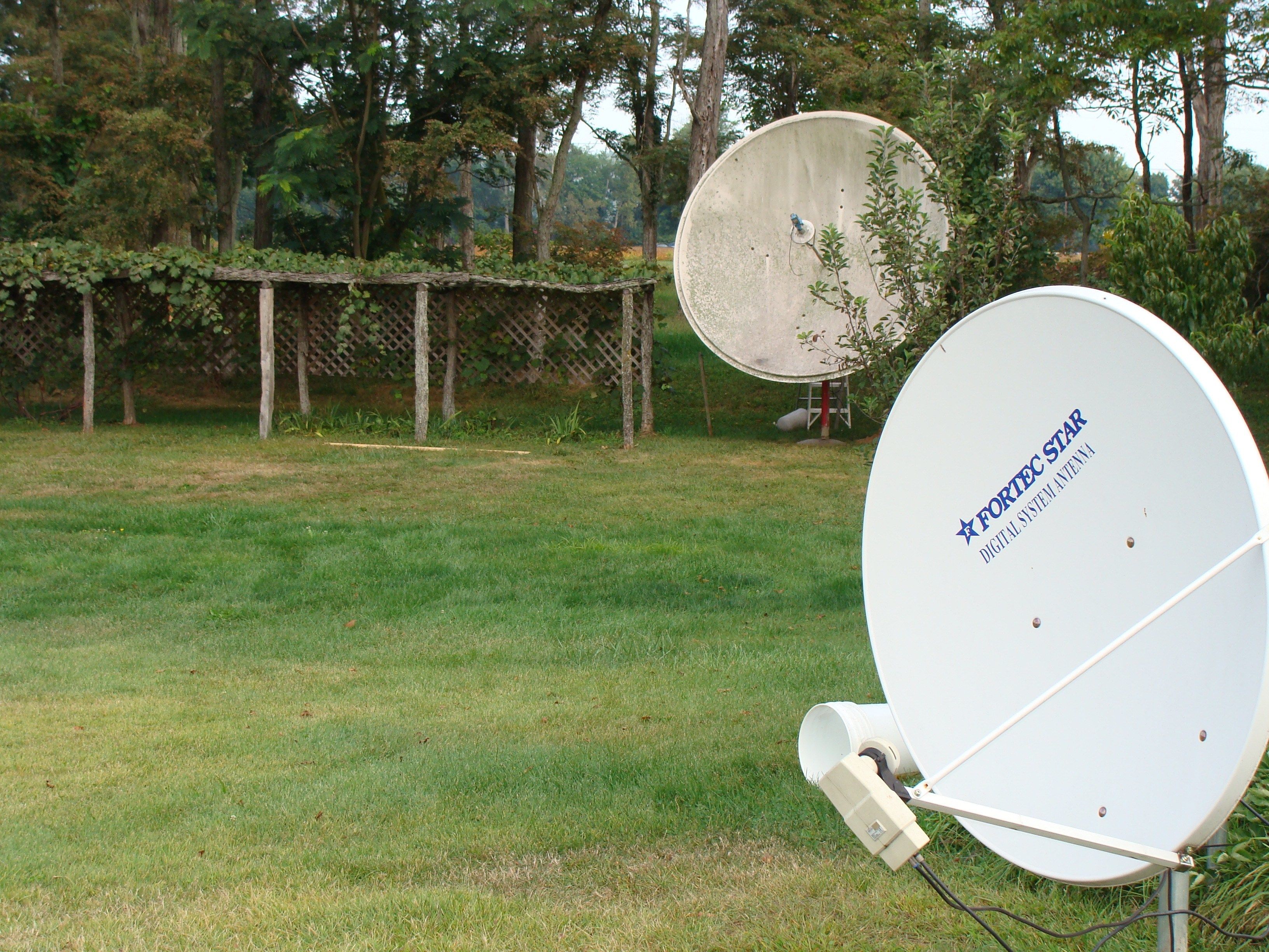

What a beautiful site!
Well, it may not qualify as a dish farm, but it is still beautiful to me!. I can't wait to get things up and running.

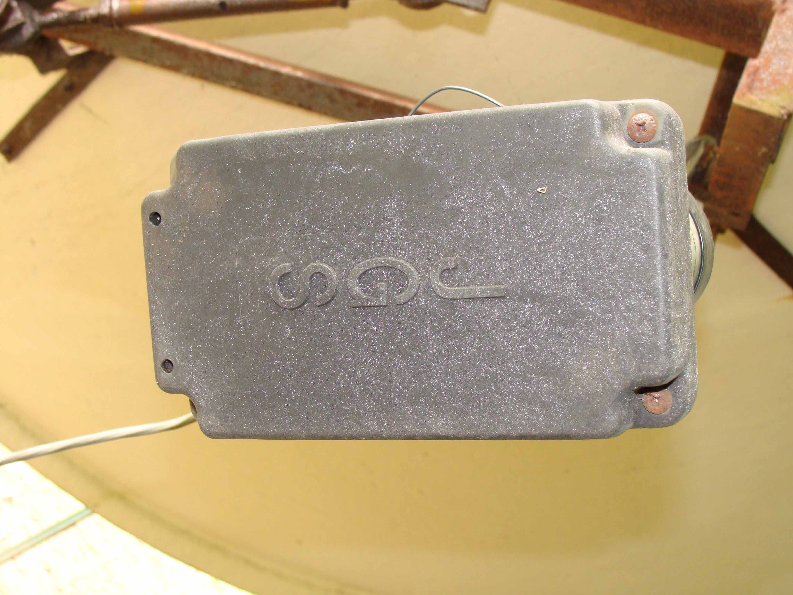

I don't have any way of testing the motor. Everything is pretty rusty. I don't know whether to try to take it apart and clean it up, or just wait till I get a gbox and see what happens? Any advice?
Hi, you might want to simply hook up the two heavy wires (might be green and white) that go into the actuator motor to two car batteries hooked up in series for 24 volts. If the motor is good the actuator should move in one direction. You can reverse the direction by simply flipping the two wires.
BTW - from all the rust I see in the picture I would hose of the end of the actuator with WD-40 and you might even drill a small hole in the body of the actuator about 2/3 of the way up from the motor and stick the small red tube from the WD-40 can in the hole and hose of the inside. Then try to move it. If the motor tries to move then starts to drag stop and reverse the wires. Go back and forward with the motor to free up the actuator. With a little luck it will free up and move full travel. Make sure you do not hold the wires on the batteries if the motor stalls. It will damage it.
If you get it free up you can plug the small hole with a dab of silicone sealant.
I wish you luck. DC

I just reading this post and want to jump in with a comment about cleaning up and painting this solid dish.
I just rescued a nice solid aluminum dish in July. It looks much like this one. On mine, the paint on the dish face has been partially stripped by wind and field dust, etc.. I pressure washed it to strip off as much more as I could and with a little effort, 90% of the dish was bright metal. I was considering leaving it shiny bright but it Blinded me when ever I came within the Focal point. I thought that might cause some problems so went with a new paint job with primer and flat white paint. I thought of flat black but that would and absorbed heat in the oluminum and perhaps warp it if there were tree shadows involved. However, I have to wear sun glasses when I painted it and when I climb on a ladder to adjust the LNB/Corotor. Kinda like "Snow Blind".. I'm not sure what color would be best but right now I have the button hook, scalor and wiring all dialed in and hope I don't have to play with that for a few years.
My experience(s) for what it's worth!
Steve :D
painting shiny dish:
Yea, the only difference between a solid BUD, and a solar cooker, is the paint job! - :eek:
And that flat paint is the way to go, too
Ya might search back a couple of years to where Linuxman started a thread on painting a solid he once had.
You can read his trials first with rattle-cans, and then buying a paint sprayer.
Being a perfectionist, he still wasn't happy.
I thought he did fine, but my standards are much lower. - :cool:
I'm sure you'll find both entertainment and good experience in the thread. ! - :D
As for color, I personally favor somewhere between an off-white (maybe 'sand') to a light charcoal.
But, that's just personal taste.
The two in my signature sorta fit those colors. - :rolleyes:
Solar Cooker or Death Ray?
I thought that if an airplane few within the focal distance it might blind him. Then on thinking that one further, he would have to be at Focal Distance and that would be 40.32 inches. Kinda low.:eek:
Well! Heck! there goes my plans for my own Buck Rogers "Death Ray";)
I think the only person to ever get hurt by a shiny or bright white solid would be the guy painting or on a ladder adjusting his LNB. That would be ME!:p
