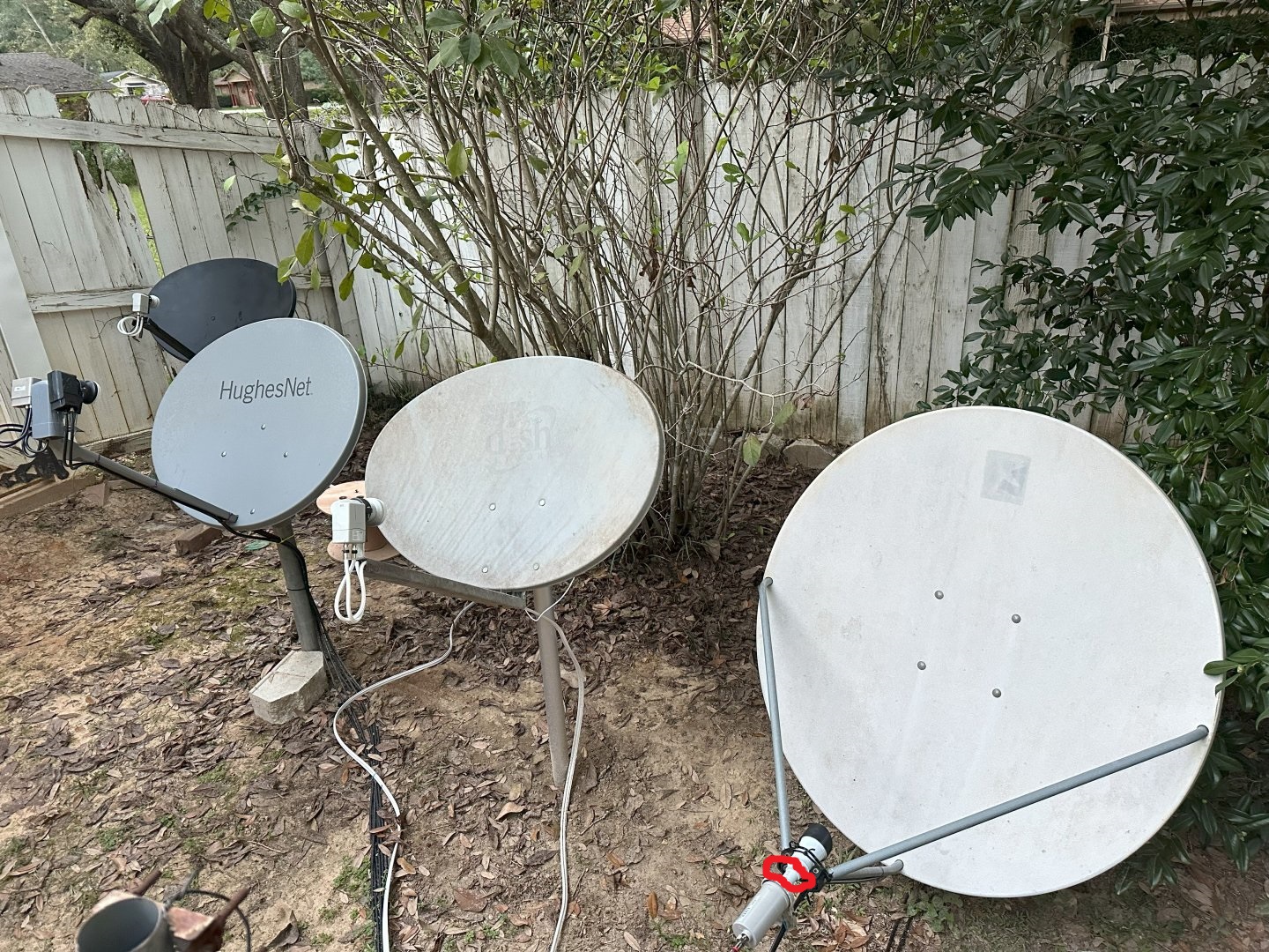

I have a ChannelMaster 3040842-02 1.0M-02 (the huge round one - 43 inches high by 40 inches wide). Using the stock feedhorn and a new dual-feed standard LNB. I've tried it on 97W, 99W, and 103W.
This dish is giving me fits. Pointed at the same satellite, a SuperDish (24 inches high by 33.5 inches wide) will consistently provide higher signal levels (around 20-25% more) than the ChannelMaster. I would think, all other things being equal, my signal with this big dish should be a lot better than what I am getting, and certainly should be a lot more than what I can get with a smaller dish.
I've checked everything I can think of. No obstructions, good cables, good LNB that works just fine when attached to a different dish. As far as I can tell, it's not bent or warped (how could it be, molded fiberglass would more likely be cracked and broken than bent)
Before I pull the rest of my hair out, any suggestions?

ChannelMaster (right) gets consistently lower signal than the SuperDish right next to it.
Ok, LOOK at the lnb feed. You have it strapped by the feedhorn, YET, it should be strapped closer to the lnb where the GROOVES are... So, move the face of it closer to the dish, and put the groove area in the saddle. I circled it in red below
Reactions: comfortably_numb
I do believe I have tried that and the position in that photo is where it gets the best signal. It's also where it actually fits. The top piece to hold it in place has always been missing, thus the zip-ties, but it fits exactly in that spot based on the size of the bottom piece which it sits on.
I will definitely fiddle with it some more though. I will also disassemble it all and take some better close-up pictures from multiple angles.

Thanks for that. According to Figure 3.0 "Feed Assembly" it looks like I have it assembled correctly. Parts 11, 12, 13 are missing, replaced with zip-ties ;)
I'm thinking the wireties aren't enough support for that long and heavy feed, That's maybe allowing the whole thing to tilt slightly down in the back from the weight, which would screw with the focal point/face lifting slightly. Even just a hair might be enough to put the signal down 25%.
Get a piece of aluminum strapping, and make a new top part of the clamp, and clamp it down tight. Aluminum should be stronger, yet soft enough to hacksaw and files, etc whatever you need to make it work well. Or a U clamp that fits. Short of that, you could use a piece of plywood and cut it to fit the reverse of the saddle using a hole saw with your drill.

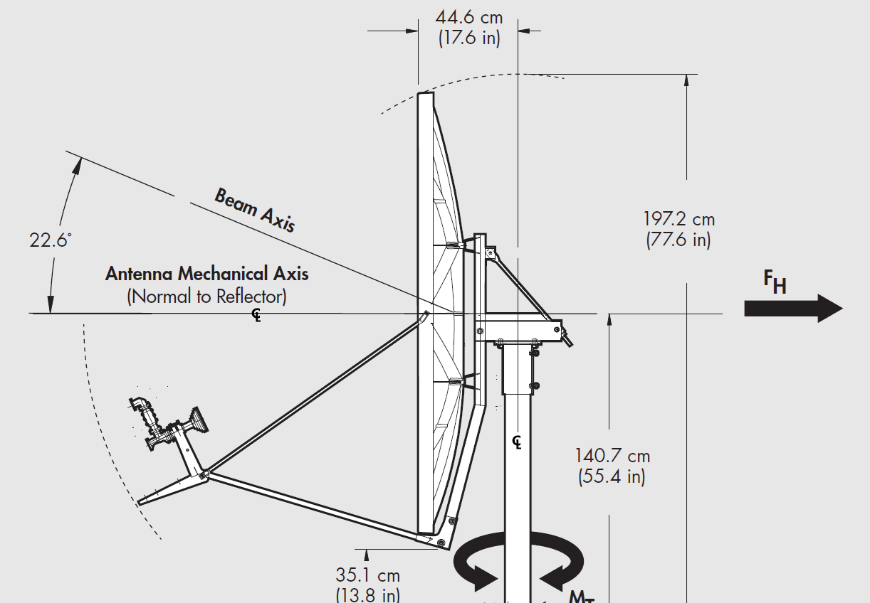

Is it always 22.6 degrees, is that part of the math that makes these things work, or is the exact angle determined by the shape and size of the particular dish? None of my other more oval style dishes seem to be anywhere near that much of an angle.
Skew is not an option with this dish design, other than twisting the LNB. Elevation and azimuth is all it can handle. I suspect my issue has a lot to do with weight as primestar31 suggested and getting it mounted exactly right and tight enough to stay there. I'm also going to disassemble the thing and clean it, maybe some bugs have got in there and built a nest or something.
That 22.6 is typical for the Channel Master offset dishes. Other dishes may have other offset angles.
Is the vertical angle of your dish face indeed: Satellite elevation minus 22.6 offset angle now?
When the feedhorn is at the focal point, you should have reception at that elevation
RimaNTSS has put the CM offset dishes geometry in this picture:
Personally, I would aim a bit higher than the G-spot in the picture: at the deepest point.
But having the feedhorn at the focal point is more important than using an exact aiming point, if I'm informed correctly.

Look. The CM/Andrews/Raven dishes are basically the same animal. No need to dive deep, just accept that the look angle is 22.6 degrees. If you're a tenth or so off either way. No biggie.
Is that thing flopped on the ground and propped up with your brother's boots? Let's see the back of it.
Does it even have a mounting plate and pole mount bolted to the back?
